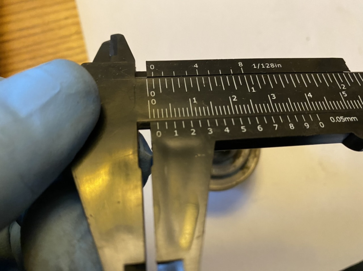

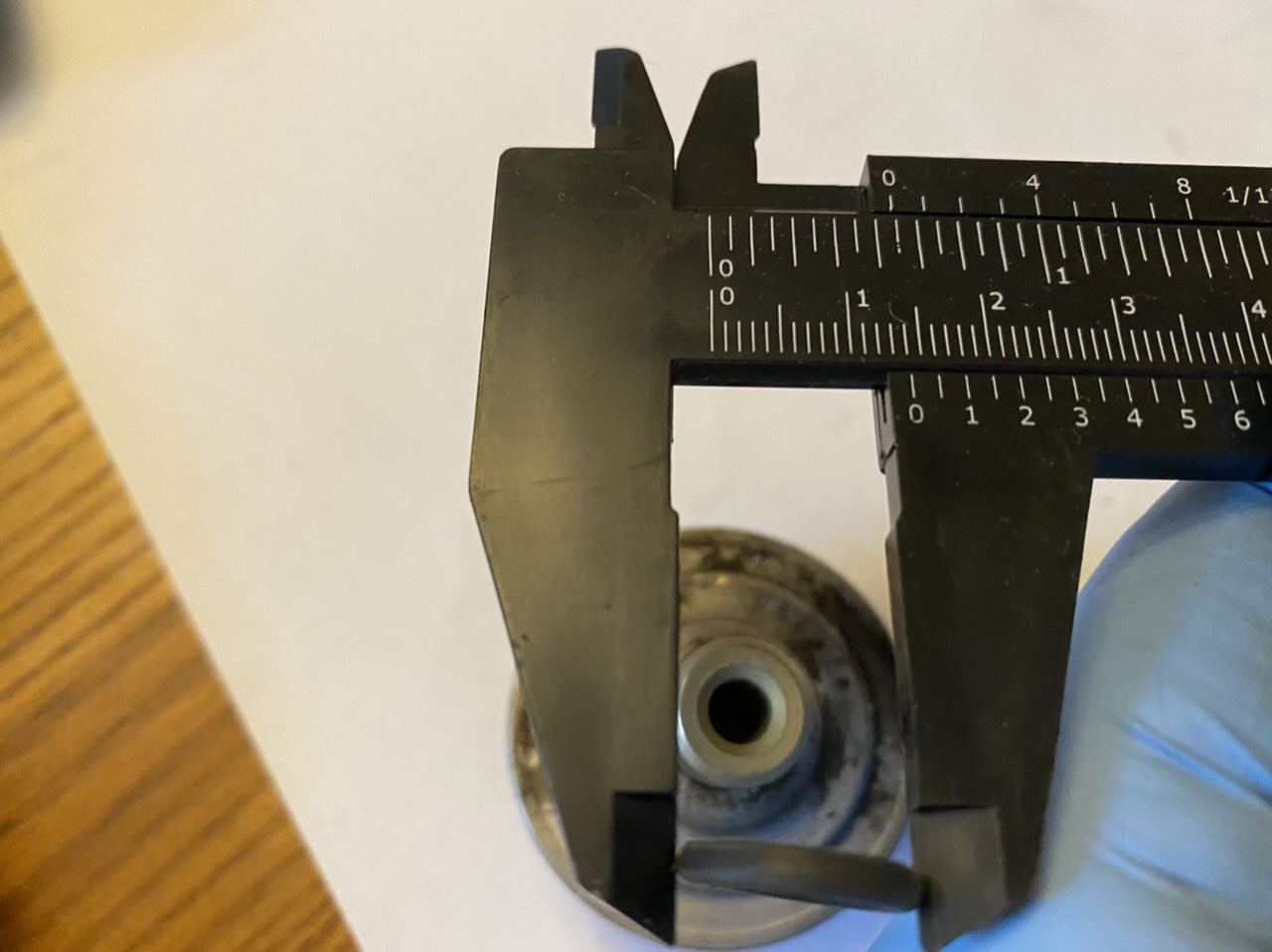

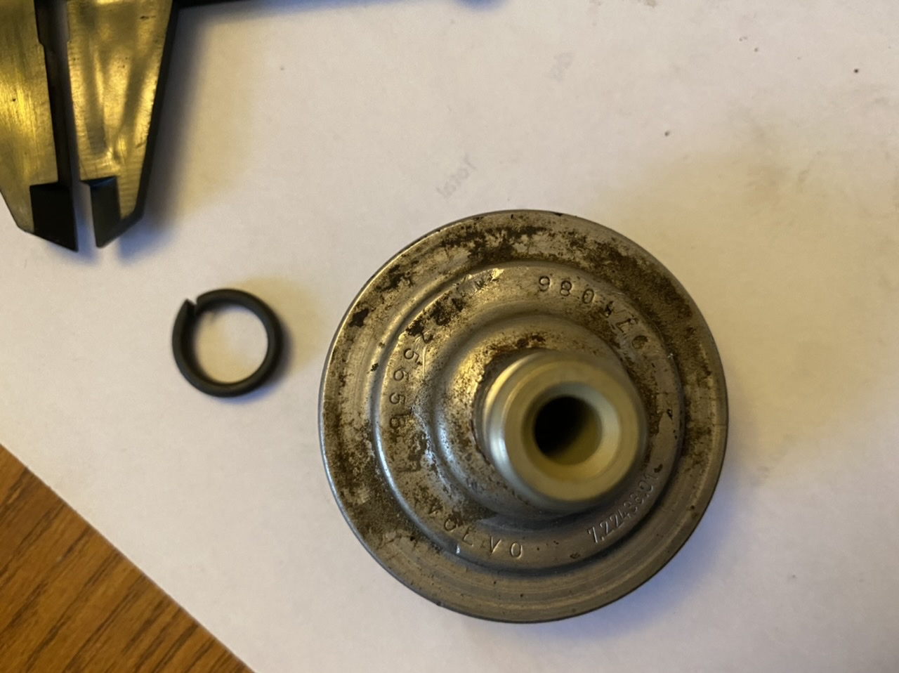

14x2 mm is what I measured.
It broke coming off, too
Misha. The bore for the damper looks identical to the fuel injector bores. I bet they use the same o rings

I recall the injector o-rings being thicker than that. Closer to 3mm.abscate wrote: 13 Jan 2022, 10:45 14x2 mm is what I measured.

Outer diameter is the same like injector's o-ring...but inner diameter is different.abscate wrote: 13 Jan 2022, 10:45 14x2 mm is what I measured.
O-ring for FPD is also thinner.
You can see that on the picture from the link from MVS member which i added in my 1st post of this topic.
Doesn't matter...i'll just grab a used damper ...there is one parts car with M4.4 management in my neighbourhood.
I'm surprised that Volvo wants to sell you 50-80€ damper because of a 1-2€ o-ring which can be easily replaced...just like injector ones.
Thanks guys.
