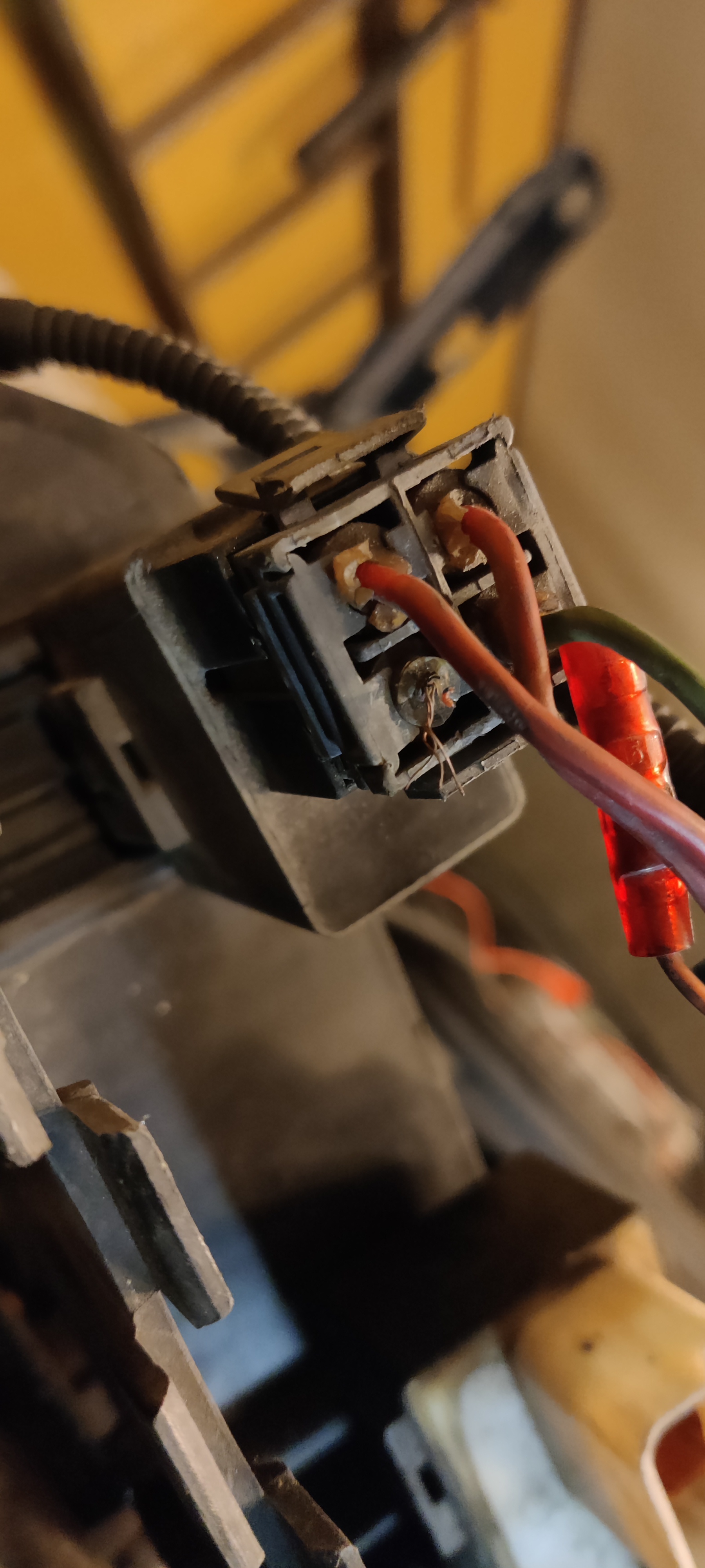

And to update further, I went to check the engine block for any vacant holes to run a ground to. Well I noticed something while disconnecting plugs.
Thats the engine management system relay, yes? The grey one above the fan. Previous owner did a not so great fix for that wire, so I went and got a better plug with all 4 attached and sealed, and I spliced them to the harness.
Some success! The diagnostic unit is working as intended, I havent checked fuel or spark seperately but it didnt spin endlessly now. It starts to sputter and thats when its time to shut off and wait for my friend and we can continue working out the kinks.

Yeah, that's the main FI relay. That'll definitely cause it to not run.

Turbojeppe wrote: 01 Apr 2022, 19:30 And to update further, I went to check the engine block for any vacant holes to run a ground to. Well I noticed something while disconnecting plugs.
The thread will live on until my friend drives away from here with the 850!
That's main fuel injection relay...it powers the injectors,iac valve....etc.
