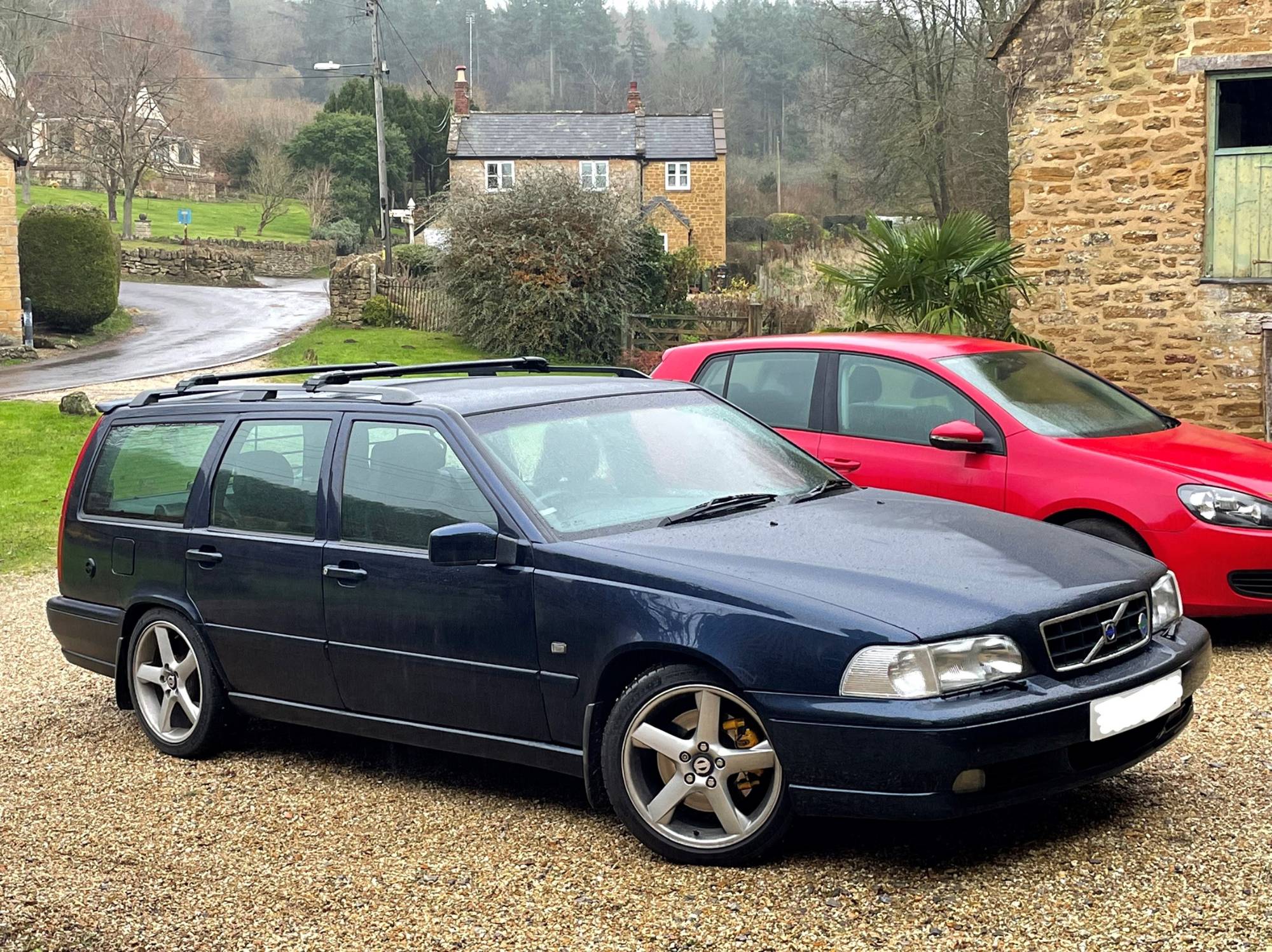

Thanks for the follow up. Now for the important stuff - is your 1999 T5 in Nautic Blue?

It absolutely is! :D
Is that your favourite colour? I might have to make sure I get that picture in Dudley if it is!
