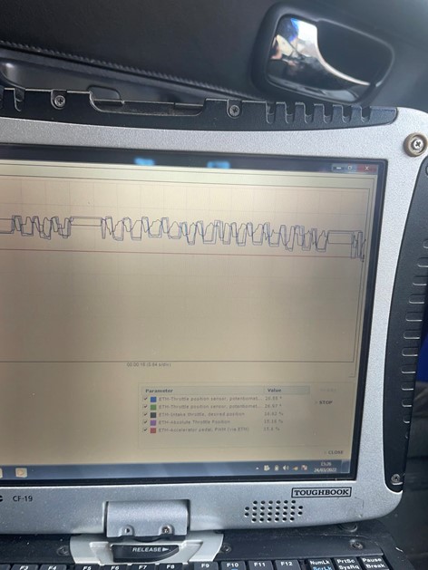

I have been battling my problematic ETM (I think) for a while now, and I could really do with some advice. Below I have tried to list out as much as I can about the problems I am facing and what steps I have taken to resolve them. I have a couple more tests to do (listed below) when I get back to my parents where the car is being stored. Can anyone help me make an informed decision on what to do next?

  • Held throttle in FIXED POSITION against a block and created the attached graph.
Note - see throttle desired position fluctuating despite pedal being in one position
Note - both throttle position potentiometers seem relatively close to each other to me?

I have replaced my ETM now with a brand new unit from Volvo - however, much to my and the volvo dealership surprise, the car drove wonderfully WITHOUT software! What?! The car wouldnt connect to their new VIDA system but the car runs perfect without software loaded onto the ETM, even cruise control works. No idea what is going on!
