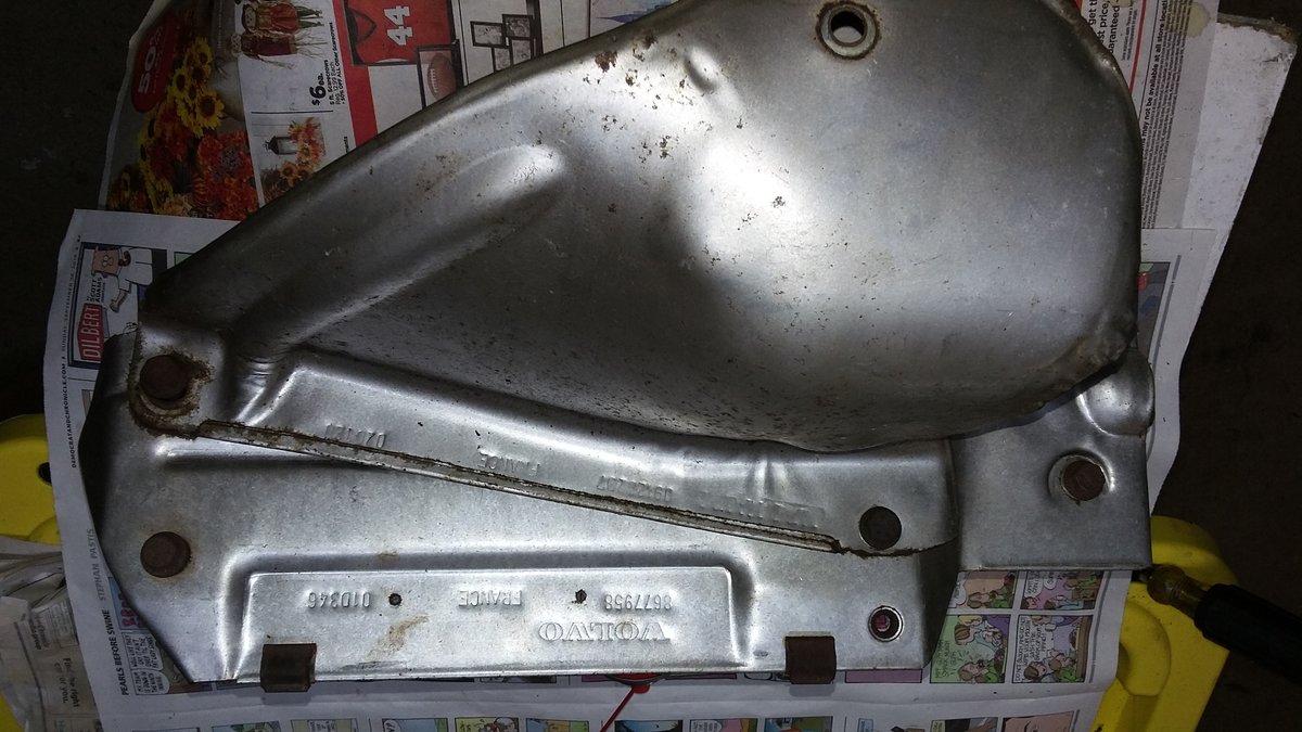

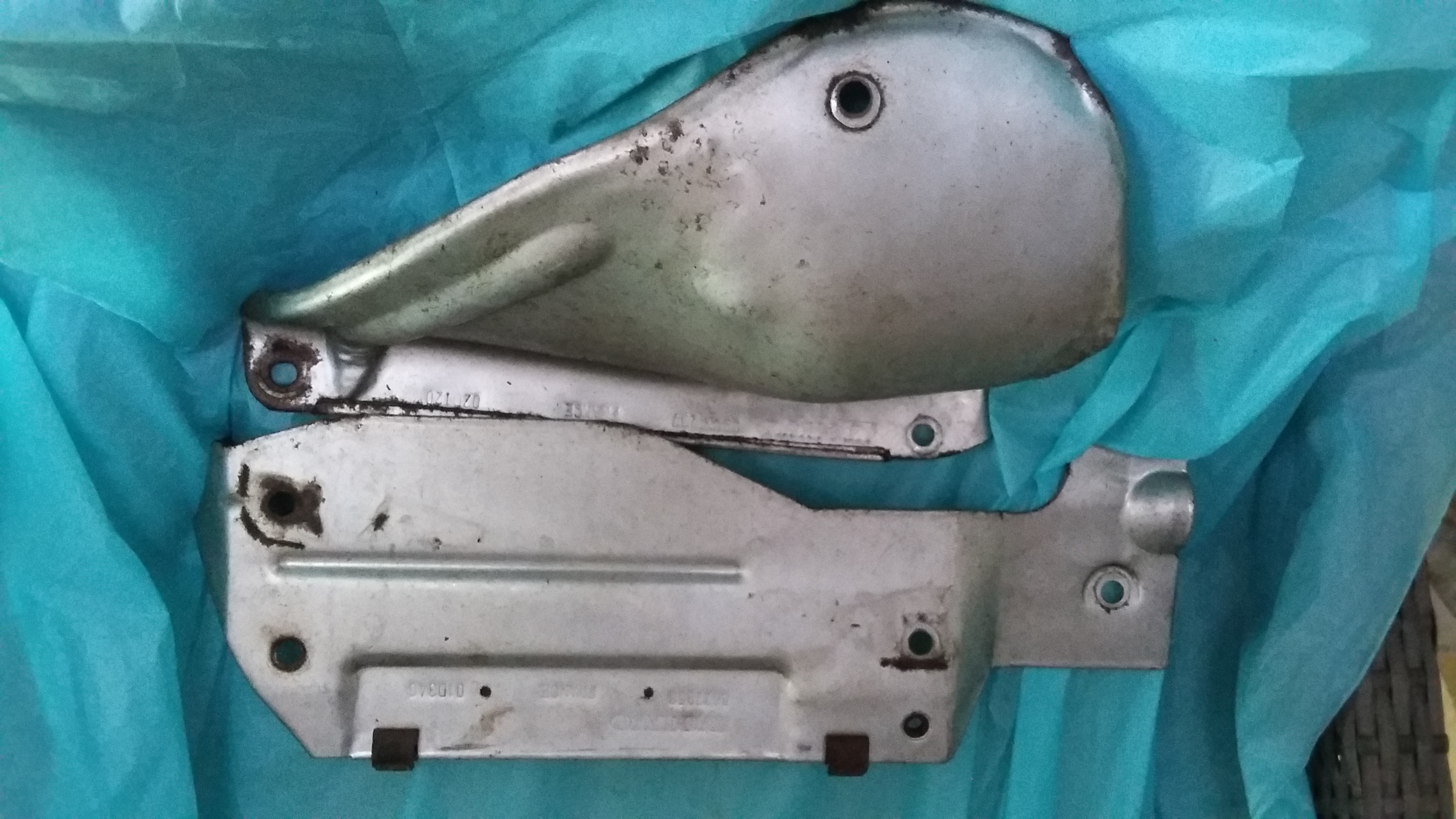

So the pipe from the Air Box to the Turbo and all the Vacuum lines, Brackets for top engine mount , Coils,all wired....
Now im trying to figure out the 2 part Heat Shield? I dont Remember How I got it Off.... been out there for and hour, until it started raining again...
Anyone Know,Remember , have information?
Thanks guy's

Plastic one on top or metal one over exhaust?
mrjay62
Posts: 217
Joined: 14 May 2014, 07:45
Year and Model: V70XC 2002
Location: Plamyar Ny
Been thanked: 3 times
Post by mrjay62 »
The 2 metal pieces over the manifold.

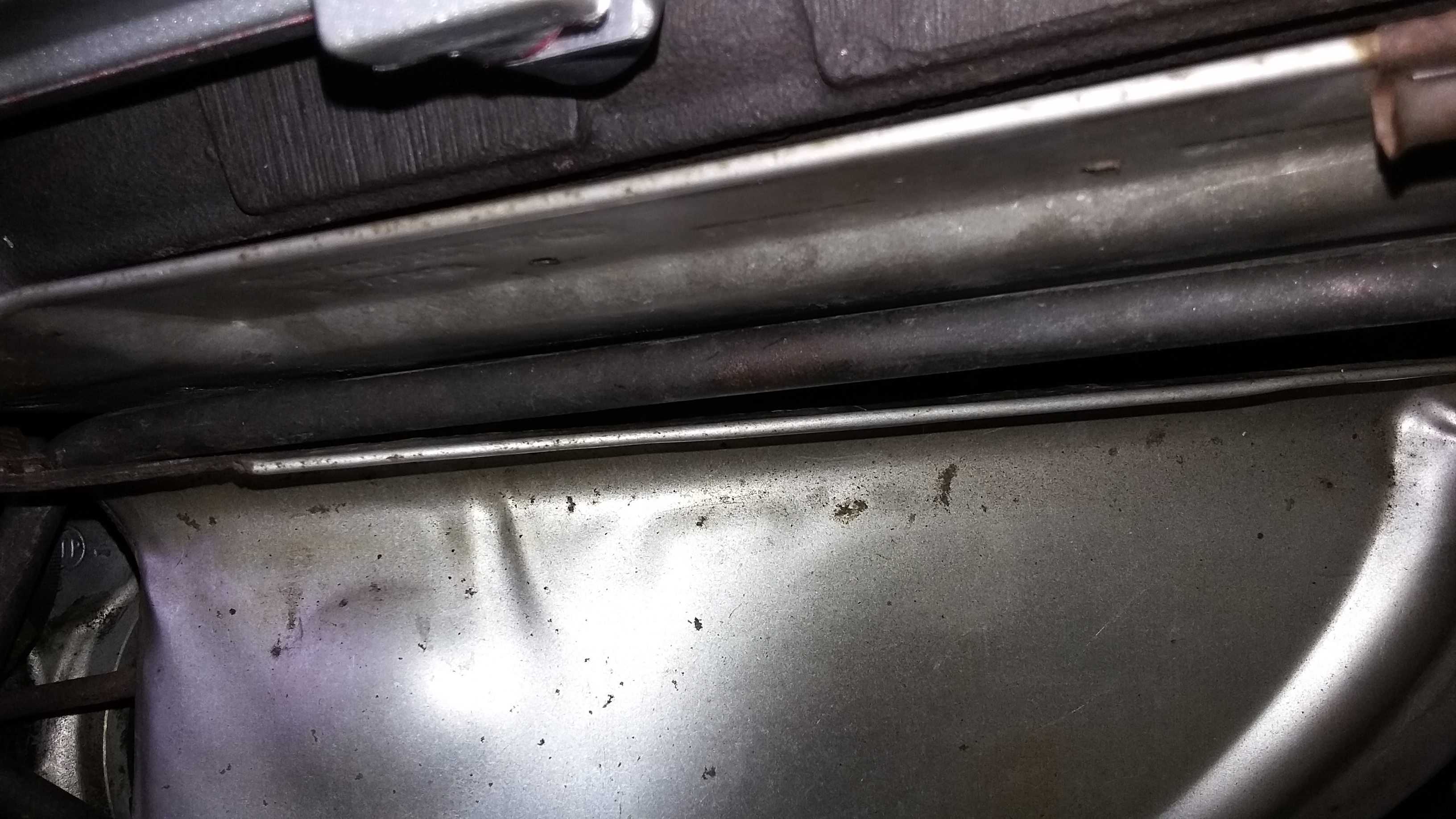

This is how I believe it goes....
But there a coolant pipe in the way...
Unless I some how bent that coolant line?? Thought I was careful. .. but it could happen..
Not enough room to slide it under and match up the holes.
Grrrrr getting rained now I'm a wetback....
