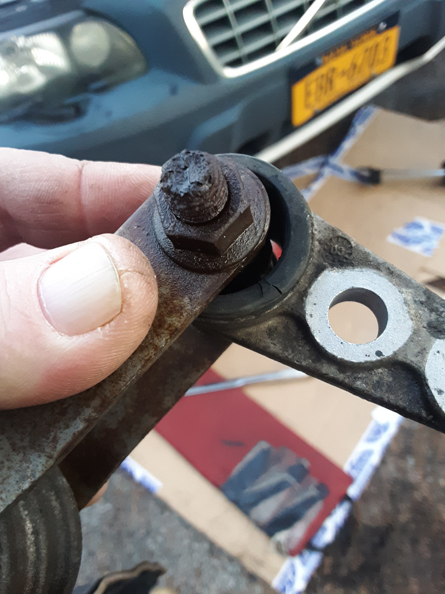

To start I replaced the Lower Torque Mount/Transmission Mount.
Torque mount bushing was totally gone.

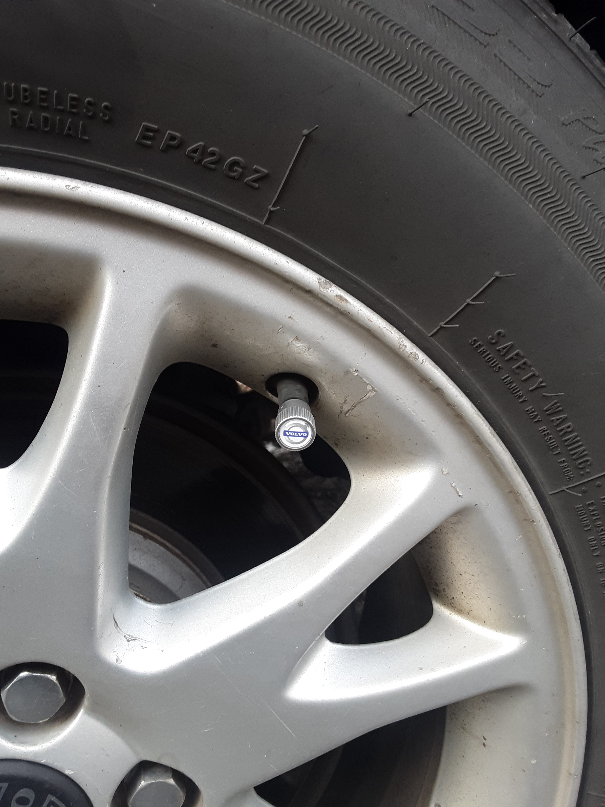

New Factory Volvo tire valve caps
Next I installed the Volvo tire valve caps.

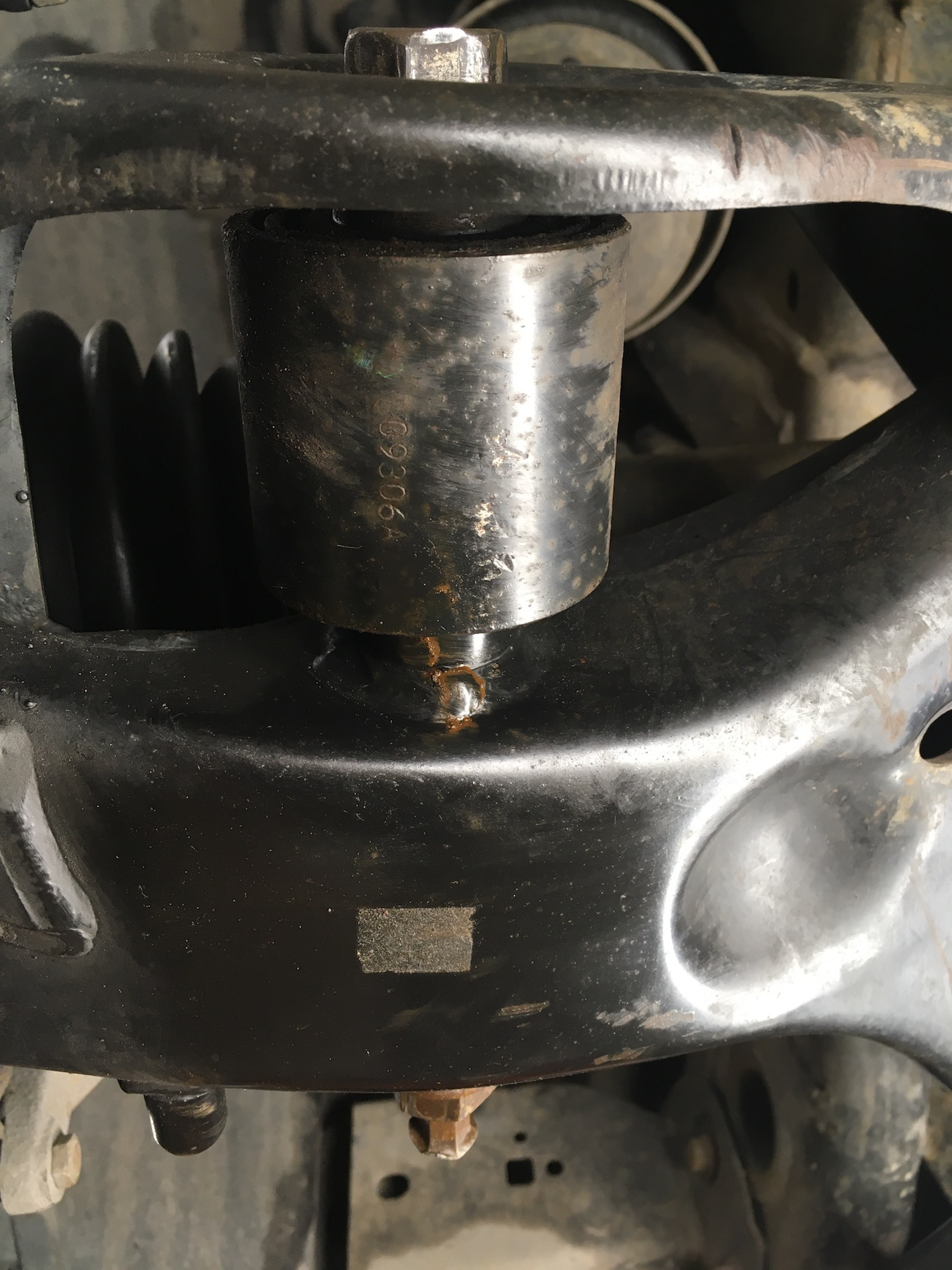

My son and I did this yesterday....but not on a Volvo, sorry.... Broke the rules!
Land Rover LR3. Leaking RF air strut. 9 1/2" bolt through the lower control arm was completely fused to the bushing sleeve. We impact gunned, sledge hammered, PB Blasted, soaked, torched, pounded......no movement, the bushing just twists.
So I rented a sawzall and got these fantastic Diablo EXTREME STEEL (!!) cutting blades. We buzzed the sleeve and bolt from the underside, cutting up.
We pounded on it until it mushroomed. The treads start way back on the bolt, so you can't hammer on the nut.
grrrrr...

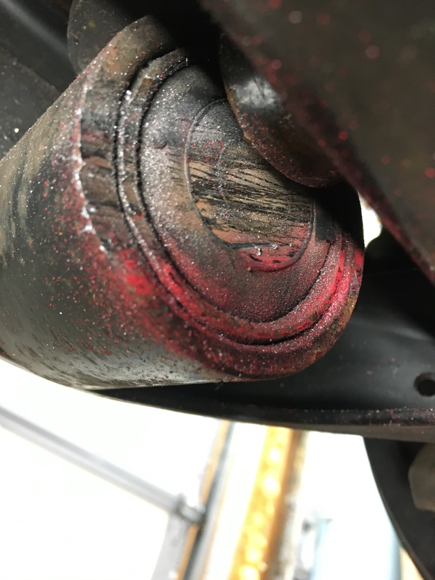

I didn't want to bugger his control arm's machined bosses, so I held tight to the strut bottom and cut through the bushing sleeve and bolt.

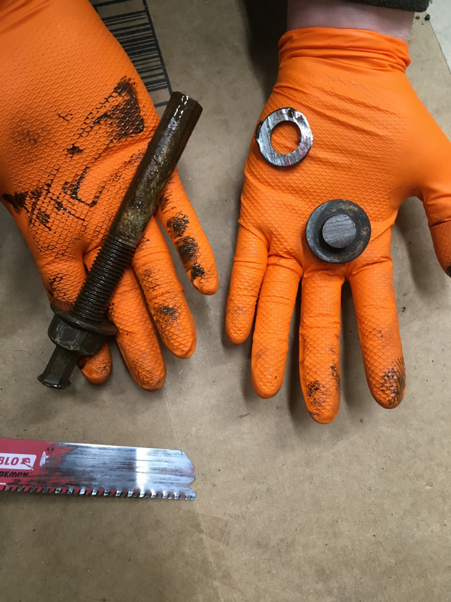

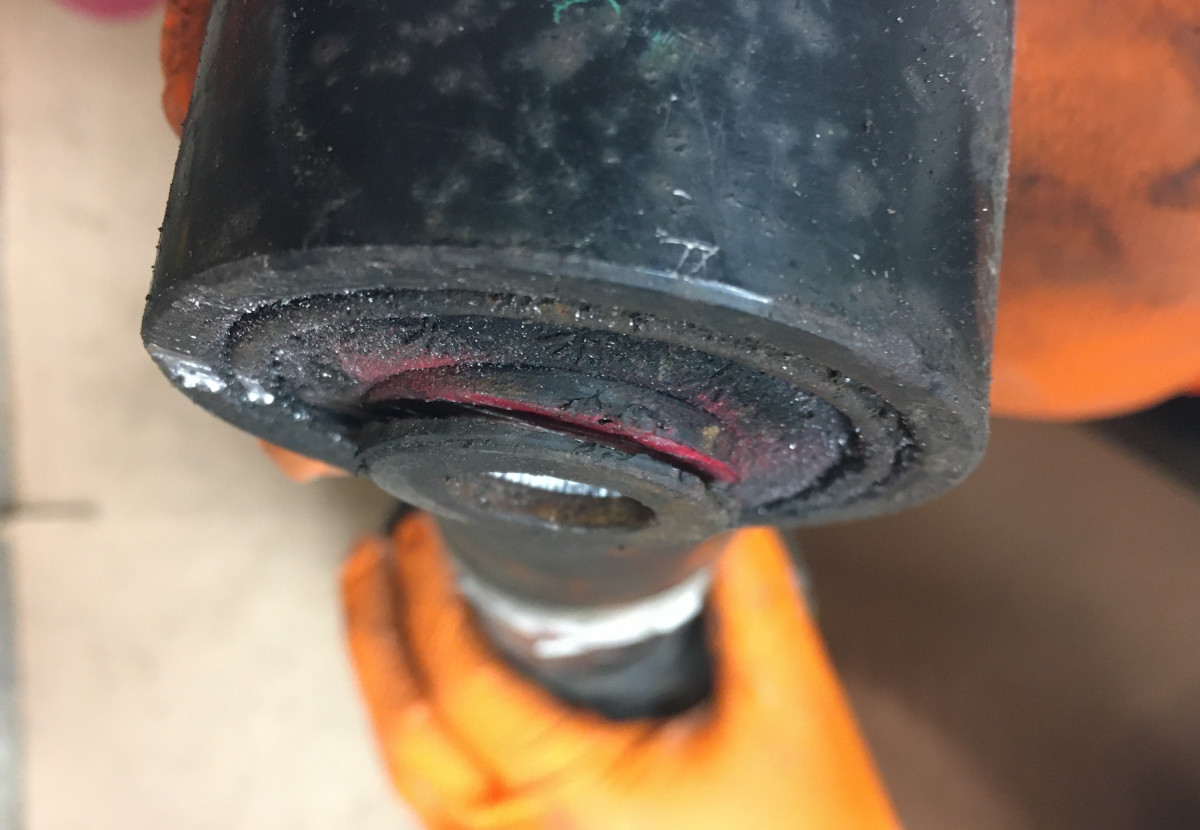

Thin sliced lunch meat...
New bolt and oval lock nut, tightened to 184 ft-lb with an impact. BUTTERED with anti-seize! It's all back together and sitting nice and level.
