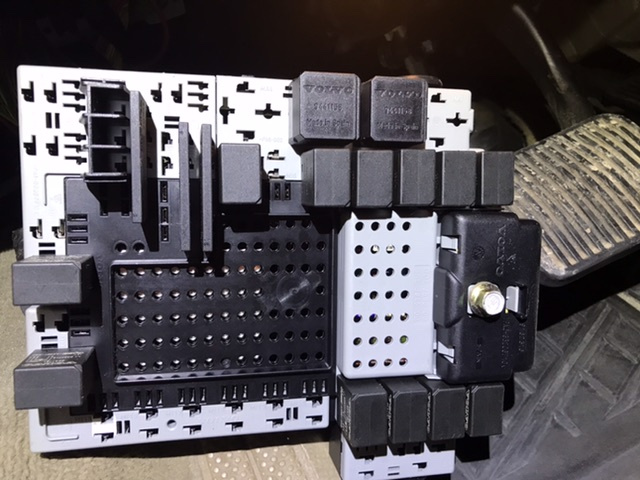

I managed to rinse and repeat my taillights going out again, fixed again by removing Fuse 5 from the REM and scraping terminals with knife. This crops up every two years. Very strange.

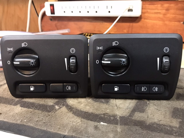

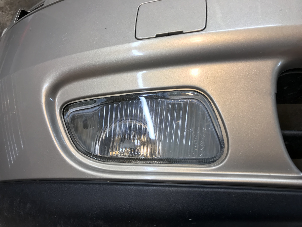

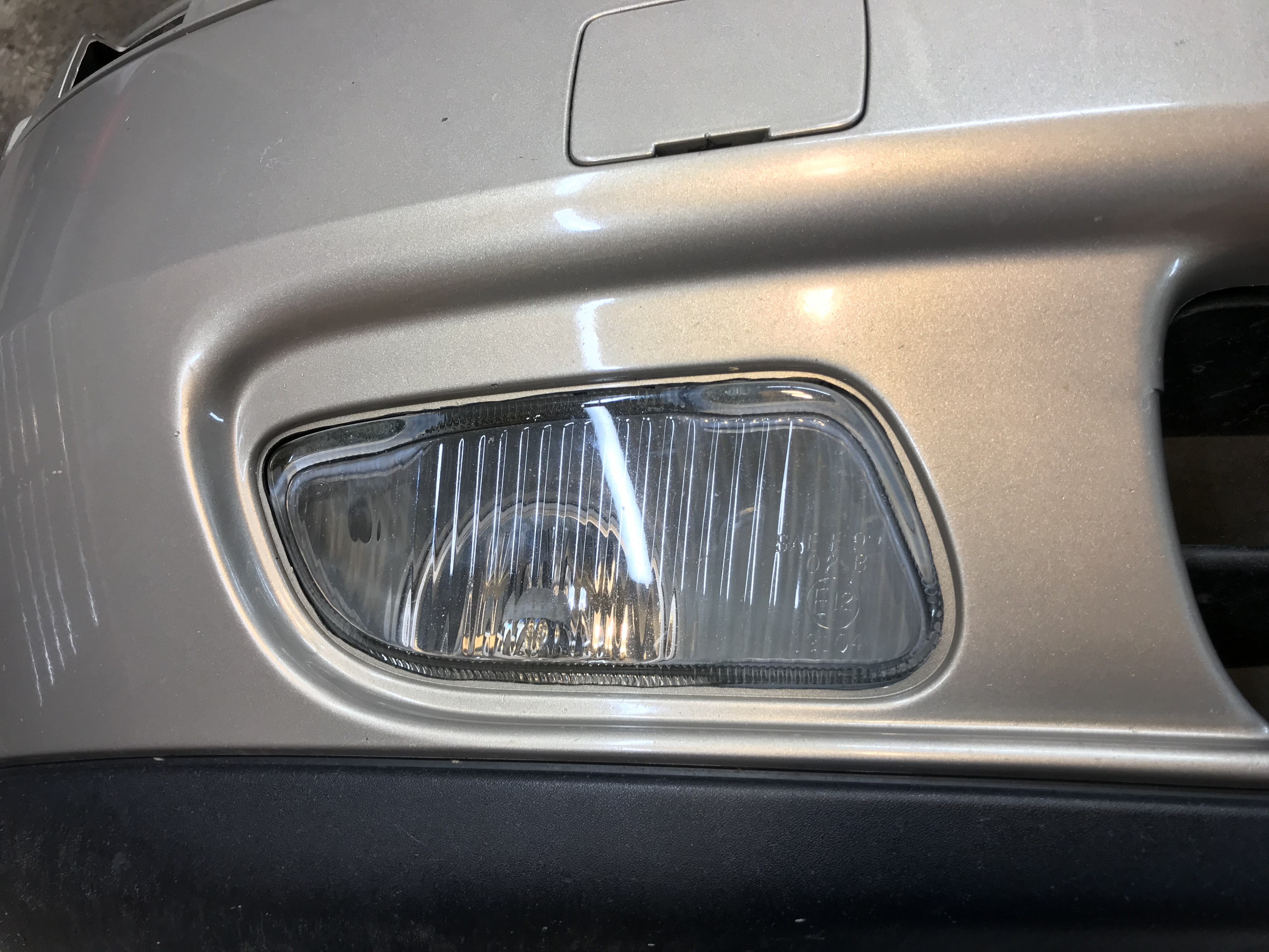

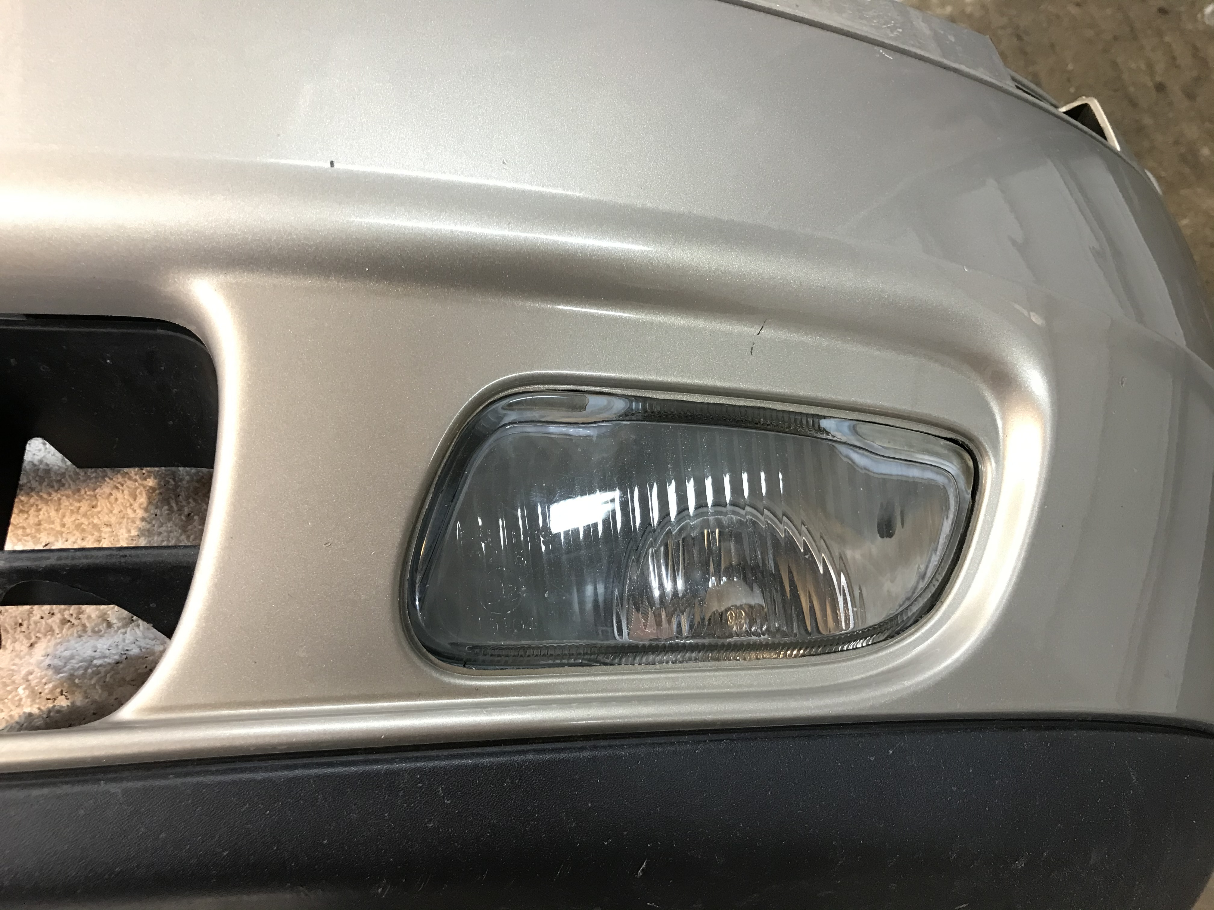

Did some lighting tasks over here as well.

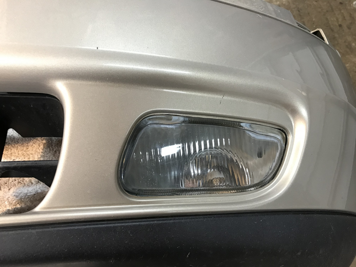

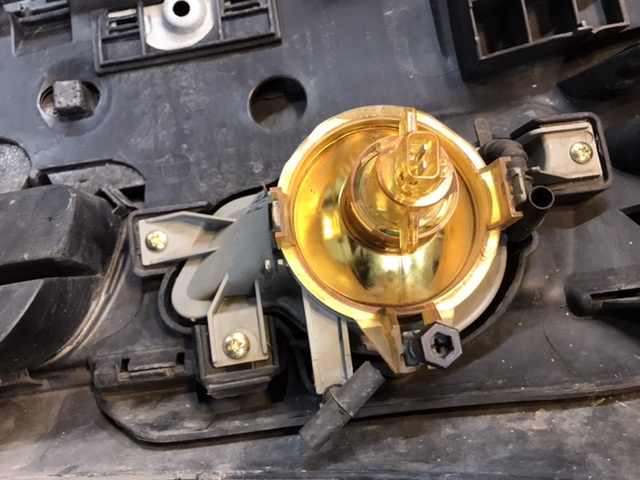

I cut some holes in the V70 front bumper the other day. It just seemed like it needed it.
Then I decided I didn’t like them anymore. These filled the holes nicely.

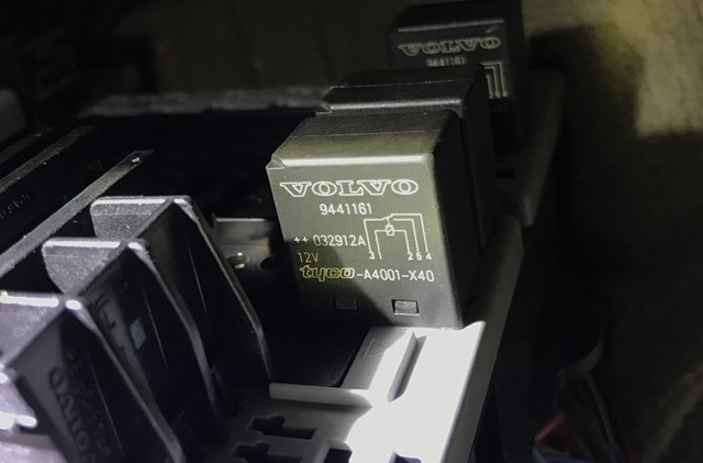

Couple other things I monkeyed with too to get things up and running. NONE of this would have been possible without the finalizing touches from Yagger! Thank you so much Sergey!

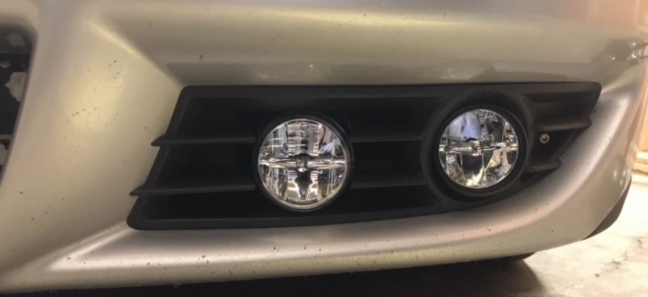

Final product = functional fogs + can use with brights/high beams. Dealer price on these was $285 light kit + $115 for programming. I got my lights off eBay UK & paid Yagger to remote configure CEM, total of 1/3 the cost.
Very nice of Volvo to pre-wire these cars for fog lights.
Also did dual fog light setup on V70R w/PIAA LP270’s.
