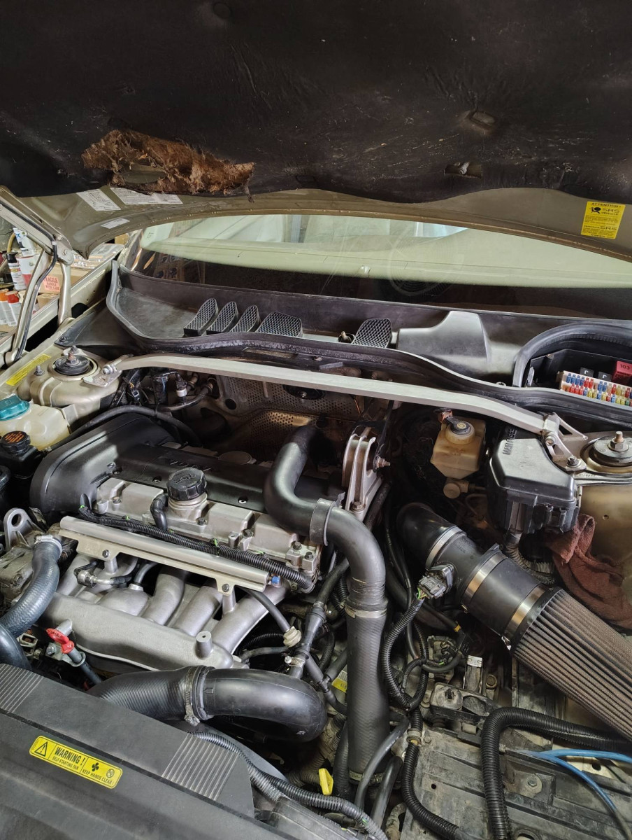

And SHE RUNS !!!
I didn't add the oil till just before I went to start it, so that maybe the waterfall effect of the oil draining down to the pan might help.
Cranked it a bit with the fuel relay pulled. Then installed the relay, and after some cranking ..Bingo !
The good - No check engine light.
Idles fine.
The bad - The headlights/taillights are always on no mater what I do with the switch. The drivers side headlight is out.
Water leak from the water pump area. I'm wondering if my not buying new bolts for it, and just resealing the old ones, is now coming back to bite me. But I'll have to pull the front wheel and take a look to see exactly where it's leaking. But no biggie.
I shut it down when I saw the leak, so a video will be posted when I get the leak sorted out. But all and all a success !
So thanks to all that helped in this endeavor
Now to see how it actually drives.
Now it's Guinness time !!
Idles fine.
