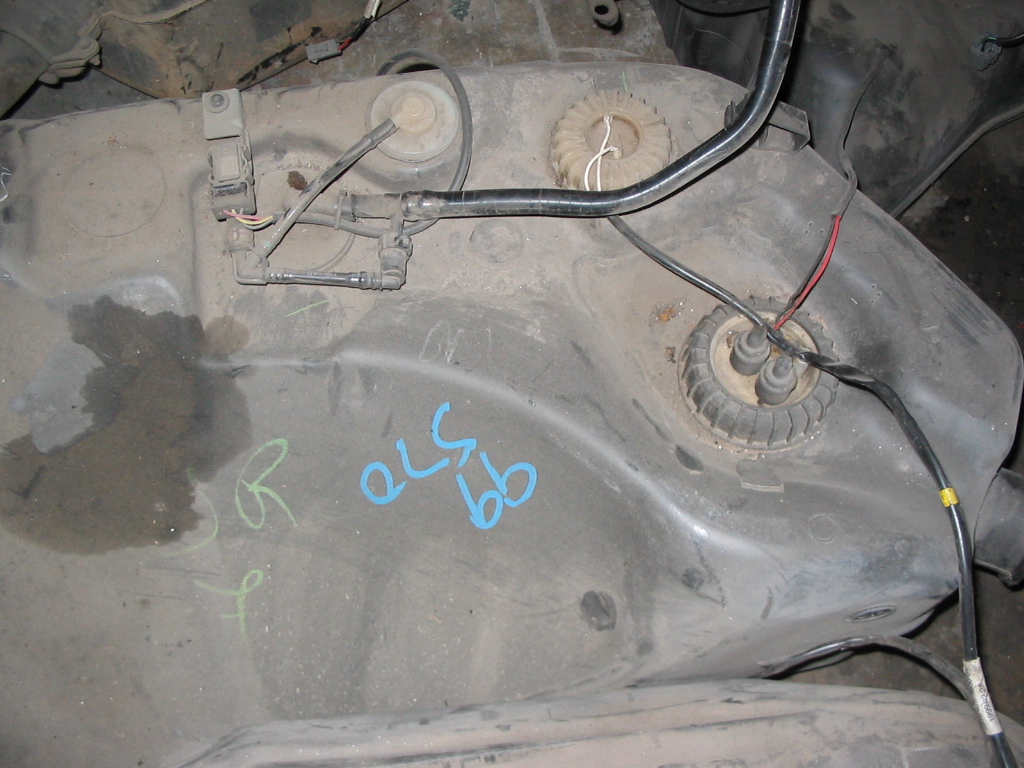

Tank pressure sensor is what I meant, sorry. Mine is located on top of the gas tank I believe and I think you have to drop the tank to get to it. I have not replaced the seal for the fuel pump or the sending unit. Parts for the smoker are sitting in the garage, my project for Saturday.sleddriver wrote:I had a chance to examine a fuel tank from a 98 off-the-car. Compared to an earlier 850, all the vac pipes on the 98 were HARD plastic instead of rubber. Also since I didn't see nor smell smoke from mine when smoked, I ruled out dropping the tank.98v70dad wrote:So even though there are a couple of rubber items on top of the fuel tank that haven't been replaced I believe that the likelihood of them being bad is low. Building the smoker will be a pretty easy way to confirm that. The fuel pressure sensor could be bad but I know no way to troubleshoot that.

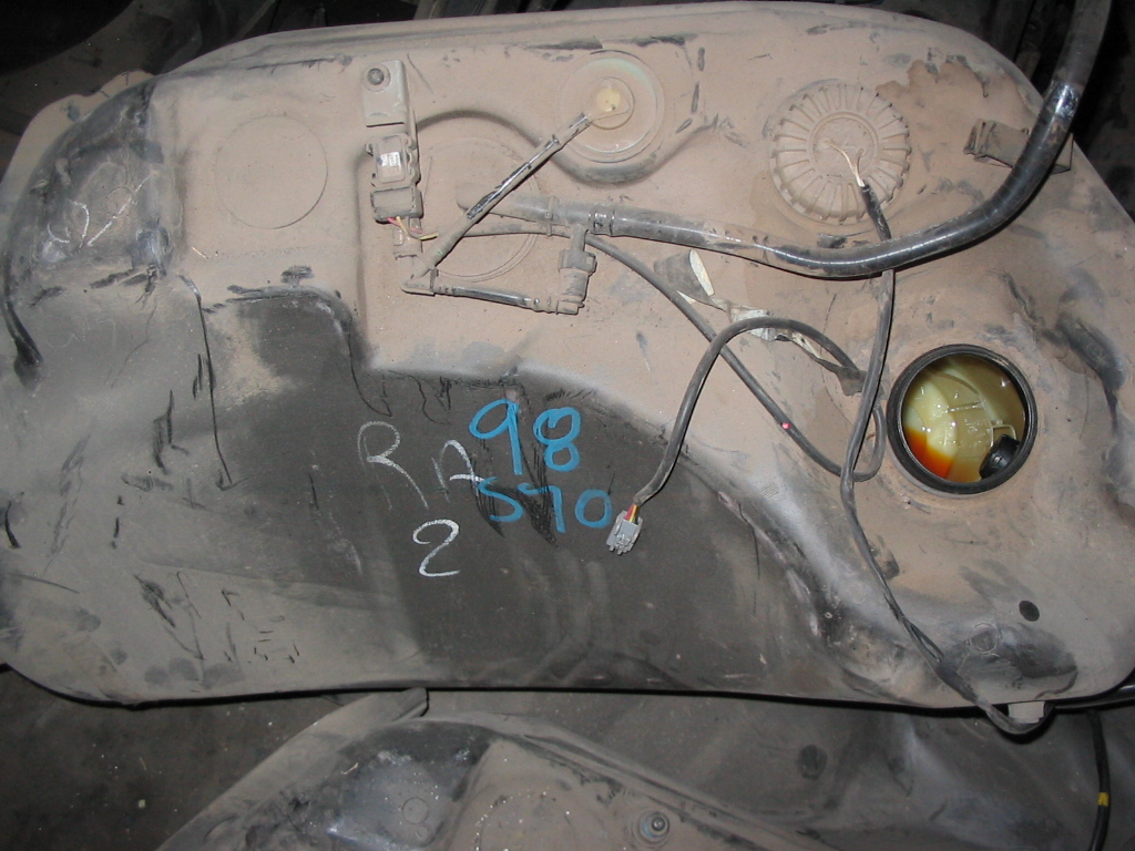

Here's some photos of a gas tank to give you an idea where things are. One is from a 98, the other, a 99.
- IMG_8067.JPG (359.18 KiB) Viewed 1085 times
- IMG_8068.JPG (359.36 KiB) Viewed 1085 times

Thanks those photos are helpful. Is it possible that there was more than one configuration in 98? Mine has a tapered rubber hose that goes onto a blue plastic fitting that runs between the fuel pump and sending unit. I know this because I replaced it a few weeks ago. It required drilling access holes in the floor panel to loosen the screw clamps. I don't see it in your picture.sleddriver wrote:Here's some photos of a gas tank to give you an idea where things are. One is from a 98, the other, a 99.

Sure it is. After all, you charcan is up front and mine's in the rear. The sled was born in Aug 1997. So you DO have rubber hoses on your tank, eh? Interesting.....98v70dad wrote:Thanks those photos are helpful. Is it possible that there was more than one configuration in 98? Mine has a tapered rubber hose that goes onto a blue plastic fitting that runs between the fuel pump and sending unit. I know this because I replaced it a few weeks ago. It required drilling access holes in the floor panel to loosen the screw clamps. I don't see it in your picture.sleddriver wrote:Here's some photos of a gas tank to give you an idea where things are. One is from a 98, the other, a 99.
Amazing how many changes, mods, and updates Volvo made to these cars during the same year and the following one before the P2 cars were released. One would have thought they'd have it all sorted for as long as the 850 was in production!
