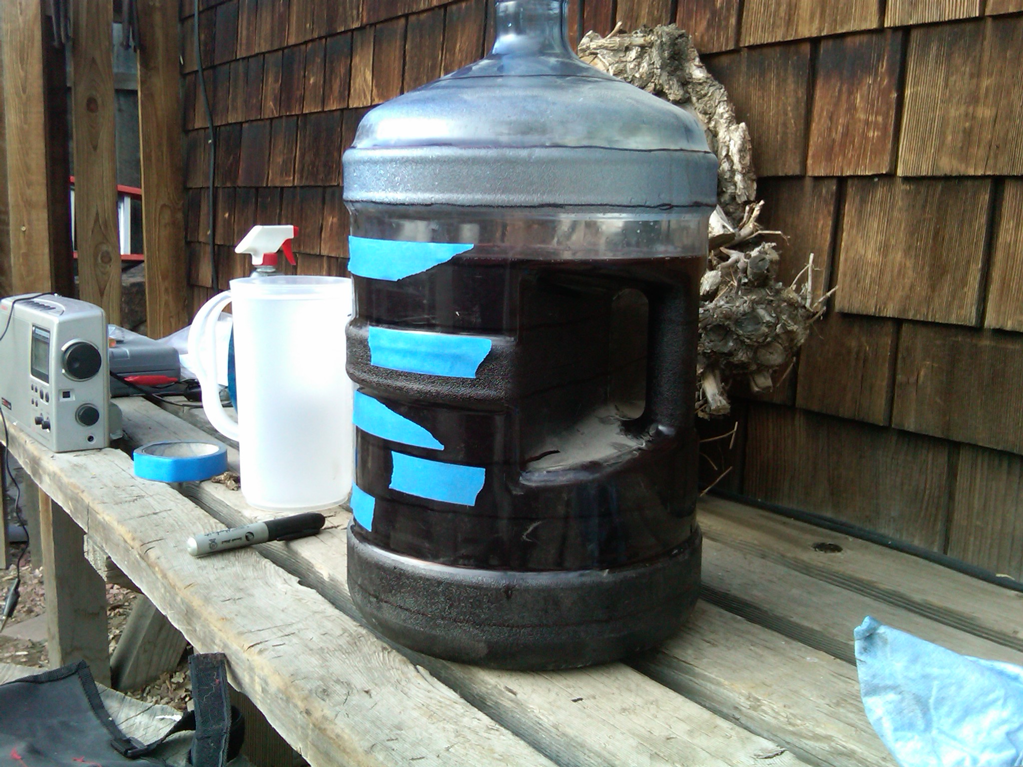

I ended up going to three different stores, Checkers, Auto Zone, Advance Auto Parts to round up 14 qts of Mobil 1. Why nobody carries enough in one spot is a mystery. I had a little over 15,000 miles and just 28 months but that first dose coming out on the purge was pretty ugly. Overall its a dark red. Can't see going 30,000 miles in between. No fuss, no mess. Did order the flush kit through IPD though and that came with new o ring and a new clip for the hose. I wouldn't use less then 14 qts. This five gallon water bottle worked great.
