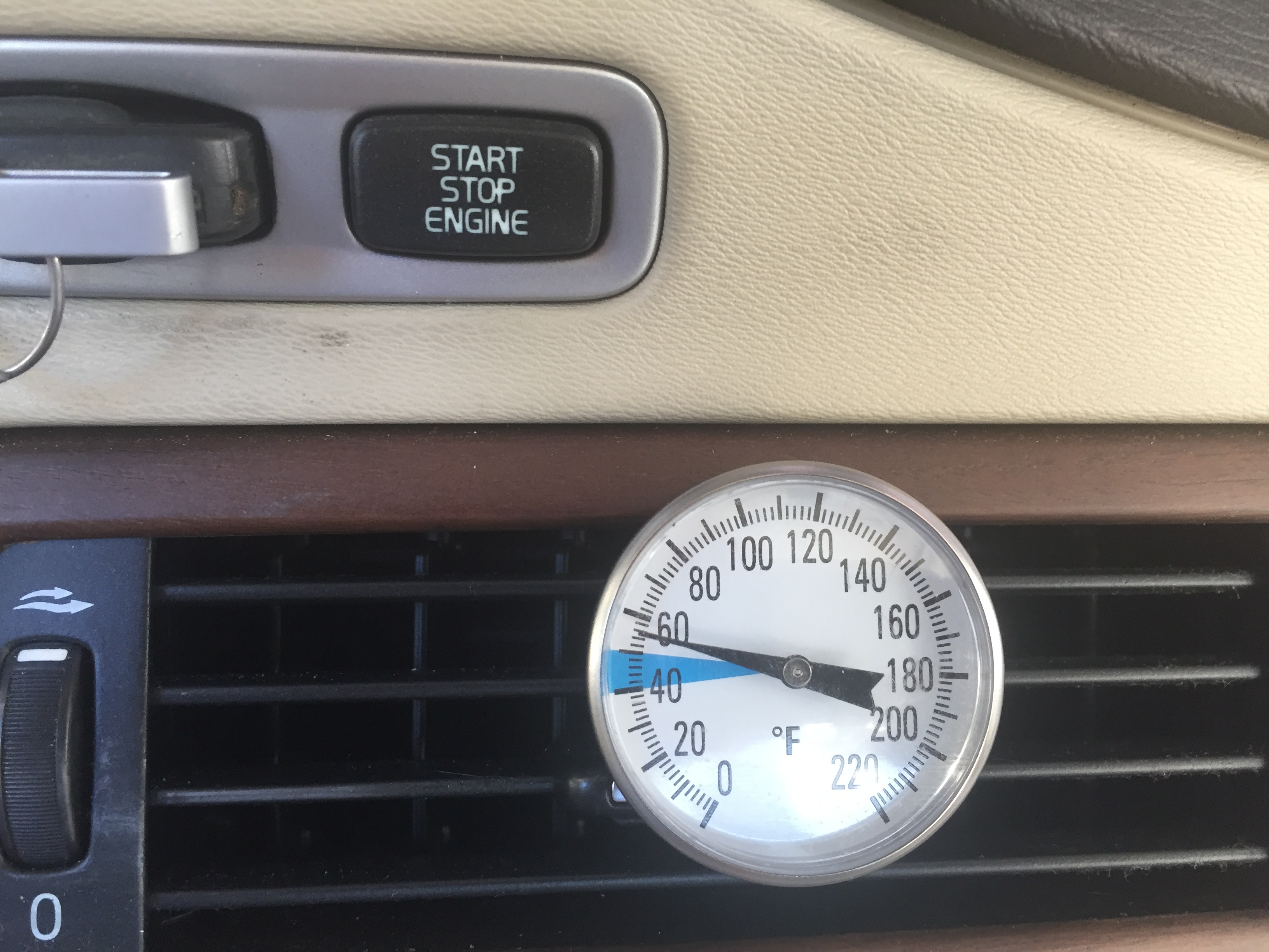

MVS Readers,
It’s very warm here today
The Dashboard temperature is from my LR2
The vent temperature is from my S80
What I can say with complete certainty is that I wasn’t cold walking the dogs today
Thanks
Paul
PS the AC compressor and the cooling fan are working well

A 45+ F temp delta is absurdly good.

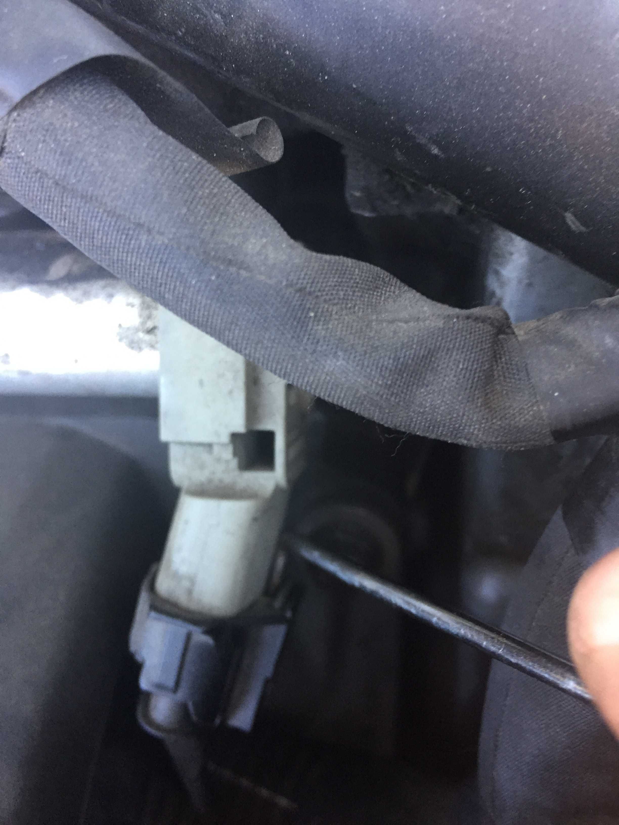

The Repair

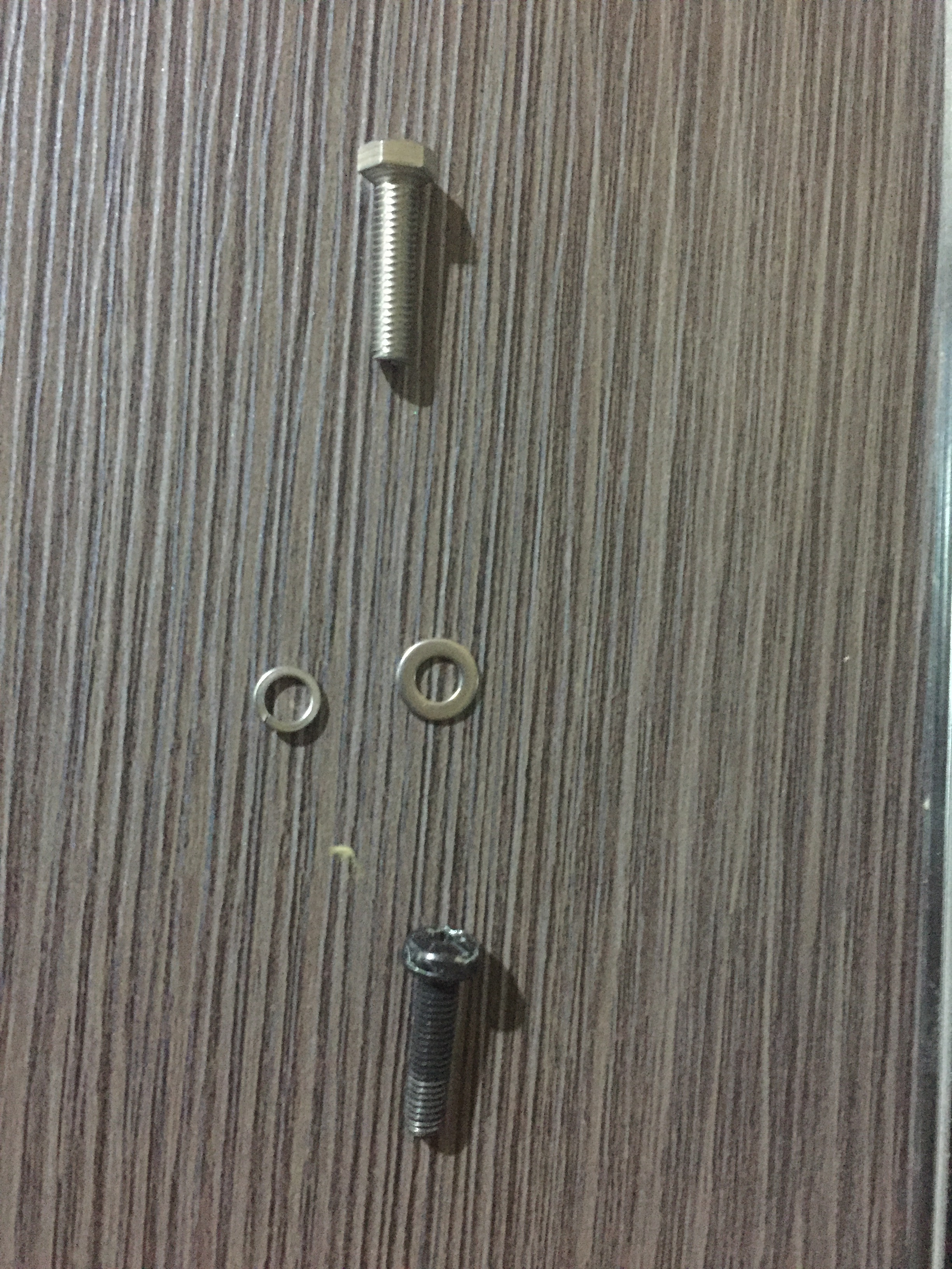

Removing the T25 is the most difficult part. I used a key to get it loose and then a T25 screw driver to remove it the rest of the way. The 8 mm hex bolt that I installed will be very easy to remove.
Release the latch and remove the connector

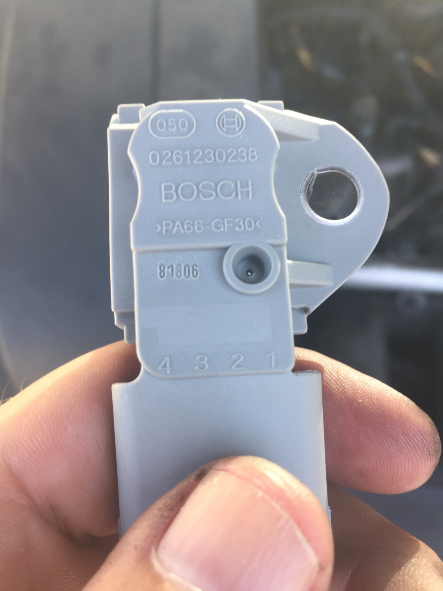

Inspect the new sensor
Remove the TORX T25 and replace it with a regular bolt (flat washer and spring washer) with an 8 mm hex

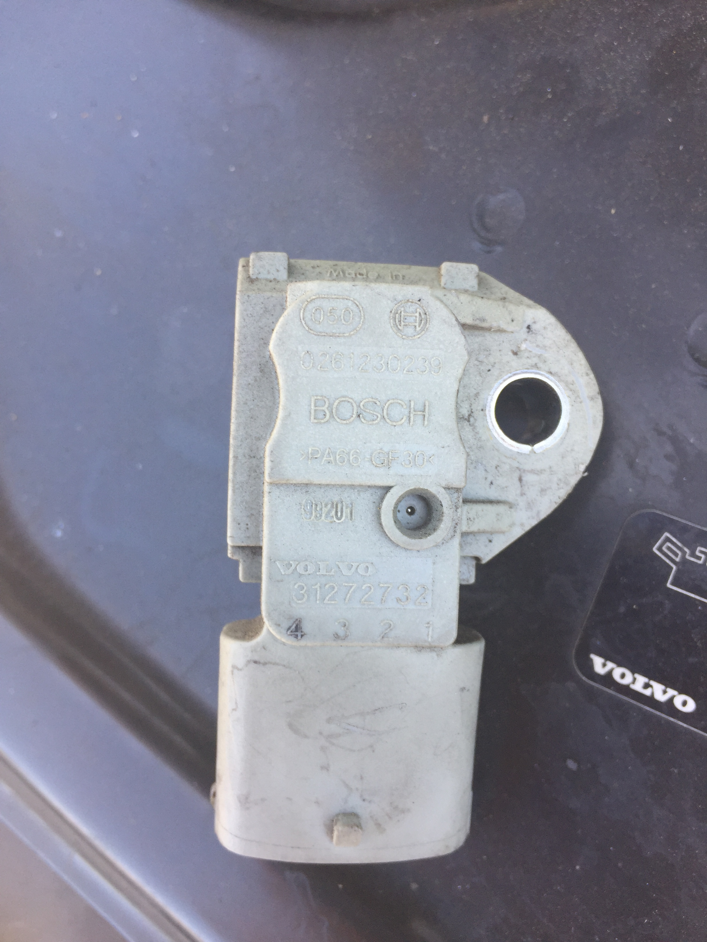

For reference here is the old part
