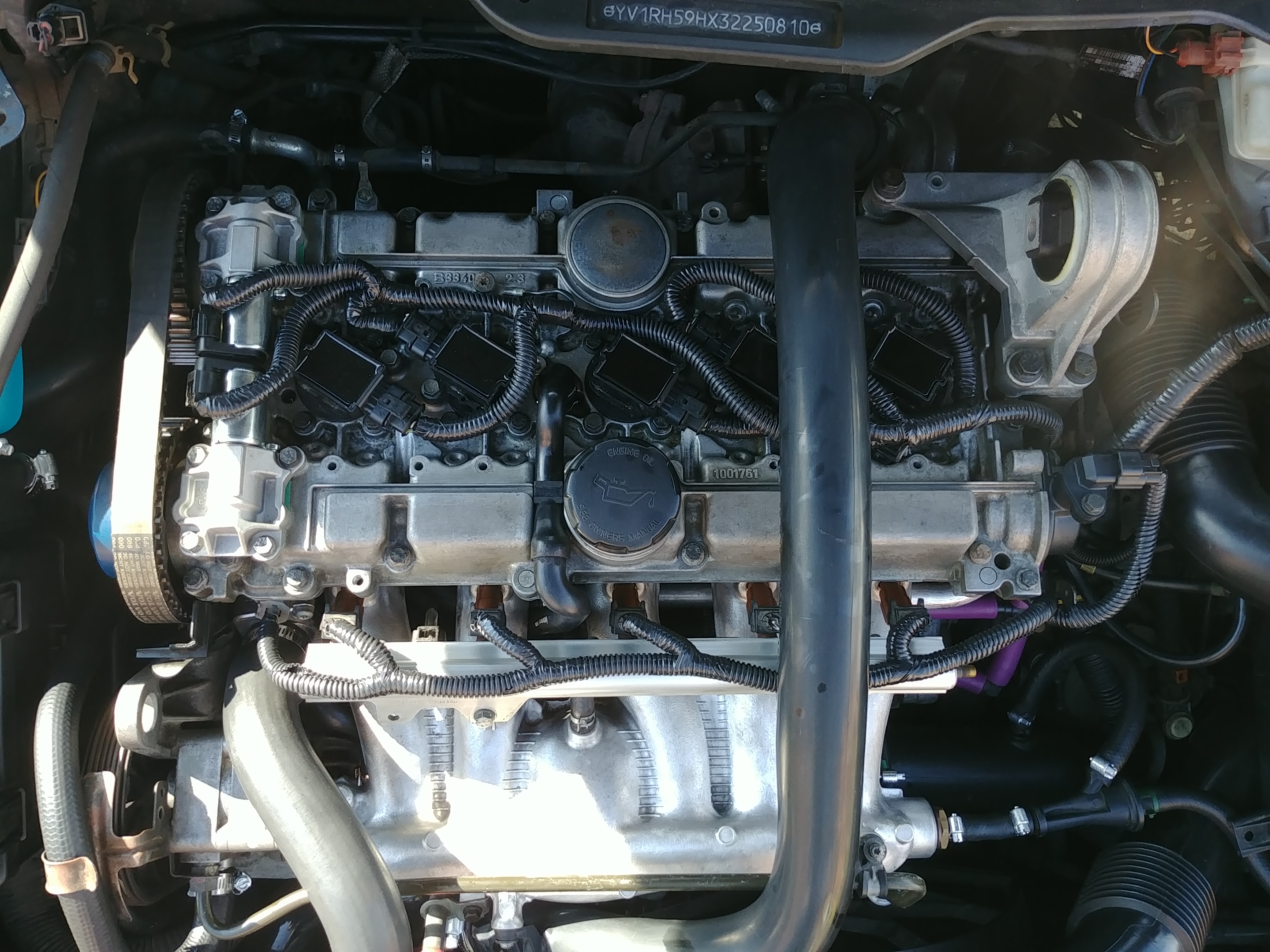

The coils are in the wrong place. Each plug has yo go to the right one. Take a picture from up top, shoeing all five coils and wires
