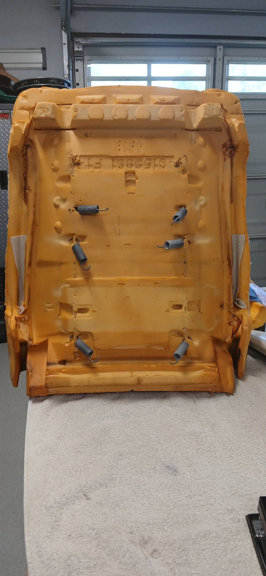

The back of the foam looks symmetrical and this is the blank air bag housing.
I read your seat post. Did you cover lumbar hole on the outside or inside and what glue? Thanks for offer, but I should have enough material from old seat.
Is not having the special stitching on my car's air bag side a real issue? And what do people do with the air bag on the frame I'm going to scrap
Sorry for so many questions!

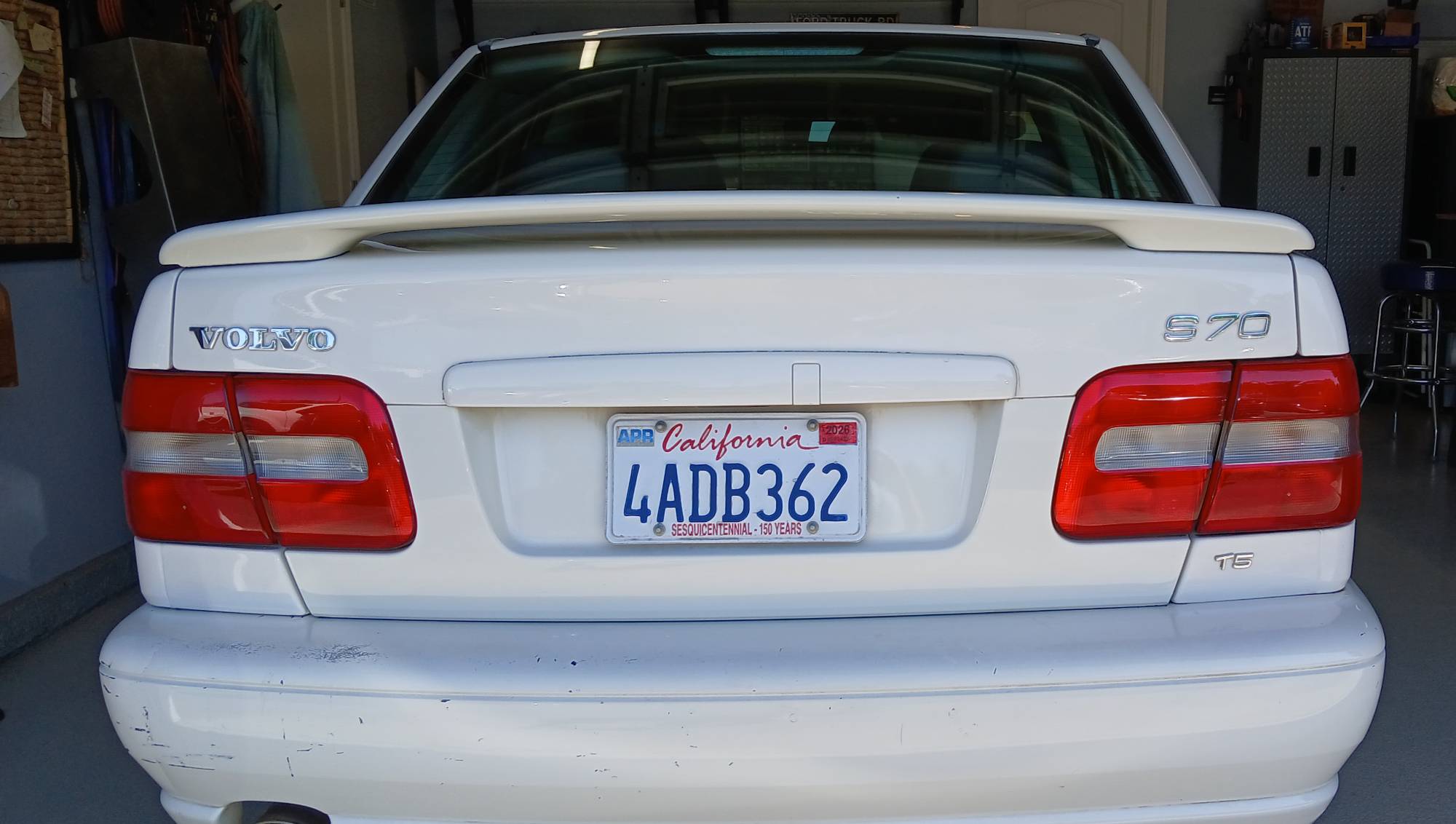

Robert's brackets came today in great shape so I polished up the spoiler and slapped it on.
No tape for now as I need to paint it.

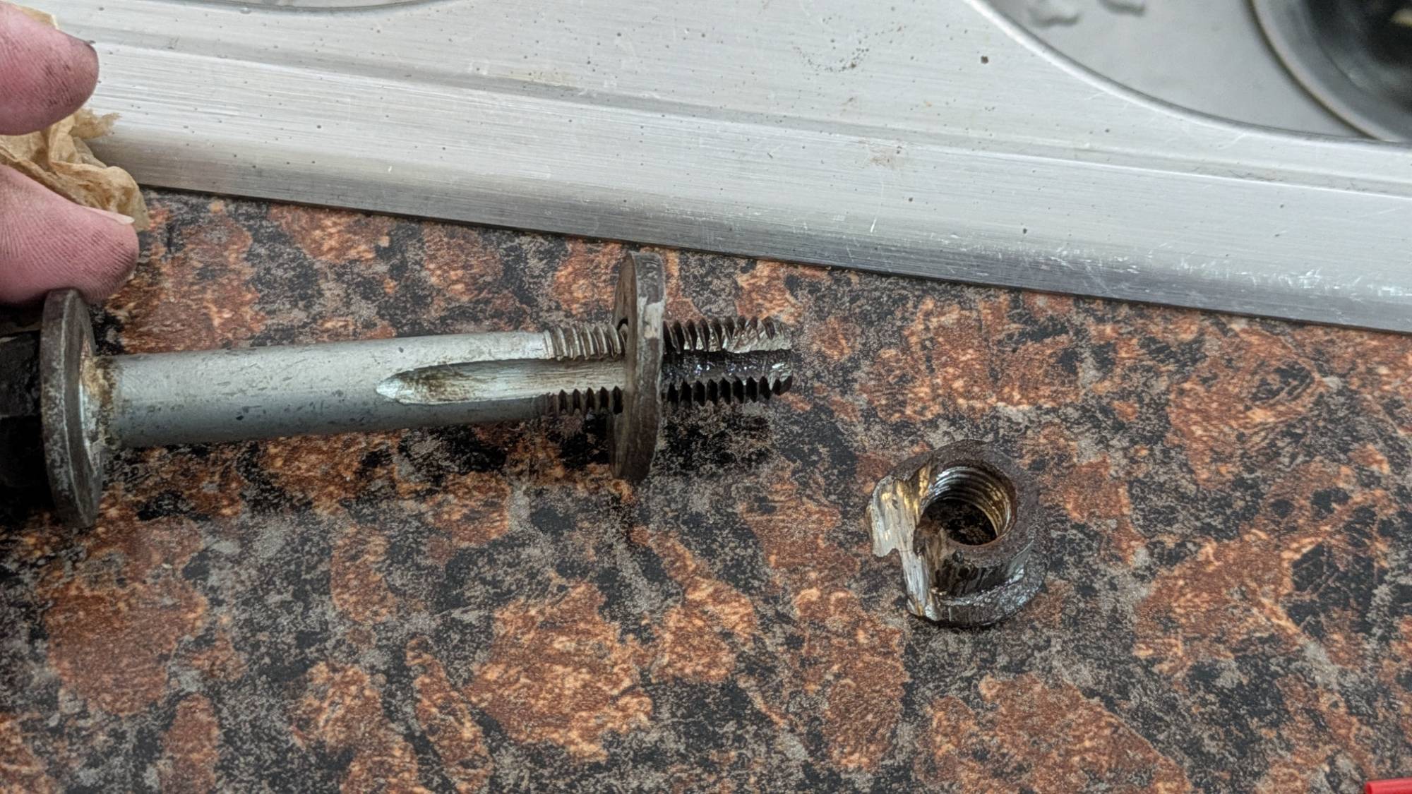

Yesterday I replaced rear panhard/tie-rod on the '99 V70 XC AWD 2.4T and the sway-bar link as they both snapped in two. They did not come quietly...
Posts: 35275
Has thanked: 1500 times
Been thanked: 3810 times
Nice job saving that Unicorn Tooth offset washer bolt with the washer groove.
Washers and nut available , the bolt is not
You can see the slit weakens the bolt that if you just twist it without heat and lube, it will snap like a carrot

abscate wrote: 13 May 2025, 04:35 Nice job saving that Unicorn Tooth offset washer bolt with the washer groove.
I gooped the heck out of it afterwards with axle grease down the length and fluid film on the ends. Since the last one lasted 25+ years, this will likely be the last time this needs to be done. Still have a new spare bar here which will live in the trunk. Have to zip tie the ABS harness on that side as the plastic guide for that is long gone.
