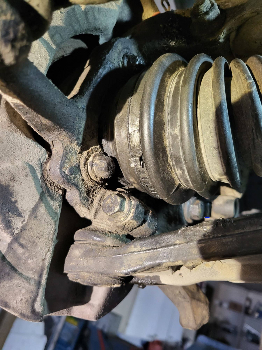

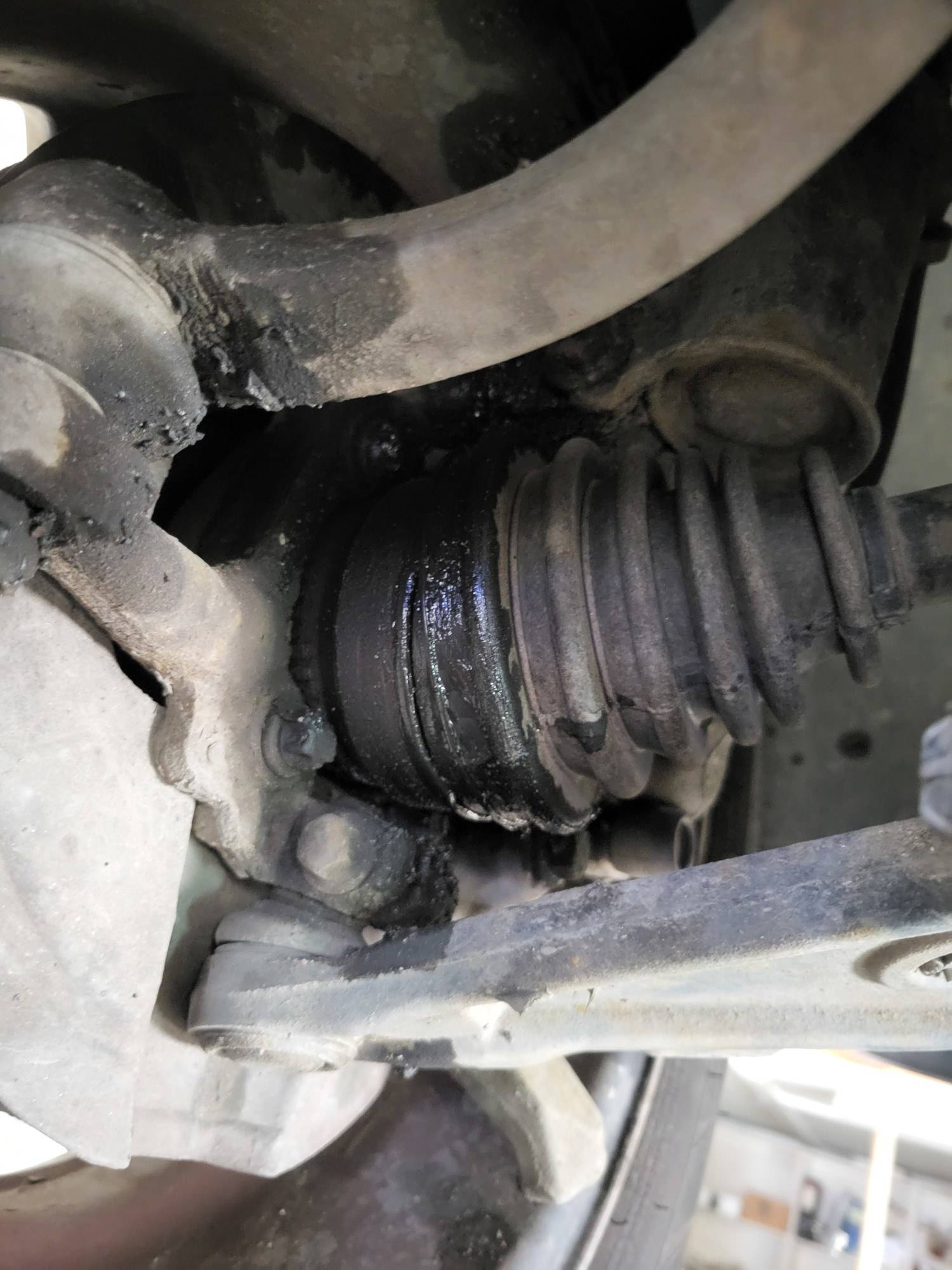

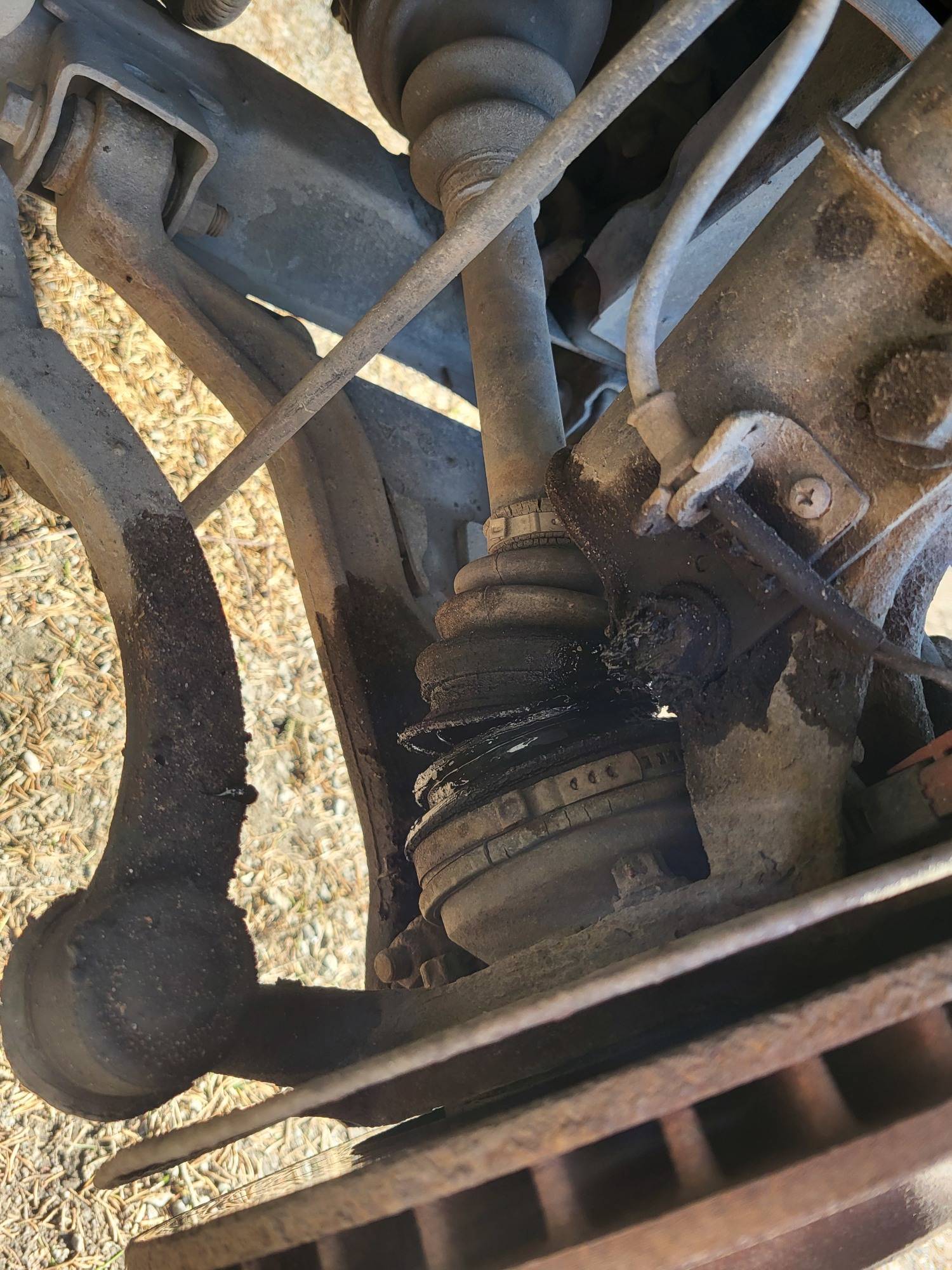

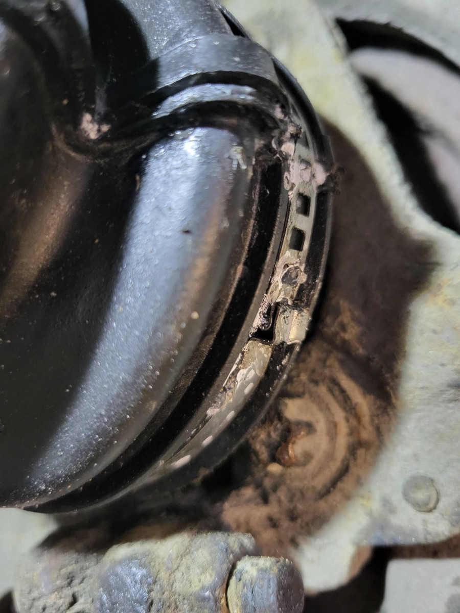

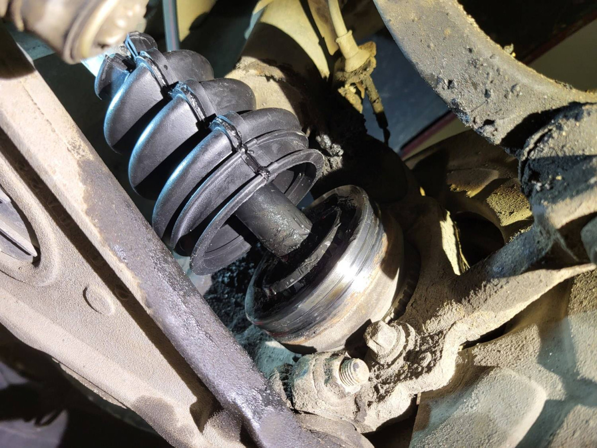

Did change summer tires and old known guest was found, bad cv boot.

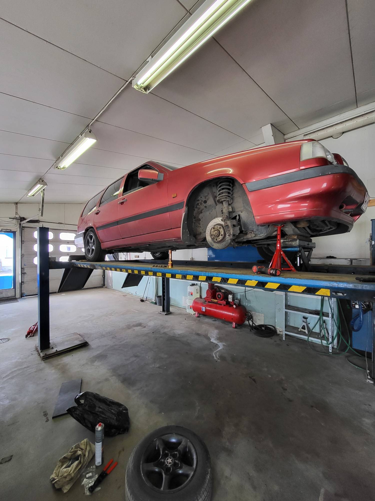

So little time later got to use lift (very nice first time experience this luxury)
So this choice comes that this side was done same time as other side but.. other side has split boot and its still fine. This bad boot was one of those which you pull just over axle. I dont know brand of it as i was just who took axle out and put it back with new boot.

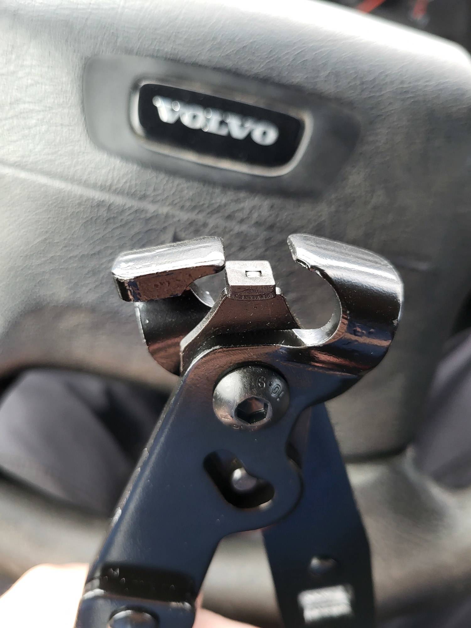

I did then put crimp but.. i got light bulb moment that i have done long time something wrong so i searched right tool and not the one which looks similar.. bingo it has extra smashing hand so did then buy next day right tool for the job. Now looks more like it would work longer and it crimps tighter as a plus too.
Lets look the driver side.. uh oh. Crimp didnt hold (this been pain keep.. the split boot is way too big 80-110mm.. way too big!.. correct size is 80 or 90mm and i used 80 which is 80..89mm which after gluing was tight to put with little expanding. not too much work.. )
.. after picture i did crimp it slightly more still.

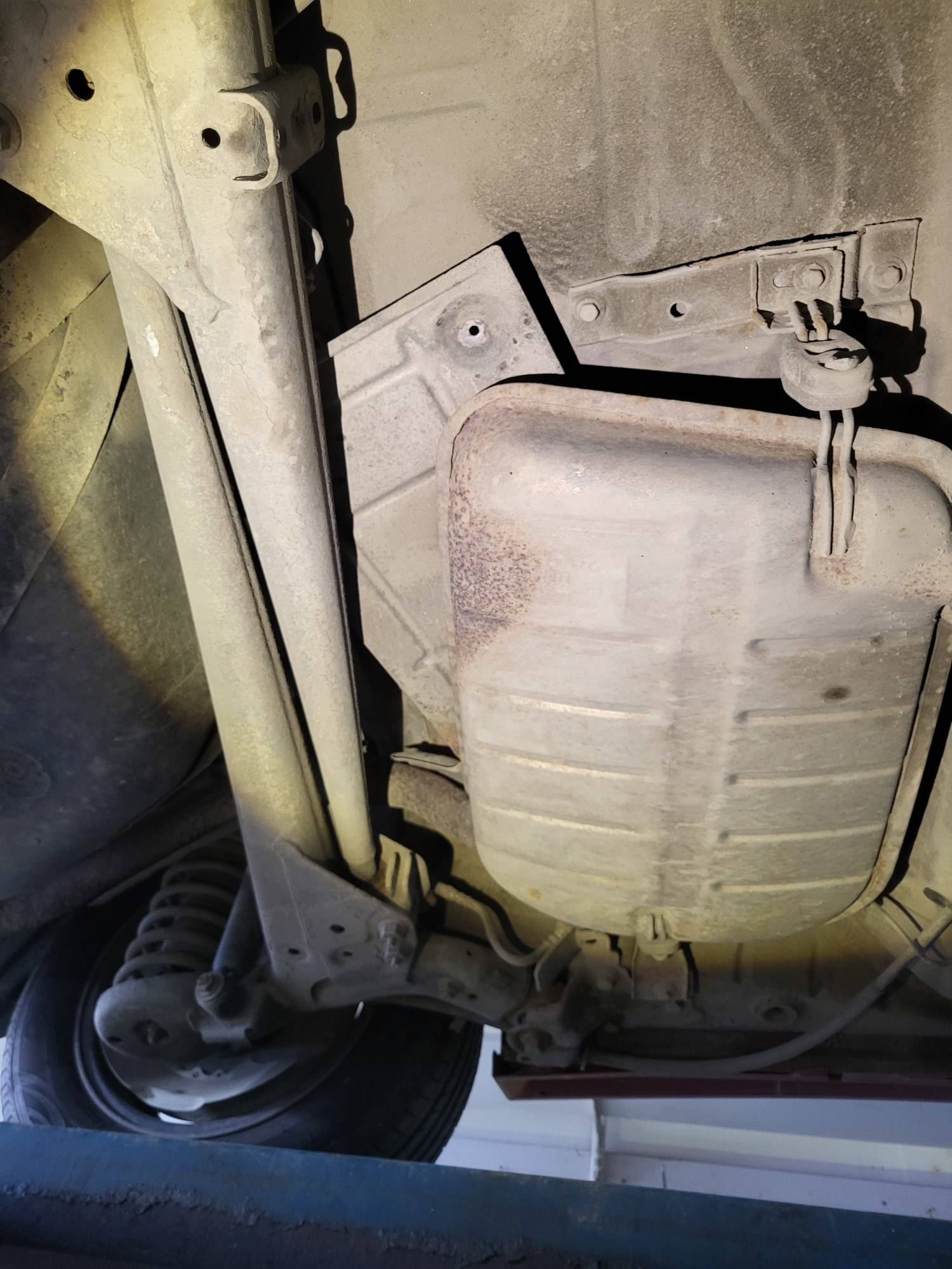

As another bonus i found extra metal sheet in my car!
Didnt get it easily so i left there as doesnt rattle.. then in future i deal with it.
