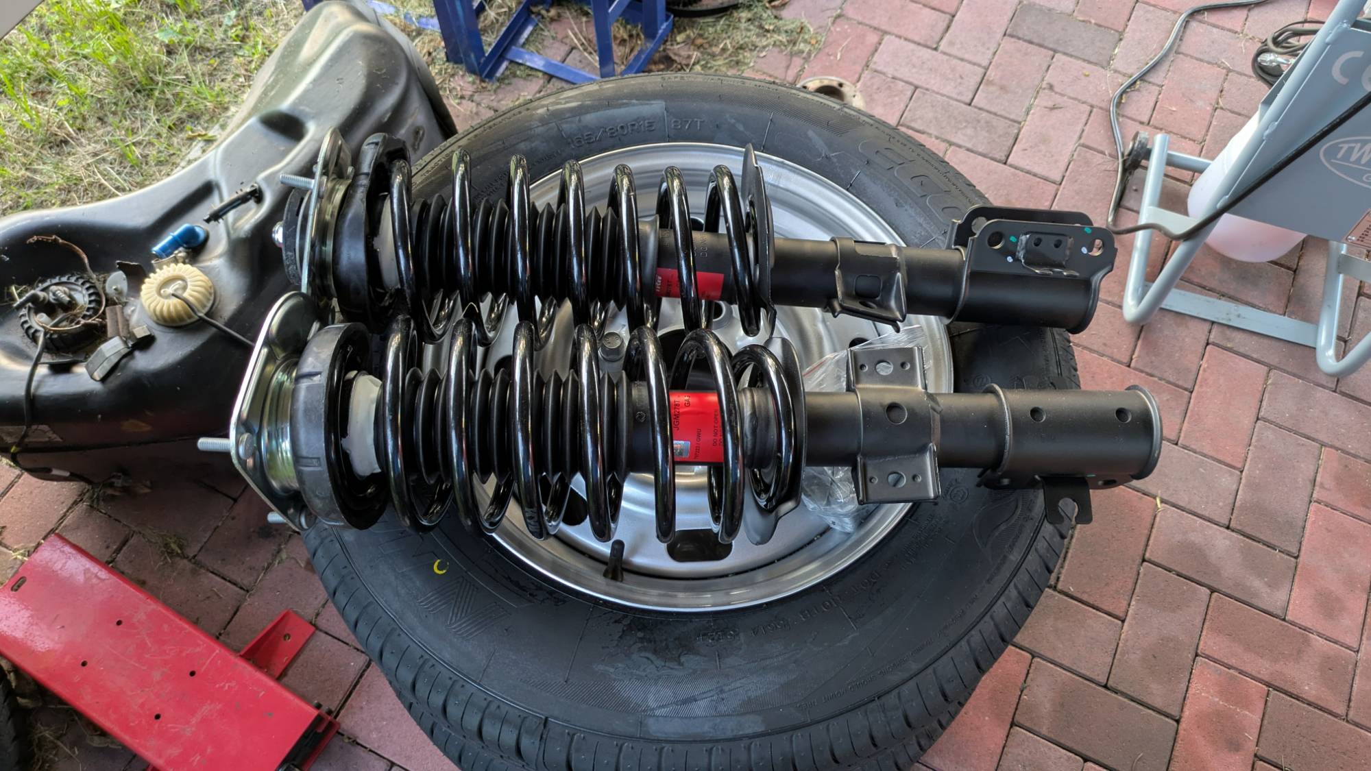

The front shocks were assembled and are ready to be installed once the rest of the front axle is back together.

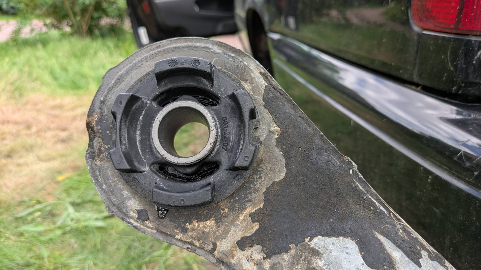

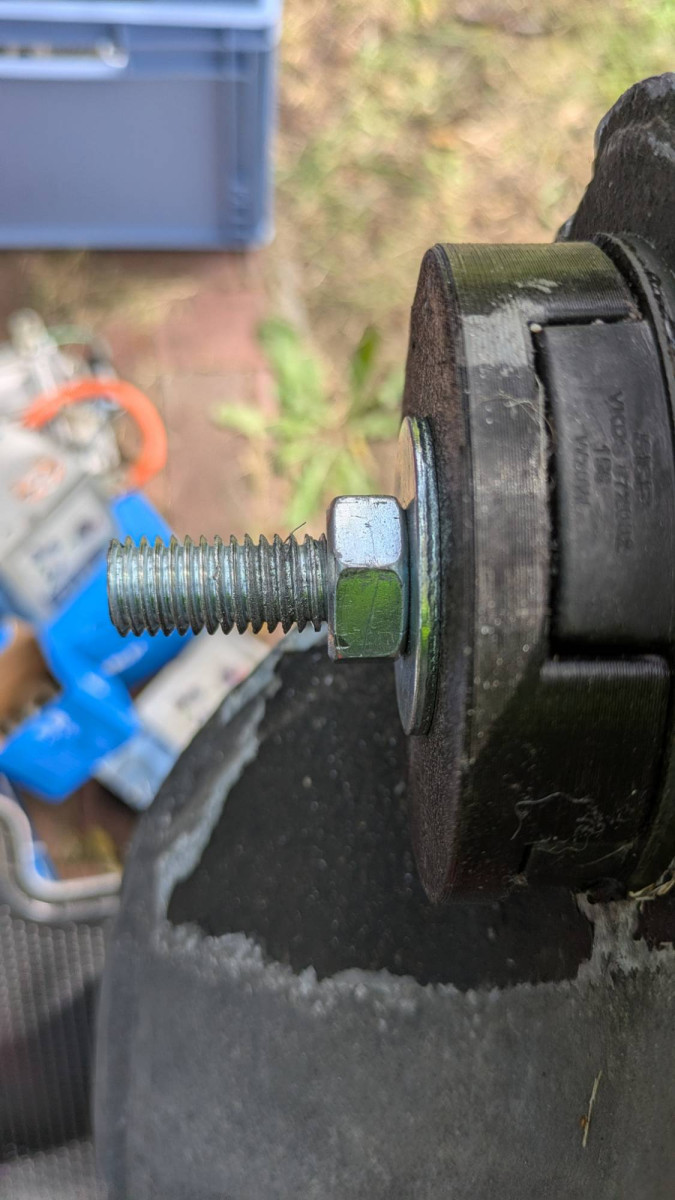

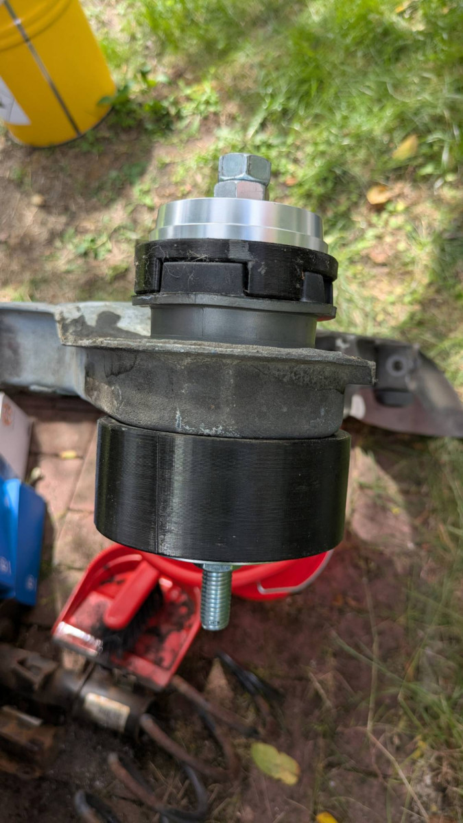

The front subframe got new subframe bushings. The installation was a breeze with my 3D printed tool, but the threaded rod was pretty much toast after installing eight of these bushings (four on my S60):

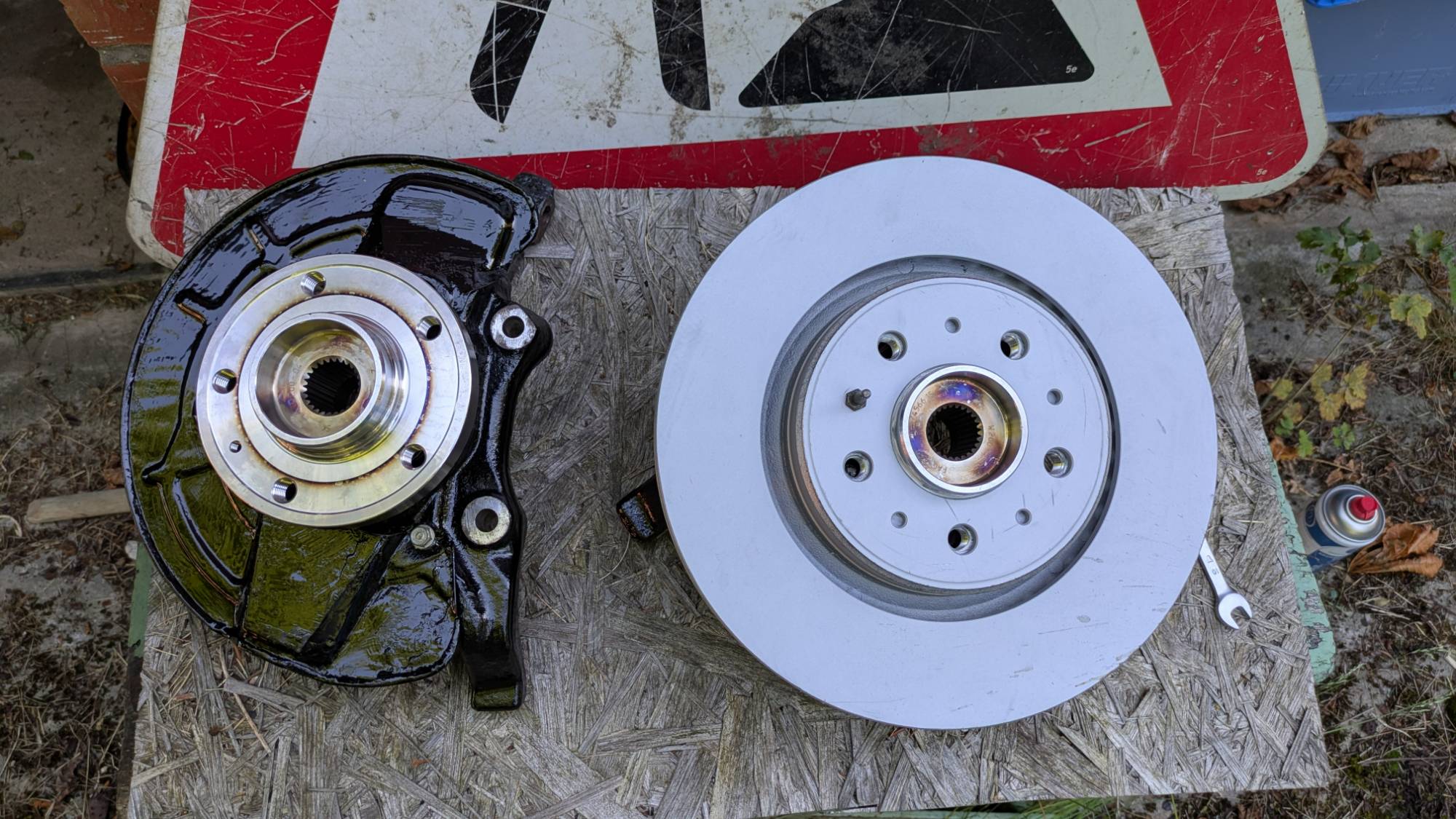

The front knuckles were completely disassembled, cleaned, painted and reassembled. Since everything was replaced anyways I used the opportunity to upgrade from 15" to 16" brakes:

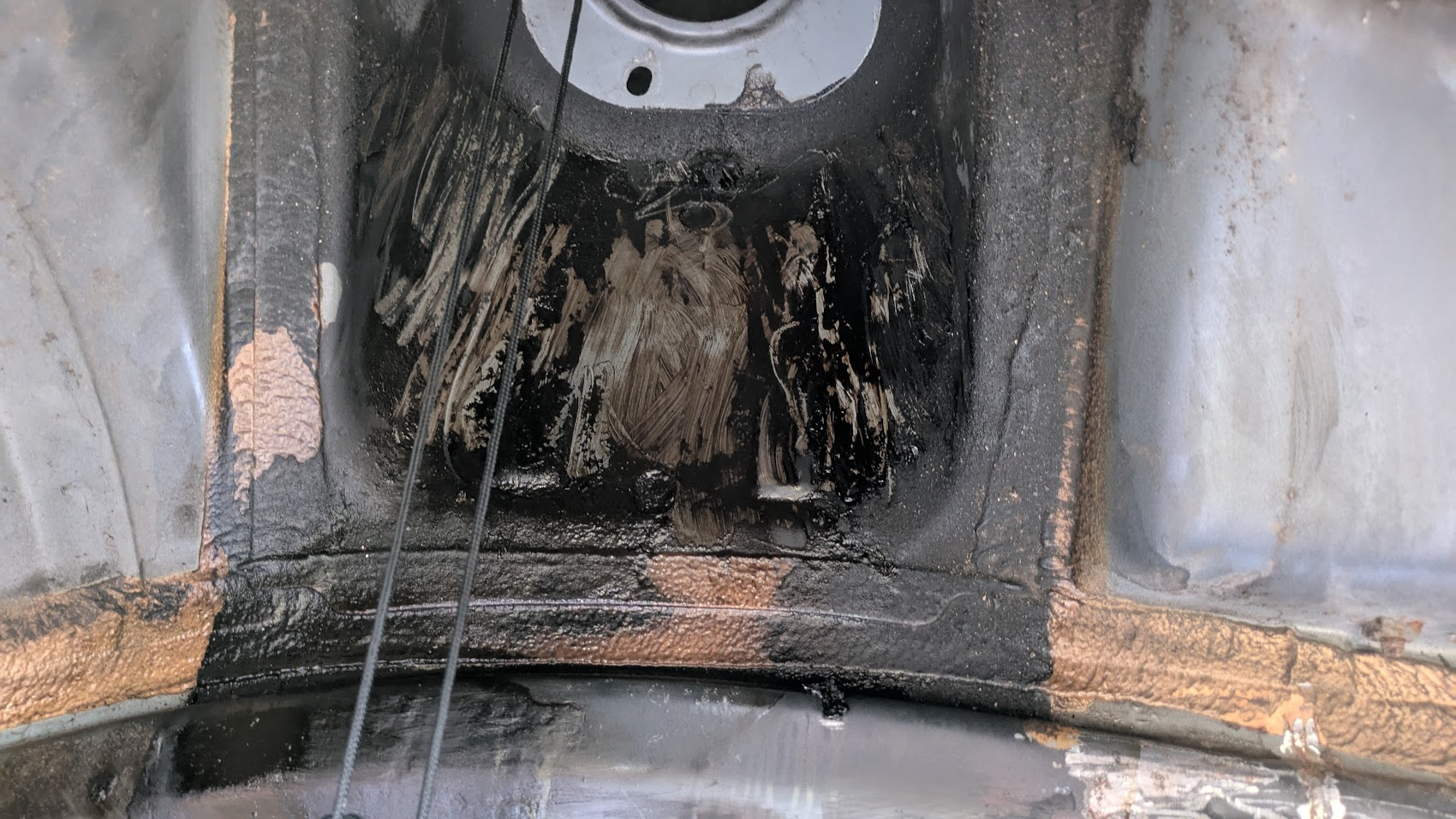

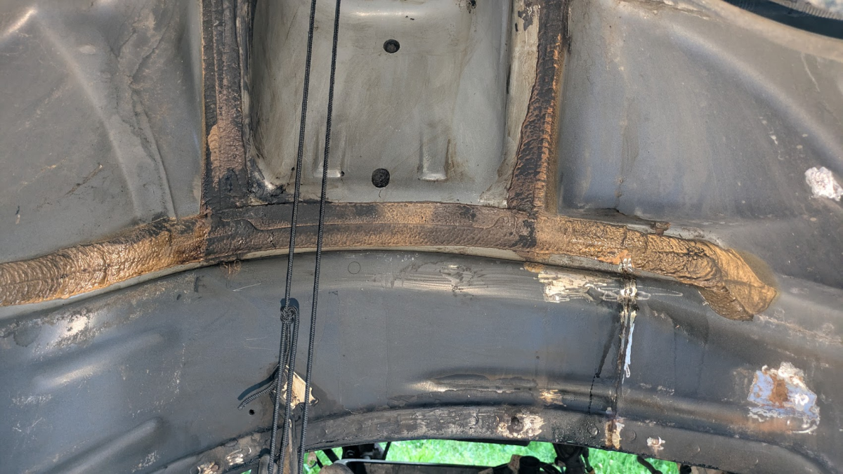

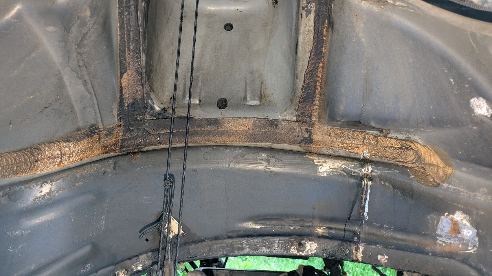

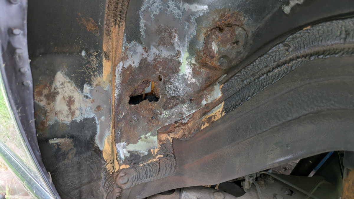

Under the inner wheel liners there was some rust, so I ground it all off, applied epoxy based rust converter, repaired the seams and primed everything with Brantho Korrux. Once that is quite dry, it'll be painted with black paint and hopefully stay rust free for the next years:

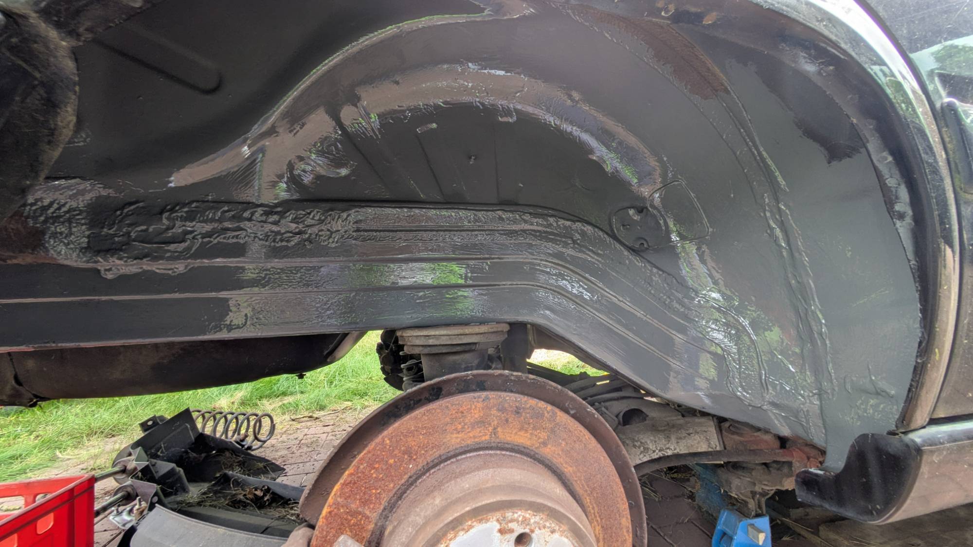

In all wheel wells there was some nasty bitumen based undercoating and I'm not sure if that was original?
It was sprayed on the springs and wheel liners as well (partly), which I don't really think Volvo would do?

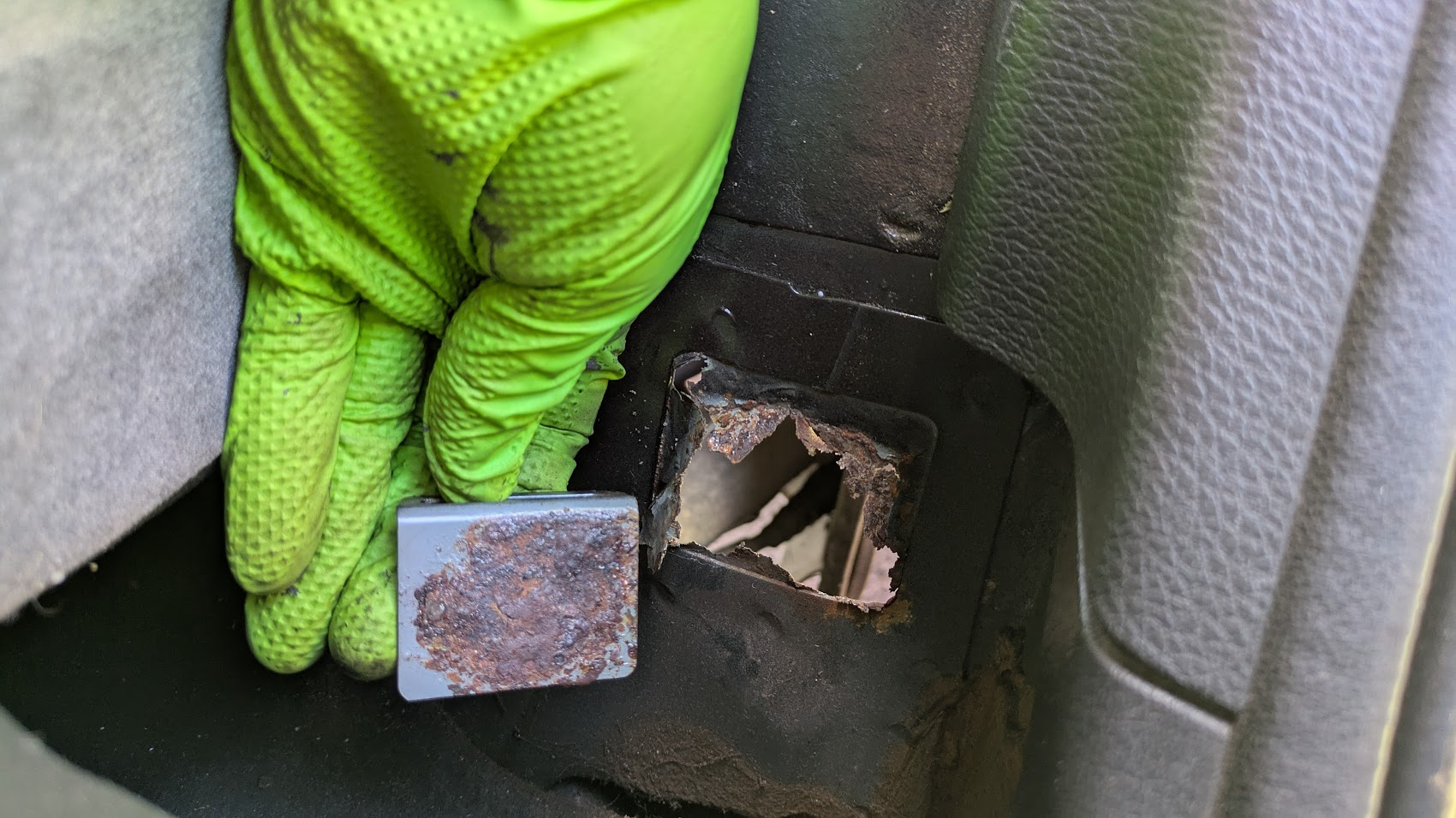

The other side needs some more attention, under the plastic liner a rust hole developed. Interestingly right where the bracket for the side cusion was spotwelded on:

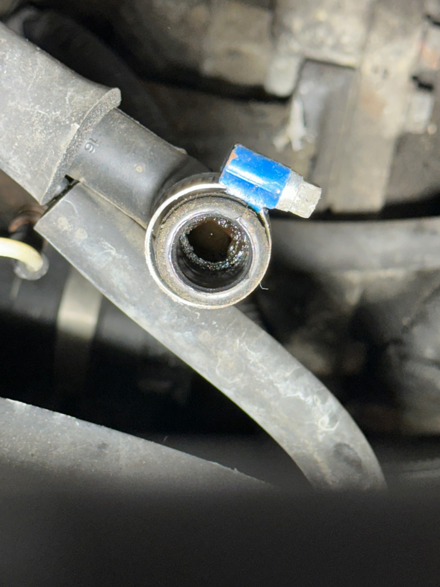

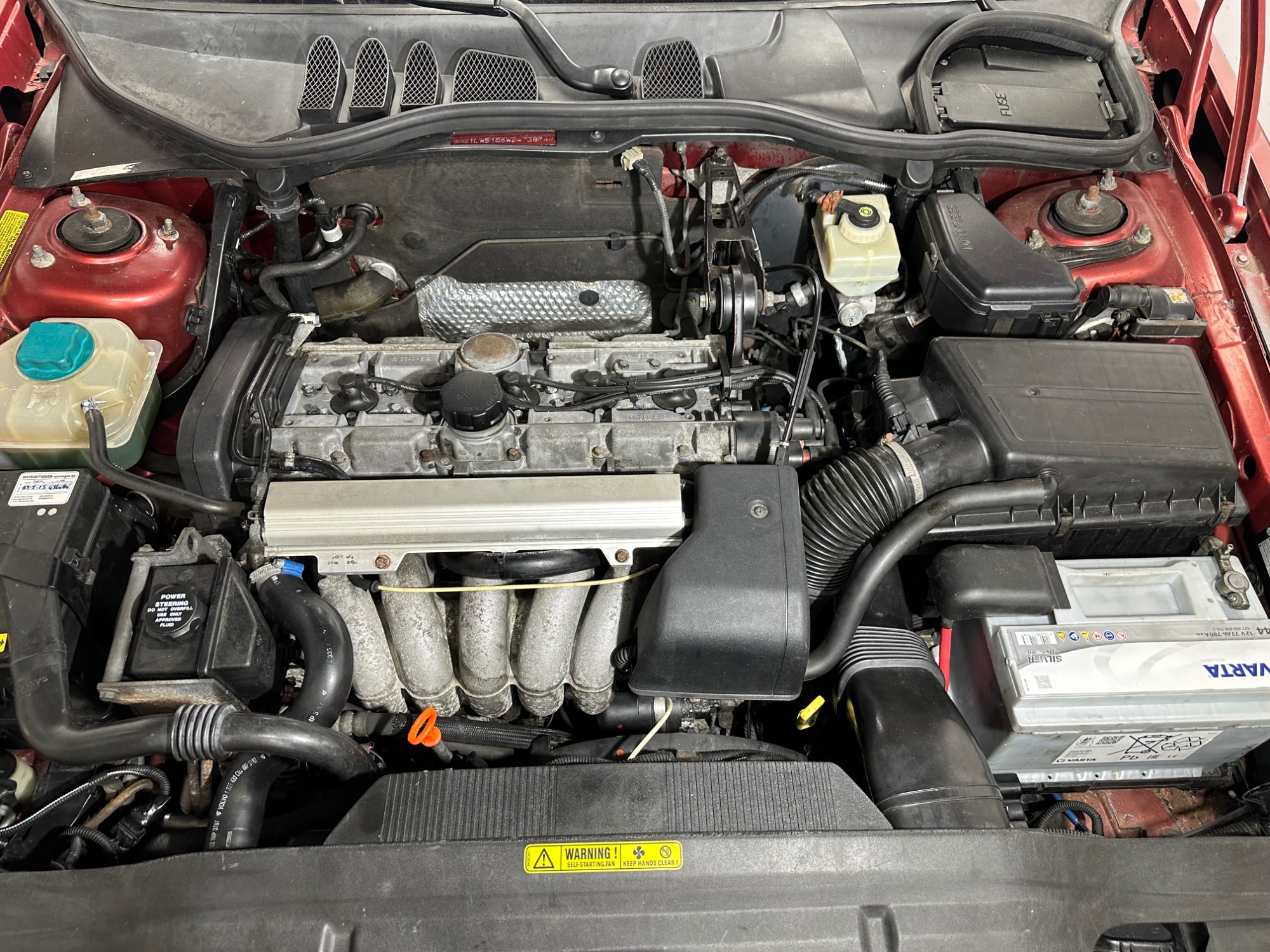

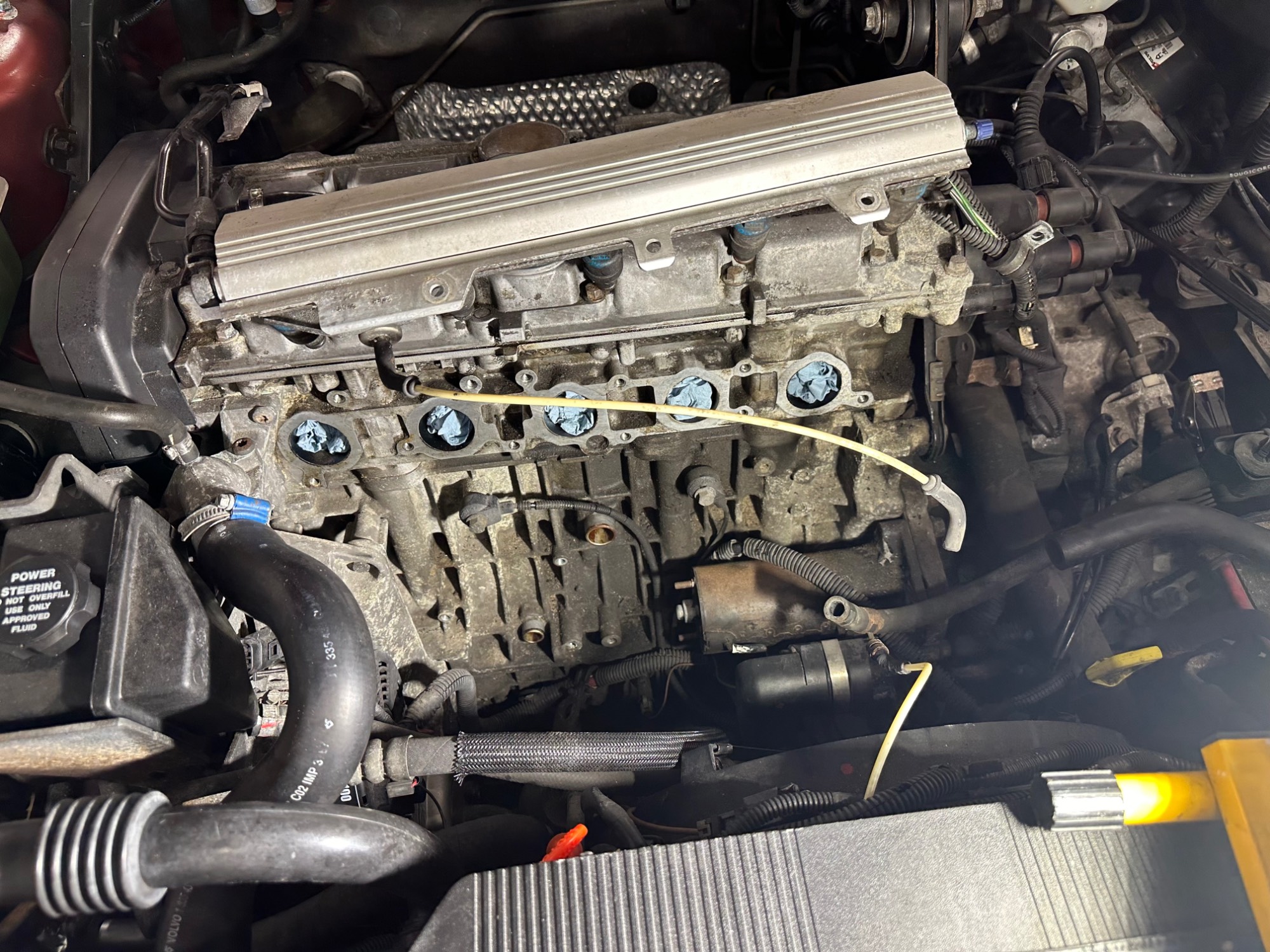

Did the pcv with larger fuel hose mod.
Old one wasn’t clogged that bad. Seems like it was done not too long ago. Still replaced everything.
But now I have to retrace every connection and hose, because the engine is hesitating when cruising highway speeds at around 3k rpm and higher.
