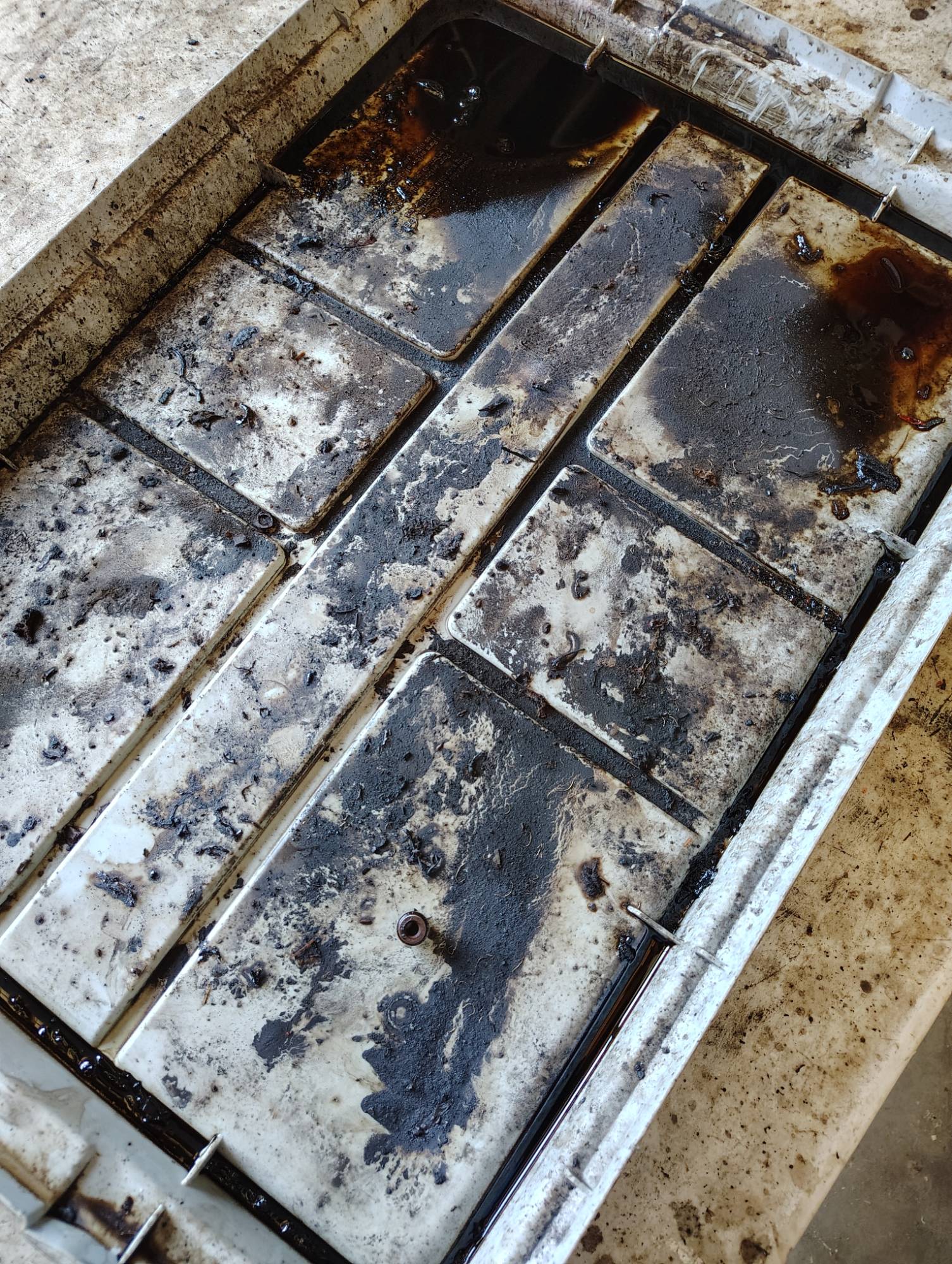

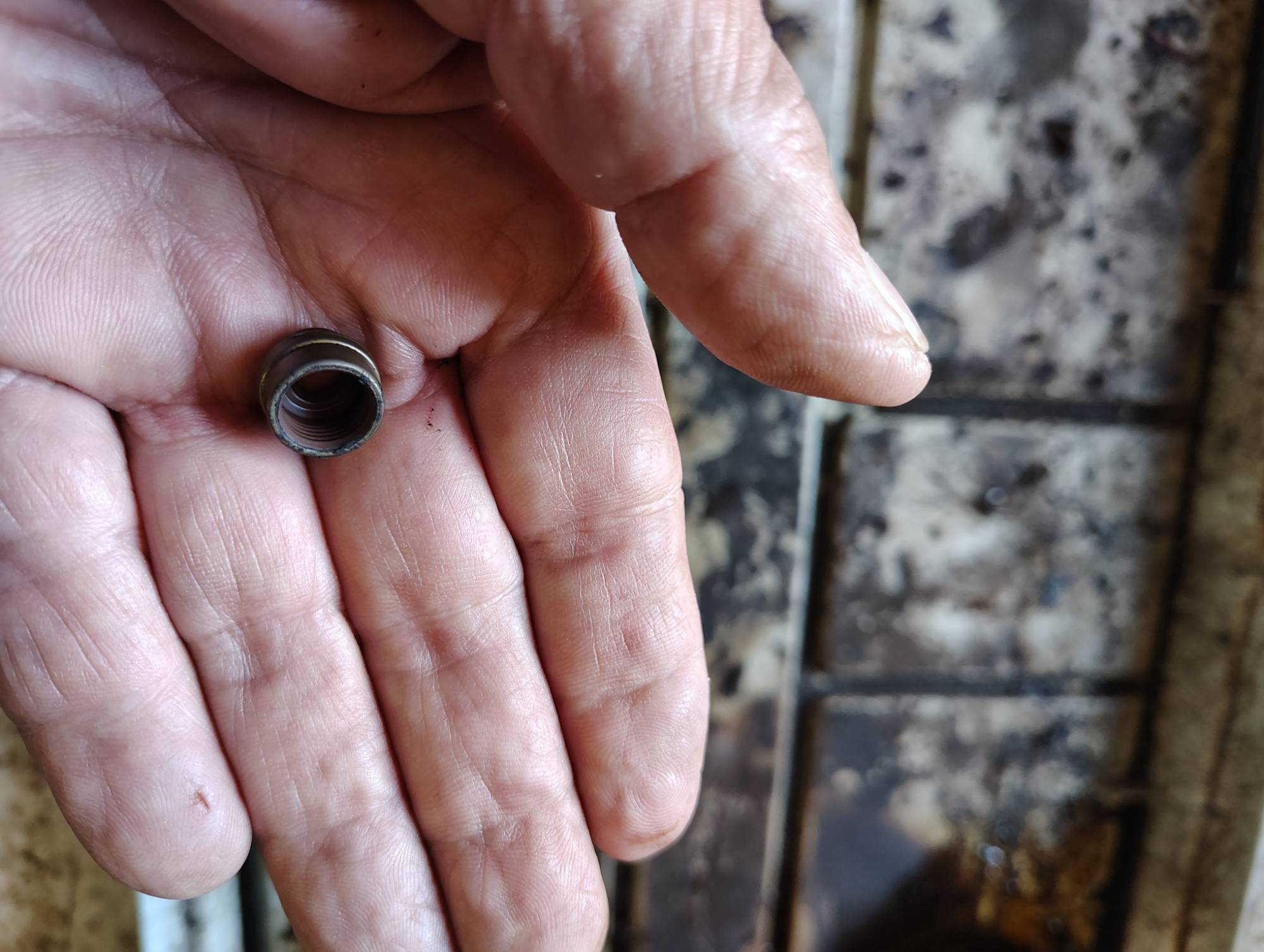

So here's something else to chew on. My procedure for cleaning the head is copious amounts of throttle body cleaner (4 cans on this head), followed by a soak in hot water with detergent. Then another shot of throttle cleaner if needed, and finally WD40. When I lifted the head up to take it for its bath, I noticed this left behind. Yep. A valve seal just fell off of the guide. I don't think they're supposed to do that
So at least in this case, faulty seals were the culprit.

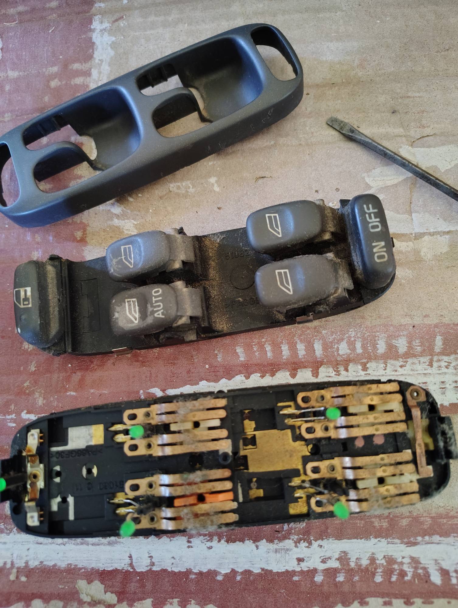

Windows decided to stop working today. Took the master switch apart, and yuck...
Cleaned, reinstalled and windows work again, though one of the rears seems a little finicky.
