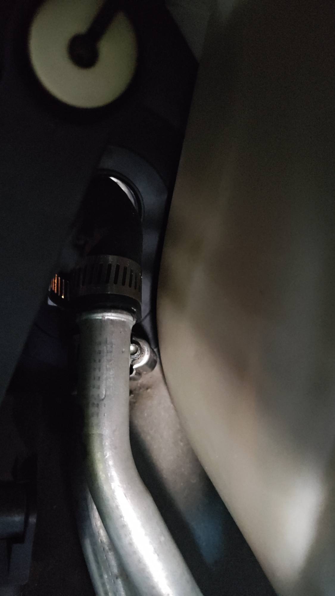

When I was standing there talking to seller about the gray Volvo, he said the firewall connection to the heater core hoses had broken plastic.

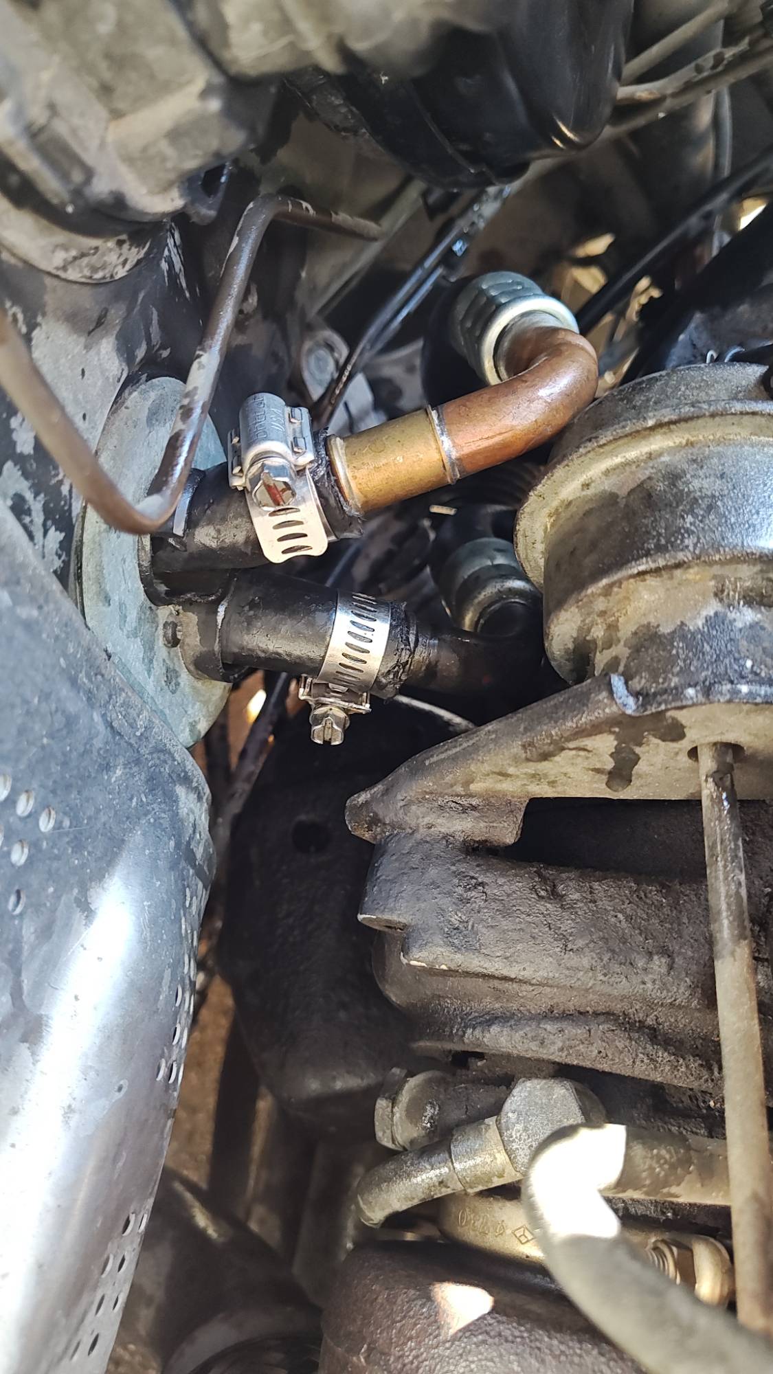

A few days ago I looked and discovered it was the piping from firewall to heater core. I thought for sure I was screwed. Yesterday, I went looking for the part. EBay and everywhere else showed $250-550. Part 9134978. I searched on here in despair. Then I remembered my red Volvo trailer, so I went in there to look if that was left in there. It sure was. And that excellent condition heater core was still in there. What's weird is that when I pulled out the piping from the firewall, it came out broken the exact same way as my 850.

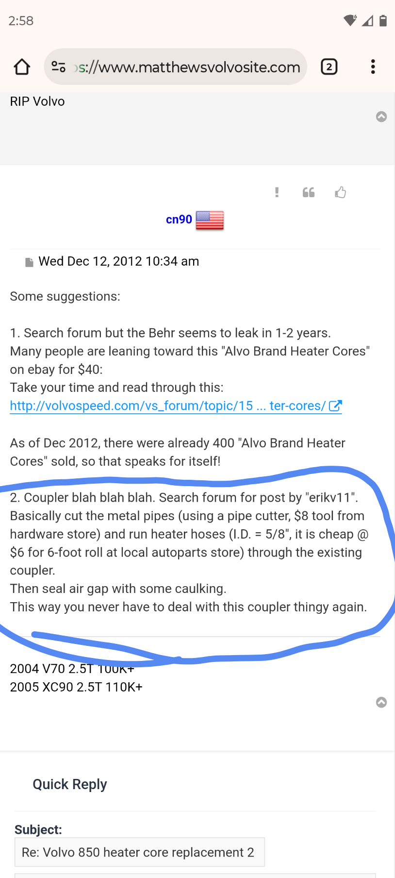

I got an idea from cn90 (screenshot below). I didn't go with his idea of cutting the metal pipe. But I will need to caulk the firewall. I think a tiny leak (passenger side) is coming from heater core pipe connection so the two o-rings need replacing. I'll do that in a couple days.
I am this much closer to selling my Volvo to my mom so my sister can have a super cheap starter car.

I can hear those heater hoses crying….Oetiker…oetiker.
