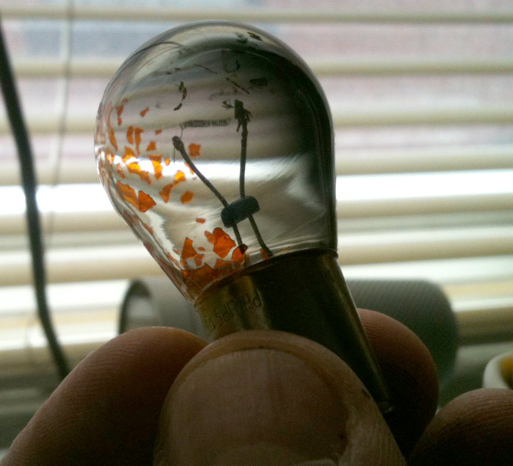

Here's a closeup of one of the two (original!) rear amber turn bulbs I replaced:
whoa
