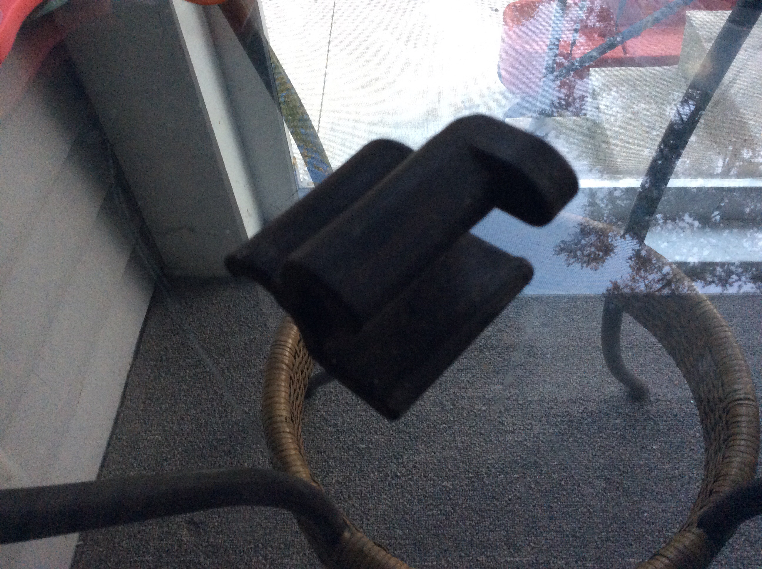

Put in a new Walmart battery and there was nothing holding in the old Interstate battery.
Have to look for whatever bracket is required.

It's a black plastic clip, goes down at the bottom of the battery, clips onto the tray. All the usual suspect online suppliers sell it, etc.

Yeah - thats important Pete - bouncing battery won't live too long. Even a bungy cord will work until you get the clip.
If its rare or ridiculously priced, I think I have one from my parts car at 1/2 ridiculous price.

Hey Pete I have one of those hold down clips if you want it....pm me your address

They cost like 5 bucks but like most 850 parts, junk yard is going to be more bang for your buck.
EDIT: I didn't see kahl's post, that's your go-to.

Thanks everyone! PM sent to kahl.

Out to you tomorrow!!
