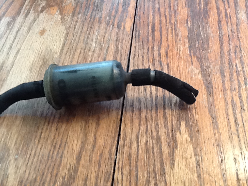

Found another hose that was bad. This is up under the top turbo hose.
