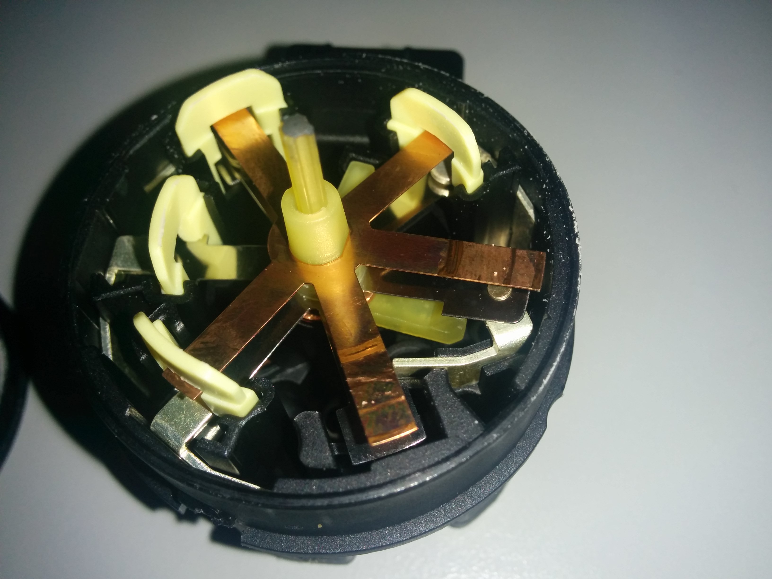

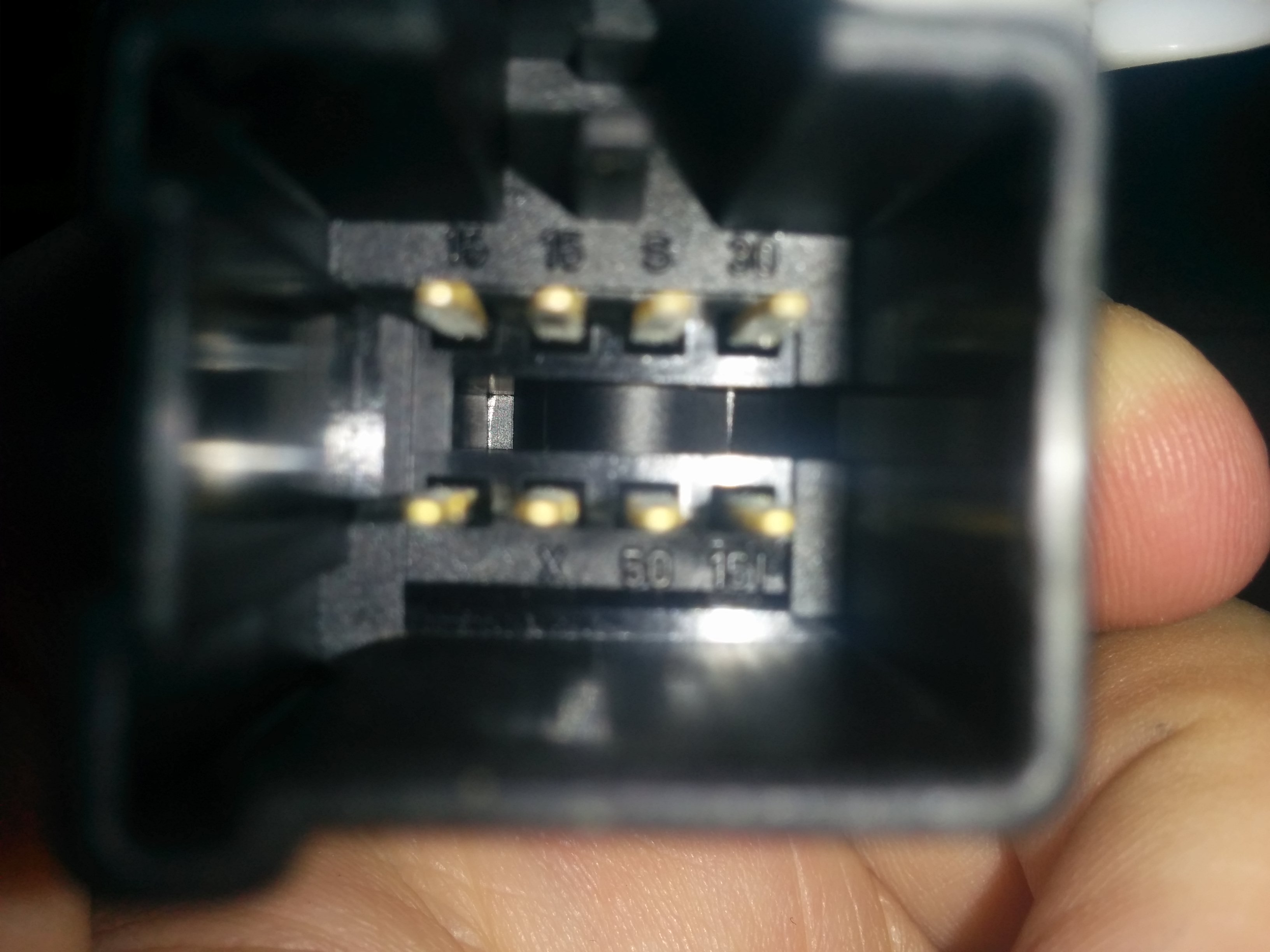

'99 V70 XC AWD 2.4T with 'high' chassis number -- New ignition switch.
Turns out Advance Auto sells Intermotor part # CS1054 which when you open the box - is a GENUINE VOLVO IGNITION SWITCH P/N 9459503 with an 8 pin connection. A welcome surprise. It also comes with two slightly longer Torx machine screws which are required as there was a small modification in fitment. I believe they're 2-4mm longer.
The date stamp on my existing switch was from 98 - which makes it the original. It was replaced due to it intermittently shutting the car down while driving - almost always in a turn or on an incline.

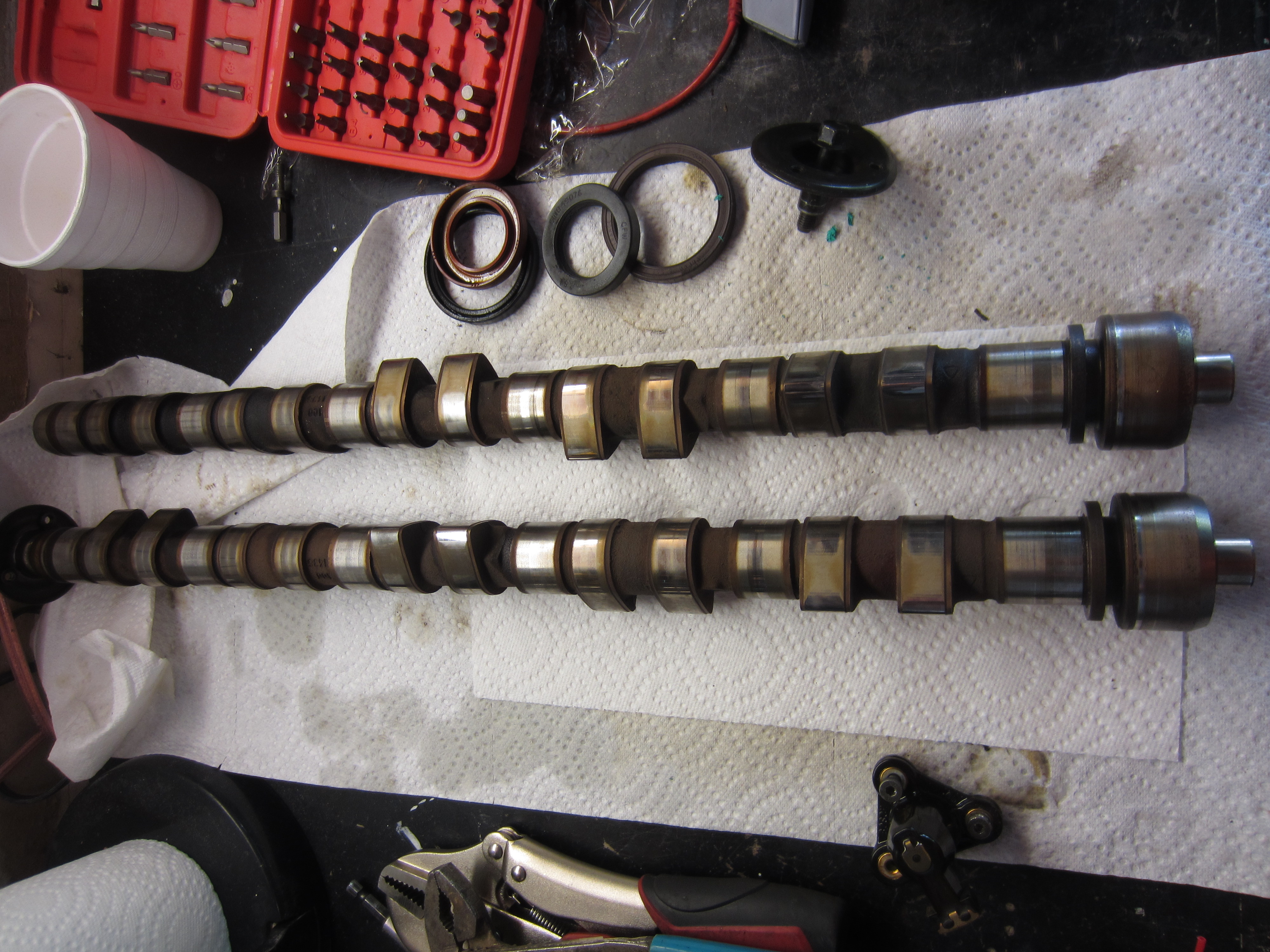

Picked up a set of N/A cams! I'm hoping to get a tune, turbo, and injectors for this thing soon so I can put these in.
