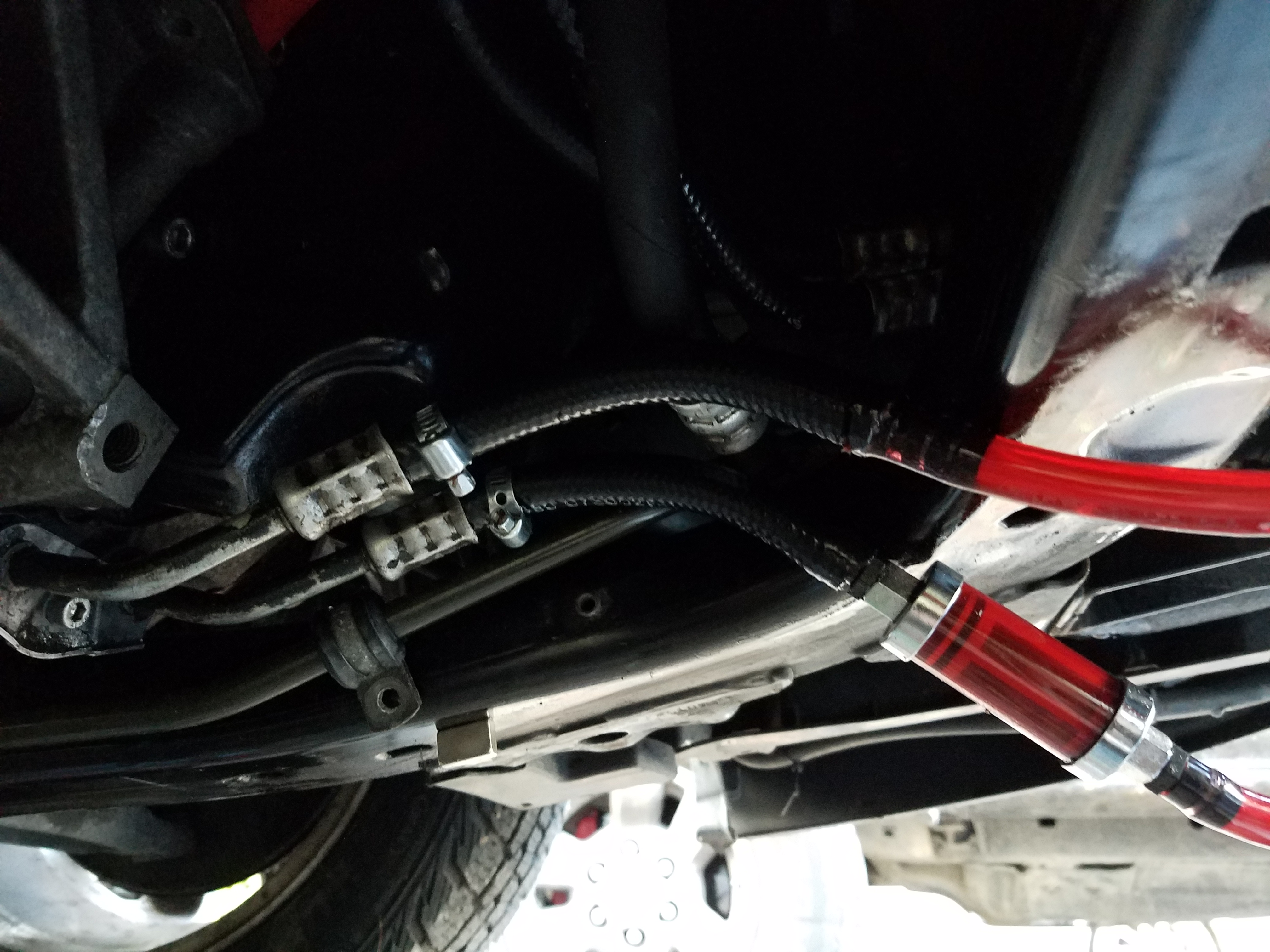

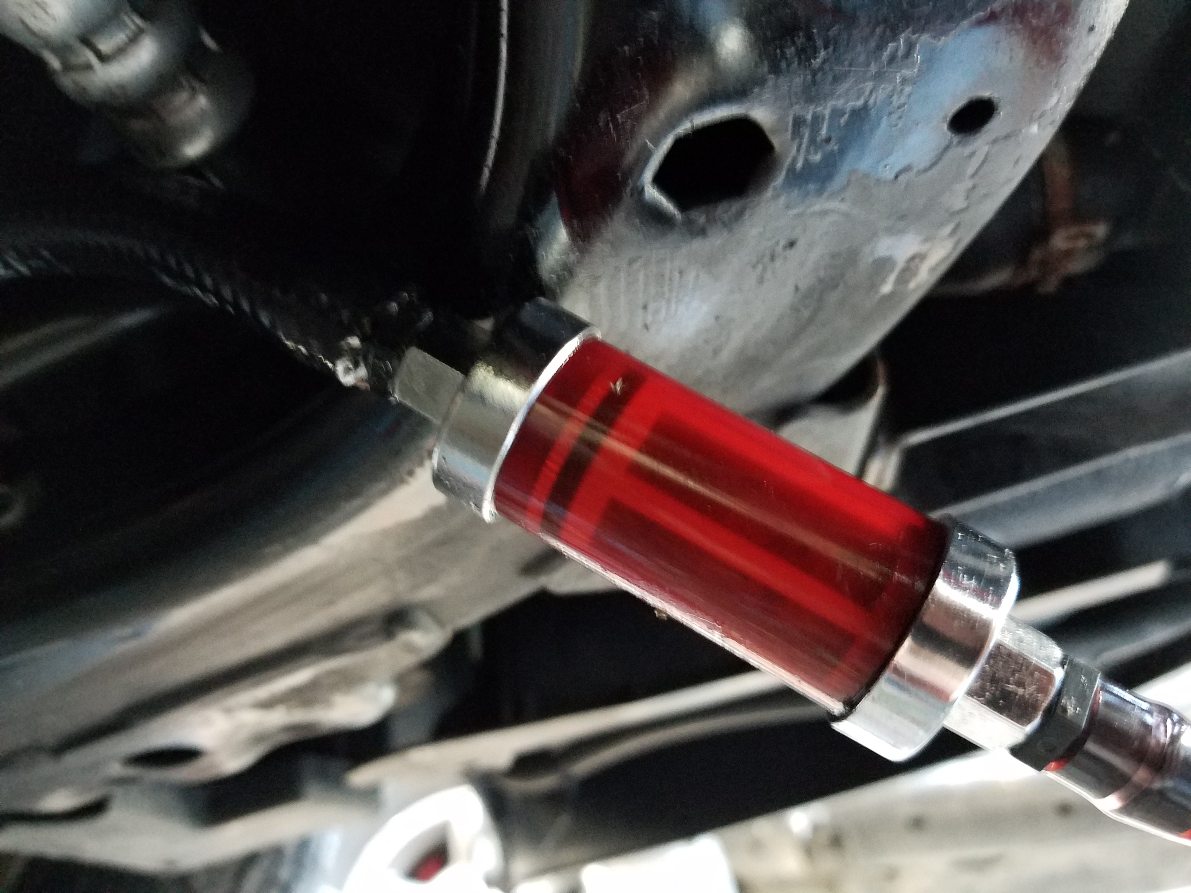

I have a clear filter trap in line with the Saab 9-3 SS (2003 model first year of that design). I will take photos of the debris it collects.

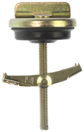

Someone recently had this little gem installed at a jiffy lube after a stripped sump thread. Looks so clever.

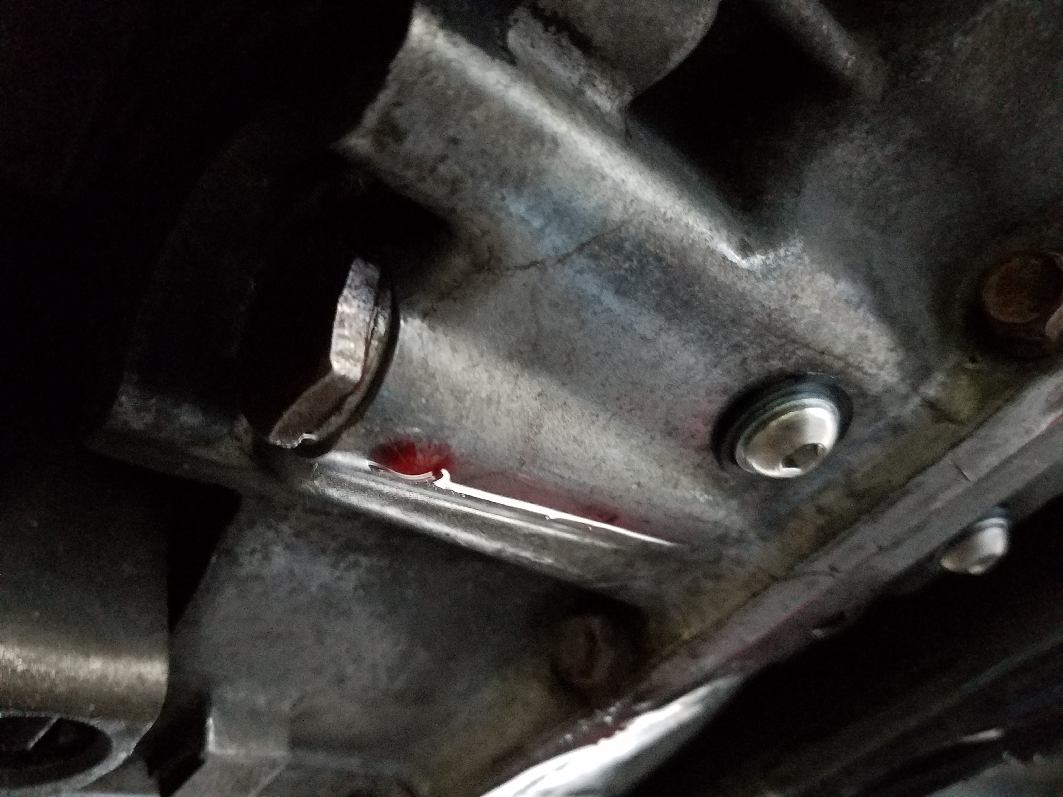

As promised. I drilled a 6.7 mm hole right under the transmission filter inlet at the bottom of the bell housing. Punched at least one hole into the filter and could tell when a bunch of fluid started draining out. Then I tapped the hole with an M8x1.25 mm. Then I ran a half gallon of fluid out the hole to try and flush any aluminum chips out of the sump. I used a stainless steel M8x1.25 mm bolt with a large washer and a neoprene washer to seal it.
You can also see my inline filter with the transmission cooling lines.
