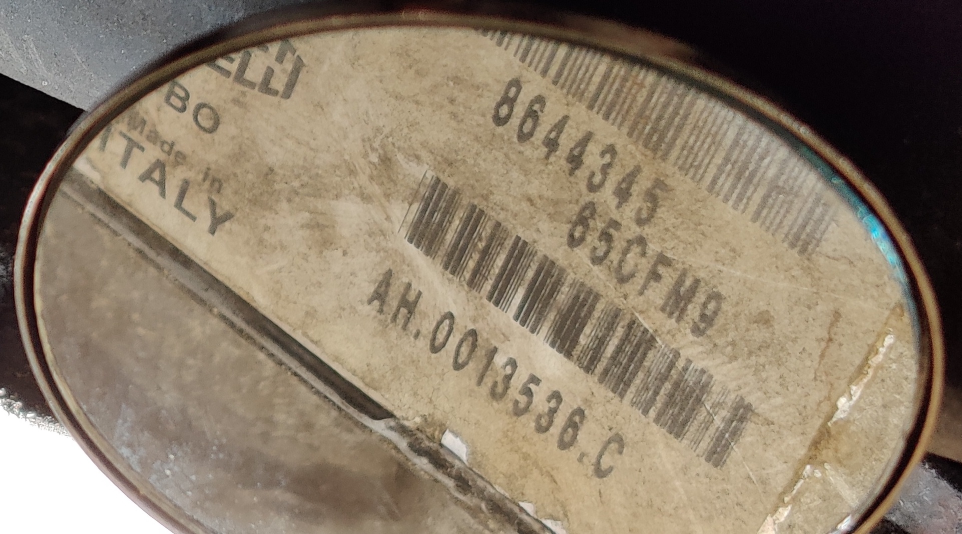

If you remove the ETM for cleaning, pls post a few photos including Part Number.
If I can find it at my local Pick-N-Pull junk yard(s), I will remove and ship it to you for testing.
There is no warranty that it works but I will try my best.

I didn't remove it, but I used my trusty mirror, and camera on my phone, to get the numbers off of the ETM.cn90 wrote: 31 Aug 2020, 17:31 If you remove the ETM for cleaning, pls post a few photos including Part Number.
- Posts: 8360
- Joined: 31 Mar 2010, 09:54
- Location: Omaha NE
- Been thanked: 504 times
Yeah,
This is my suspicion all along. The infamous "Volvo Magneti Marelli".
Do a google search: "Volvo Magneti Marelli"...
