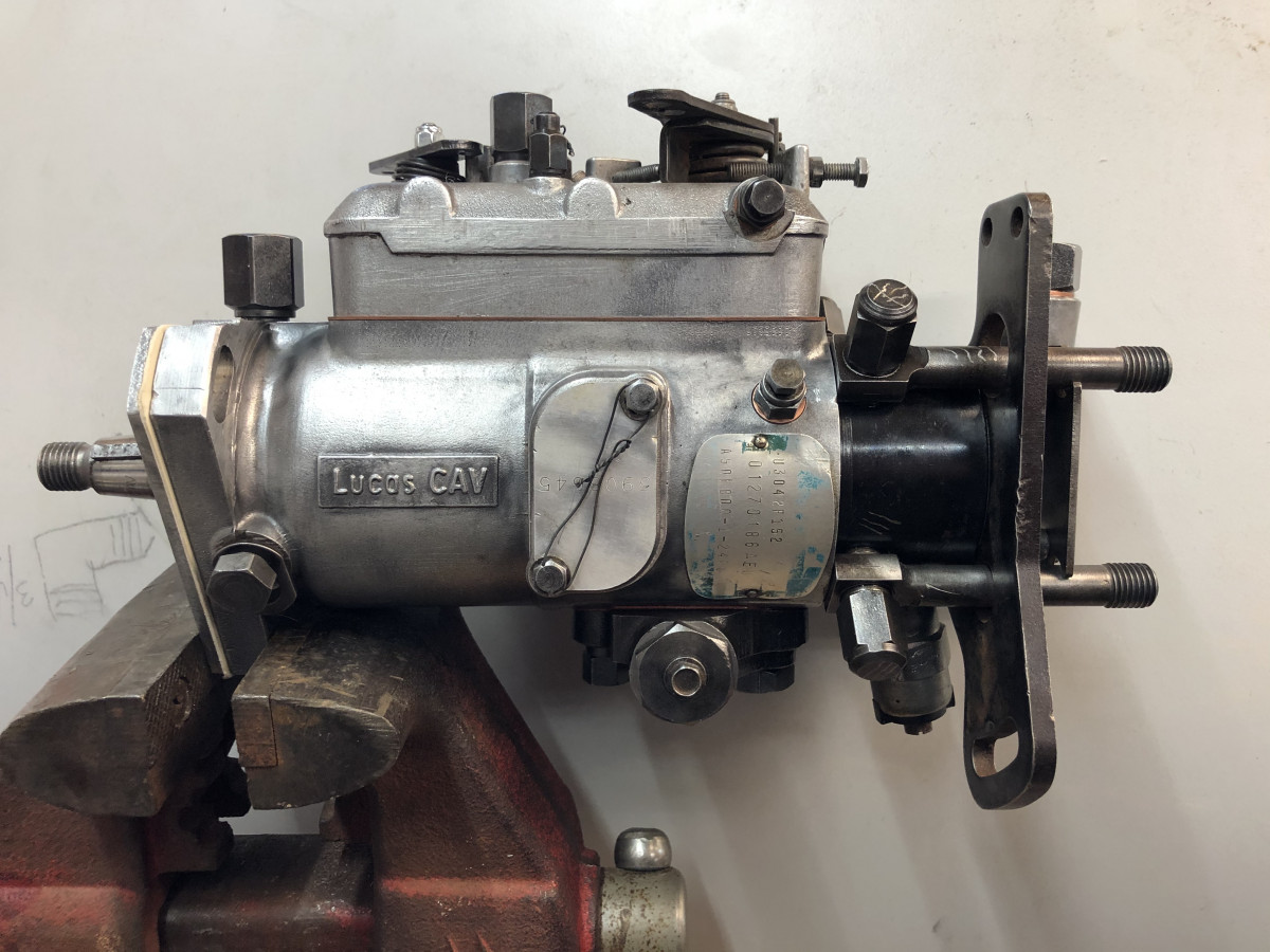

My Diesel engine won’t start and I think it’s because the injection pump isn’t developing sufficient pressure. The pump is a Lucas CAV DPA-type diesel injection pump.

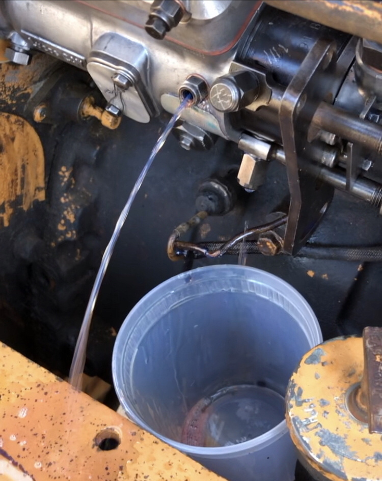

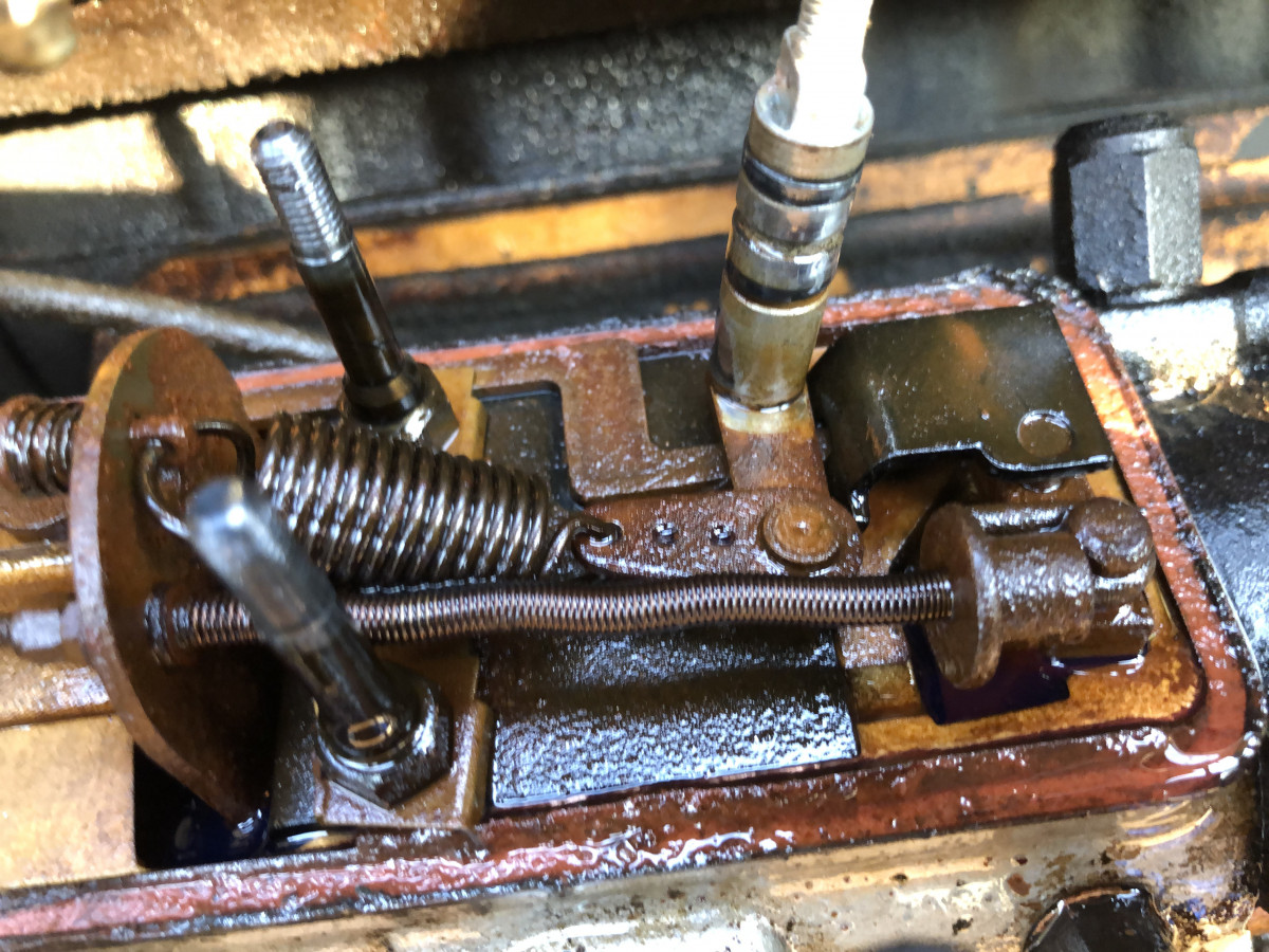

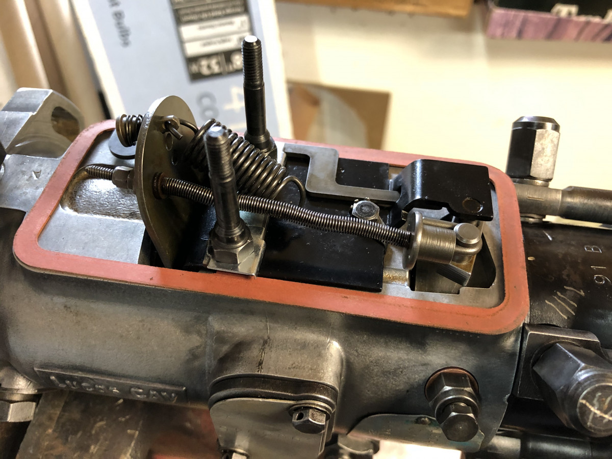

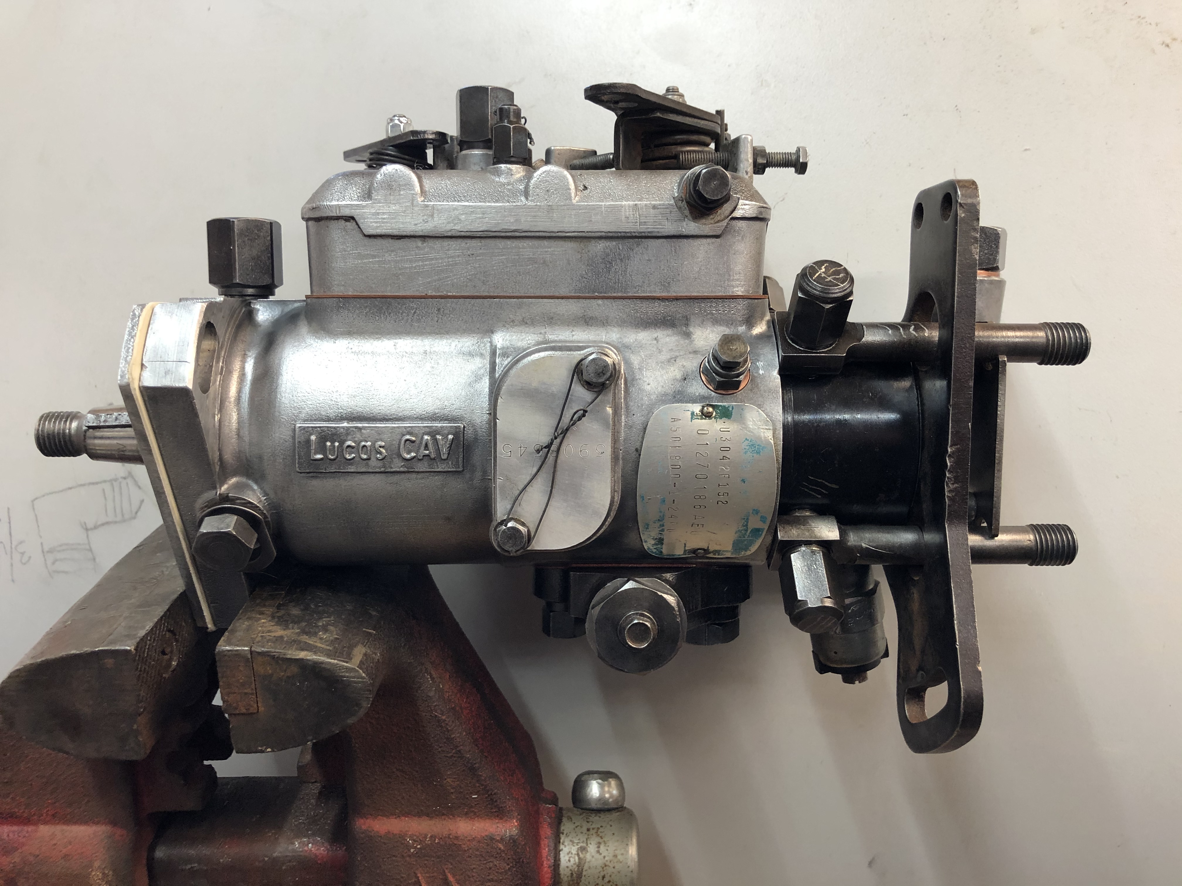

I bought the re-seal kit, totally disassembled it , cleaned it (it was filthy), replaced all O-rings, washers gaskets etc and reassembled. It works as before but just not enough pressure. When I crack a high pressure line fitting to the injector , fuel seeps out but doesn’t “spit” out indicating high pressure.
I need to further diagnose the source of the issue before I send the pump off for an expensive repair or I attempt further to fix it .
Does anyone have experience fixing these diesel injection pumps?
