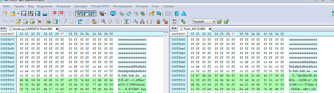

Key for crypto EepromRickHaleParker wrote: ↑09 Oct 2021, 20:12Be nice if some other people that can code where to jump in and contribute. VTL is carrying almost if not all of the load now.
