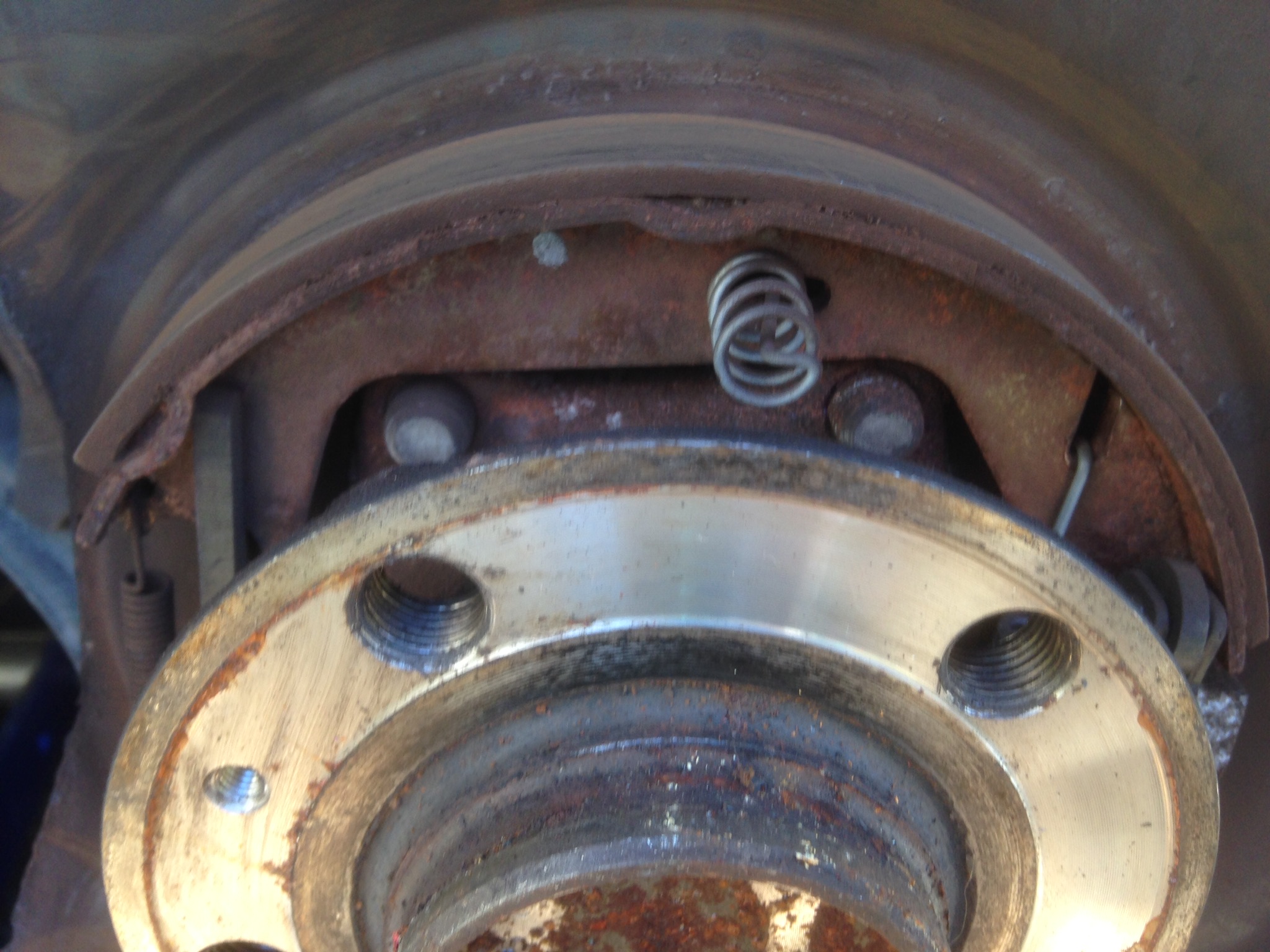

New rear rotors and pads on Catherine the 2005 M56
Zimmerman rotors
Bosch pads
Pushed 350 ml brake fluid through each caliper
Parking brake shoes were fine so I left them in. The P2 parking brake adjuster is great, 10 mm from console.

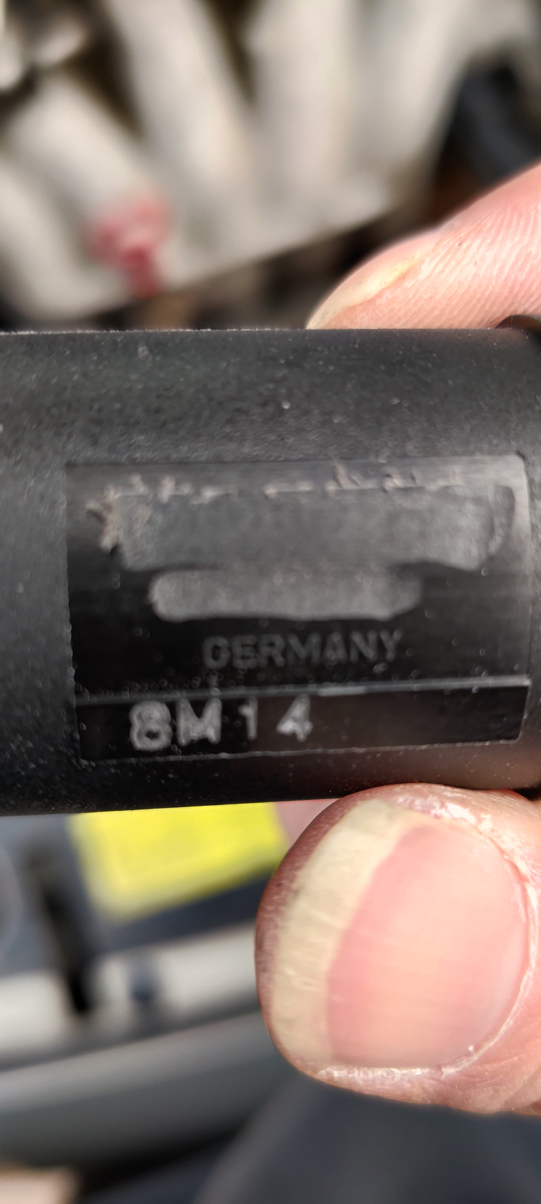

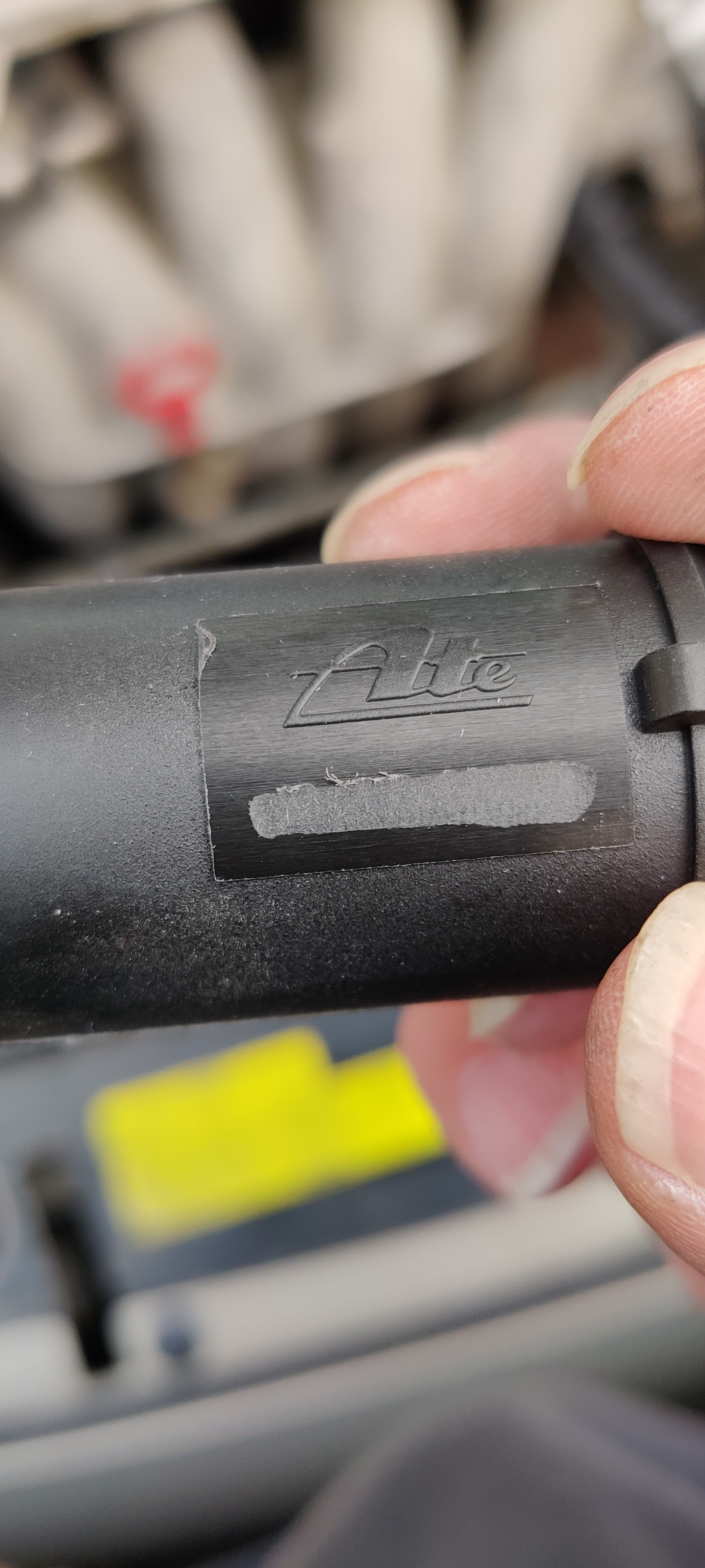

Put a new ATE brake pedal position sensor in from FCPEuro. Took longer than it needed to. Note to self, and possibly others, don't put dry things into dry holes. I tried for almost an hour to get it to snap into place with no luck. Put a very little amount of Vaseline on the seal and the ear where the ring slides into place on the sensor and it snapped right into place.
Cruise control works perfectly now, and now more service engine messages popping up while driving, so well worth the $80+ for the new sensor and cheaper than the one that says Volvo. I can see that it's still the genuine part, but without the extra cost of having it say Volvo (although if you look hard enough you can still read it on the new sensor).
