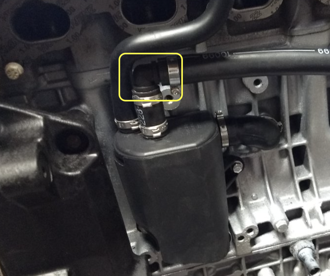

Reviving and older -- but excellent -- thread on PVC modifications to ask...
I'm about to tackle this job on my 97 855 and I am going to use the Parker Push-Lok 836-10 fuel line hose, 5/8" (16mm) diameter, instead of the official Volvo line that cracks. Any recent updates on how this mod has been performing for those who have done it? Thanks.

We have it done on both of our cars. Did them both about 3-4 years ago. No issues for us.jreed wrote: 09 Dec 2021, 05:32 Reviving and older -- but excellent -- thread on PVC modifications to ask...

What did you use to make that hose from the oil trap to the top of the cam cover?Chuck W wrote: 09 Dec 2021, 16:16 ... We have it done on both of our cars. Did them both about 3-4 years ago. No issues for us.

That's just an off-the-shelf part. For some reason they're different, but I can't recall why. One comes up between #1 an #2 and the other between #2 and #3.erikv11 wrote: 09 Dec 2021, 16:45

Ah ok, thanks.Chuck W wrote: 09 Dec 2021, 17:28That's just an off-the-shelf part. For some reason they're different, but I can't recall why. One comes up between #1 an #2 and the other between #2 and #3.erikv11 wrote: 09 Dec 2021, 16:45
I thought the difference in those two was because of where the FPR is located, but then again I also thought it was more clearly connected to NA/turbo differences. Obviously that last point doesn't hold up for your two cars.

Great looking installation... an inspiration for me. What is the 90 degree fitting in the main line (circled in yellow below)? What material and where did you source it please?
