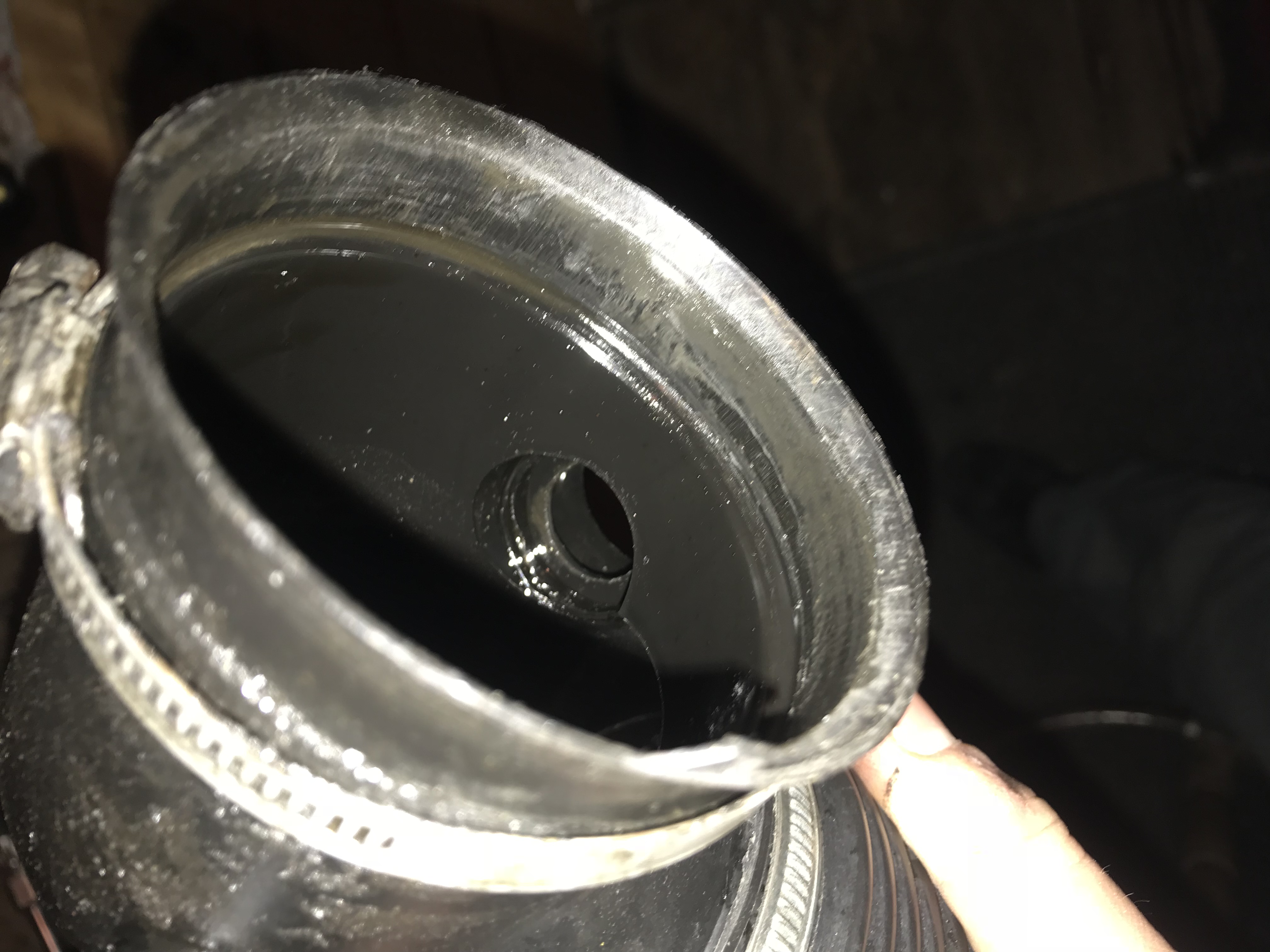

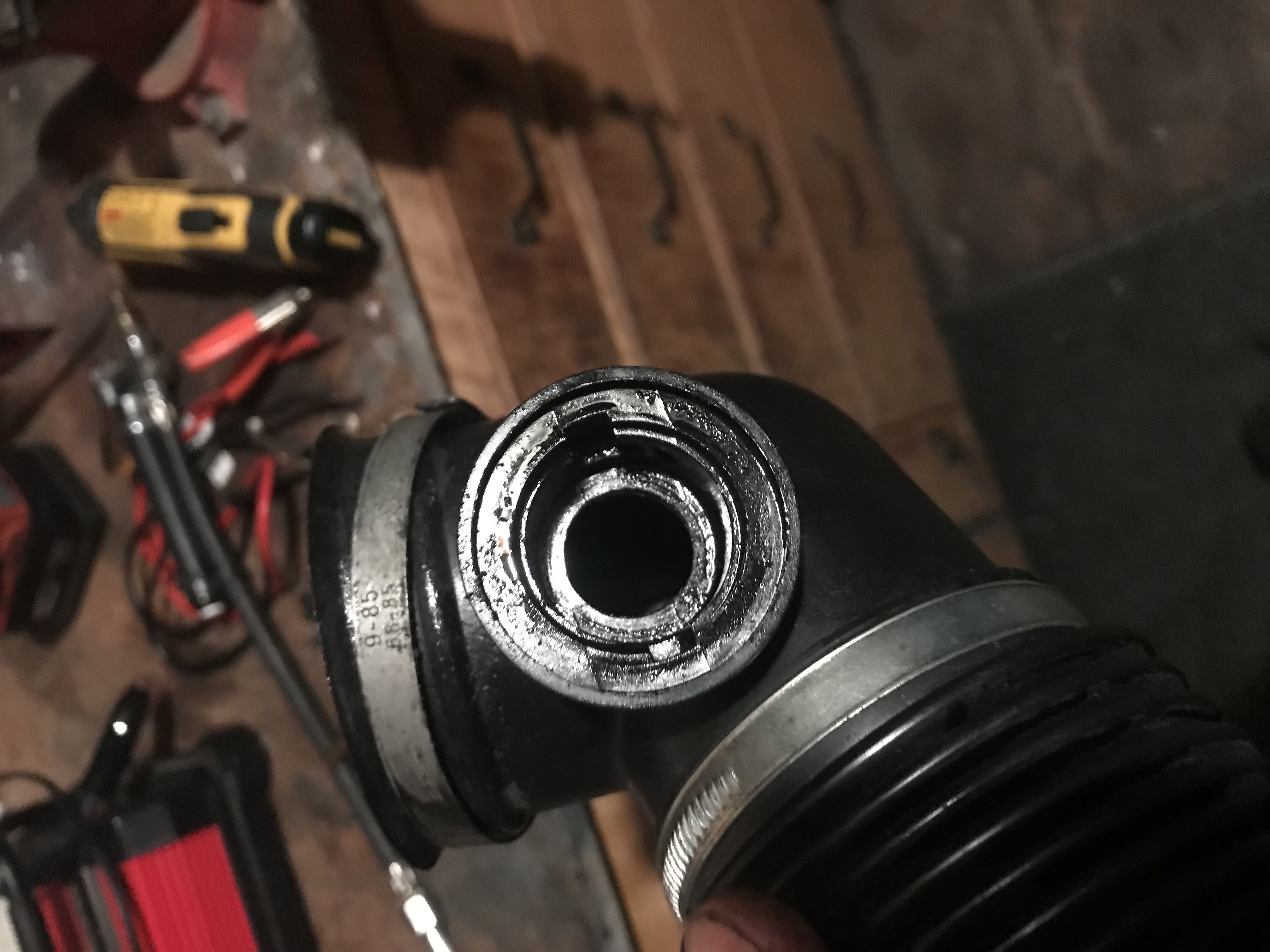

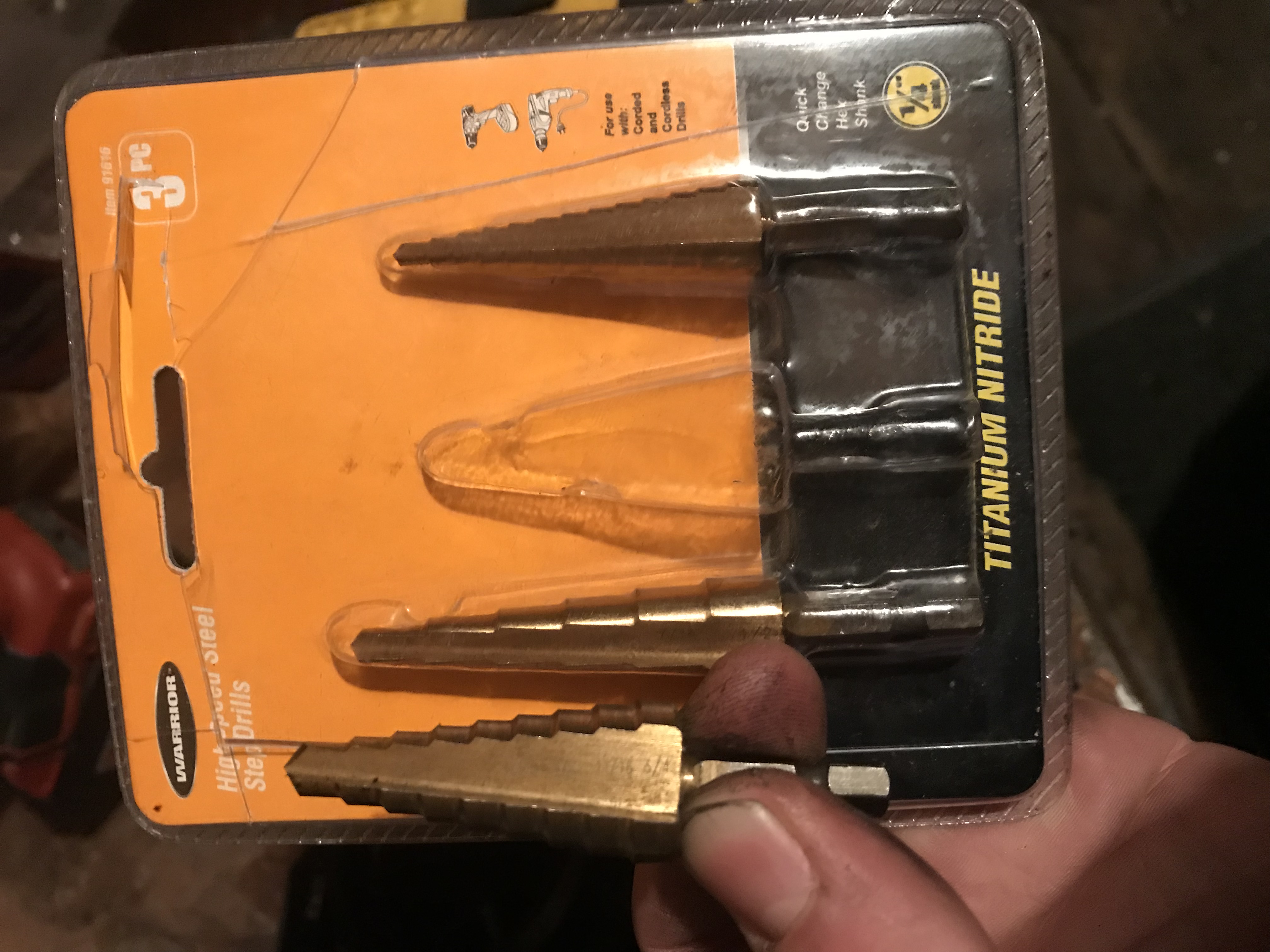

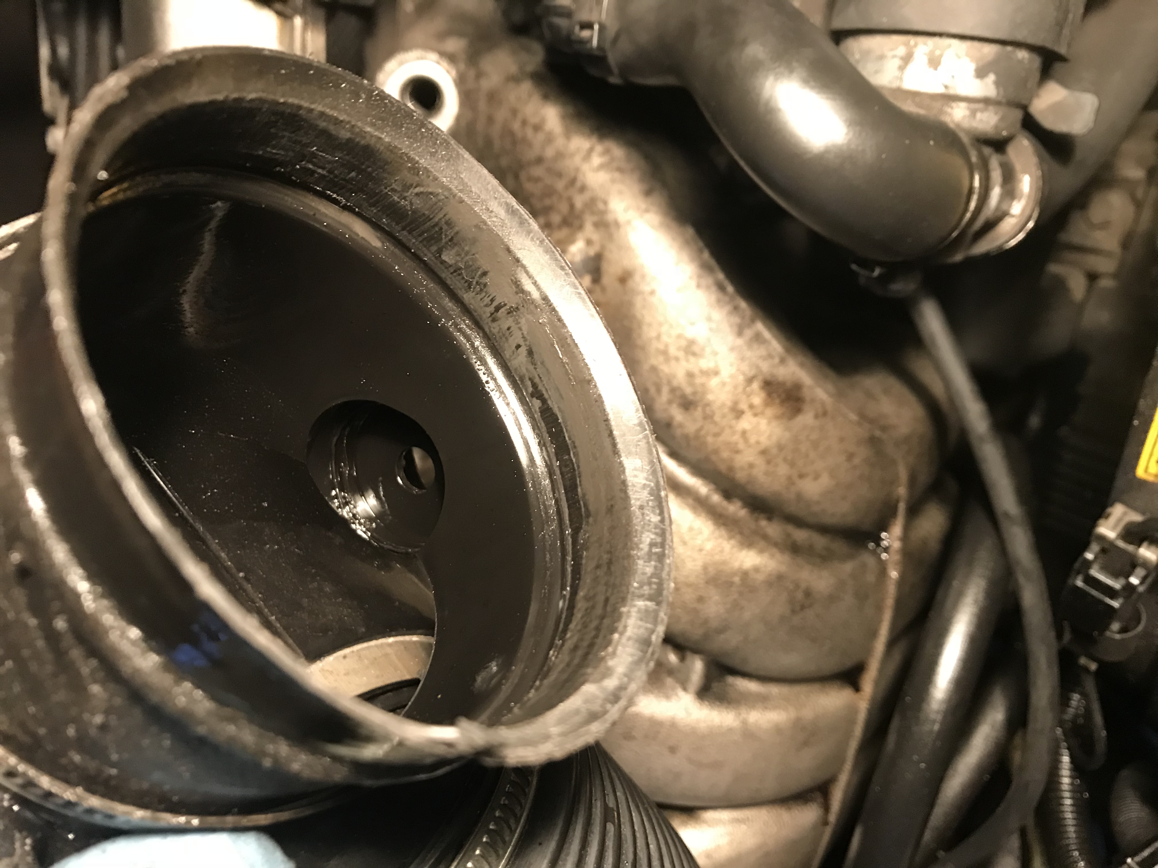

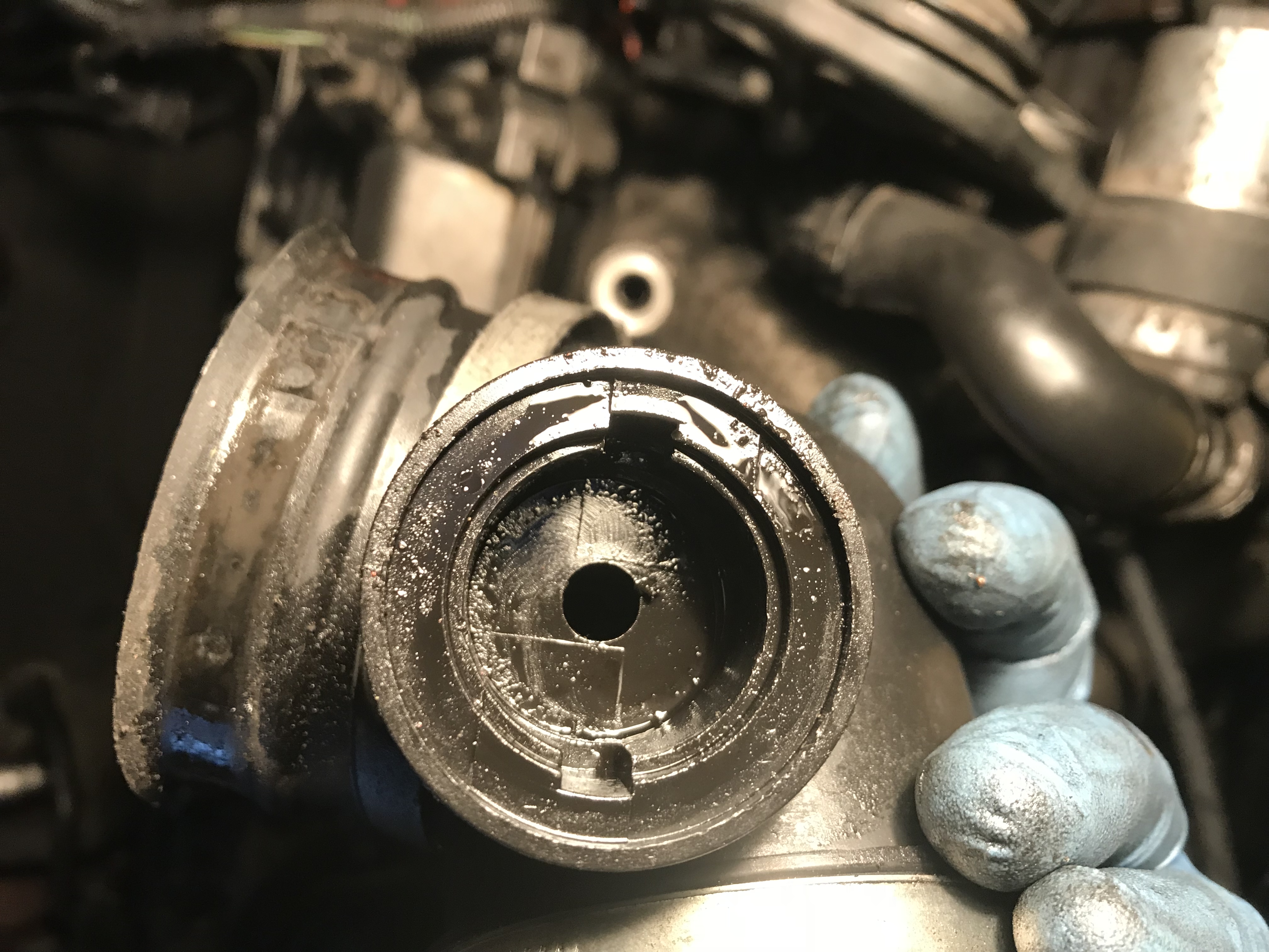

Great writeup! Thank you! I don’t know if anyone pointed this out already, but something I’d like to add for the N/A models is an additional small modification where the heater hose goes back into the intake. I noticed that the intake piping that attaches directly to the throttle body has another point of constriction. I’ve added some pictures of what I’m talking about. I used a stepped drill bit to widen the hole and allow the proper airflow.
Posts: 35278
Has thanked: 1500 times
Been thanked: 3812 times
The PTC nipple is a maintenance item that should be cleaned every 60,000 miles. If it is plugging up faster than this, you have blow by or a badly slugged engine to address.
Changing the size of the hole is changing the balance of the vacuum from the intake manifold on overrun, and the snorkel during boost operation.
