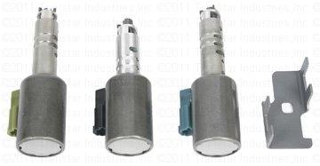

In this video you can see I took the back of each Linear solenoid off and reamed the bushings at work with a 4.00 mm reamer. Then I put 6 holes on the back of the solenoids sheet metal cover and then crimped the covers back on. You can buy after market solenoids that have this self cleaning cover on them. I made my own as I have access to a machine shop at work. Look closely at the aftermarket solenoids and you can see they cut holes in the edges of the back sheet metal cover and allows fluid to pass through the solenoids and "self clean" the solenoid.

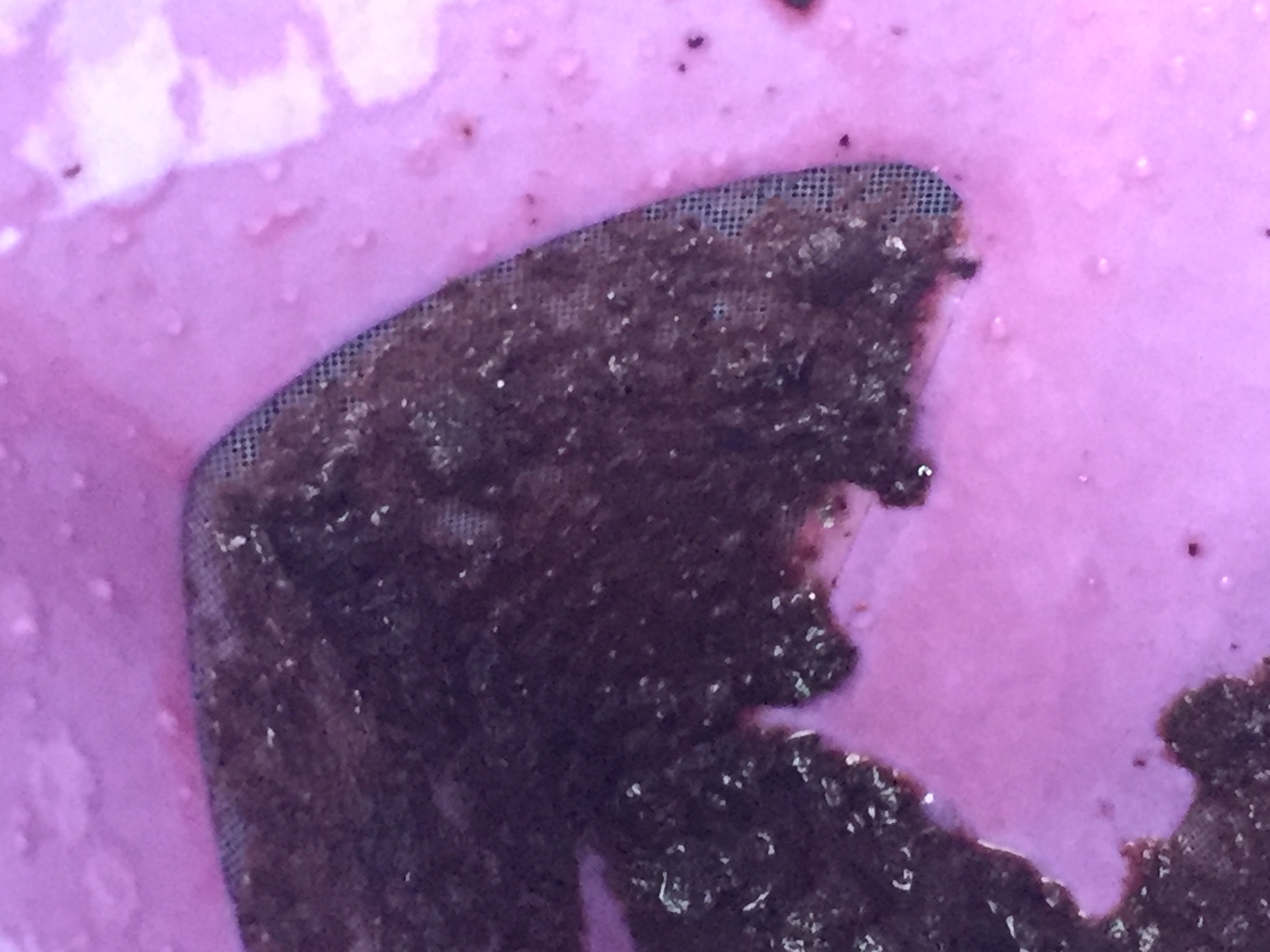

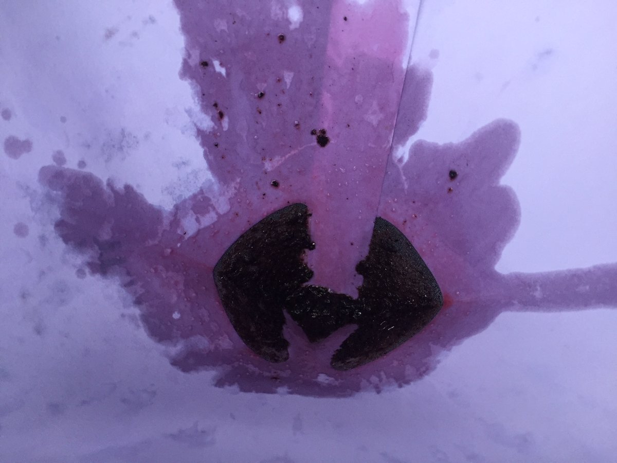

Just drained the ATF again last night and punched a few more holes in the internal filter. I found some "stuff" on the skewer when I pulled it out. Then I refilled the fluid reusing the old (but still really new 25 miles on it) Mobil 3309 and when pouring it back in I see that I must be breaking the stuff up that's on the filter. The paint filter I used to filter the fluid has this stuck on it after I poured the last quart in. YUCK!
Take a look at the stuff.

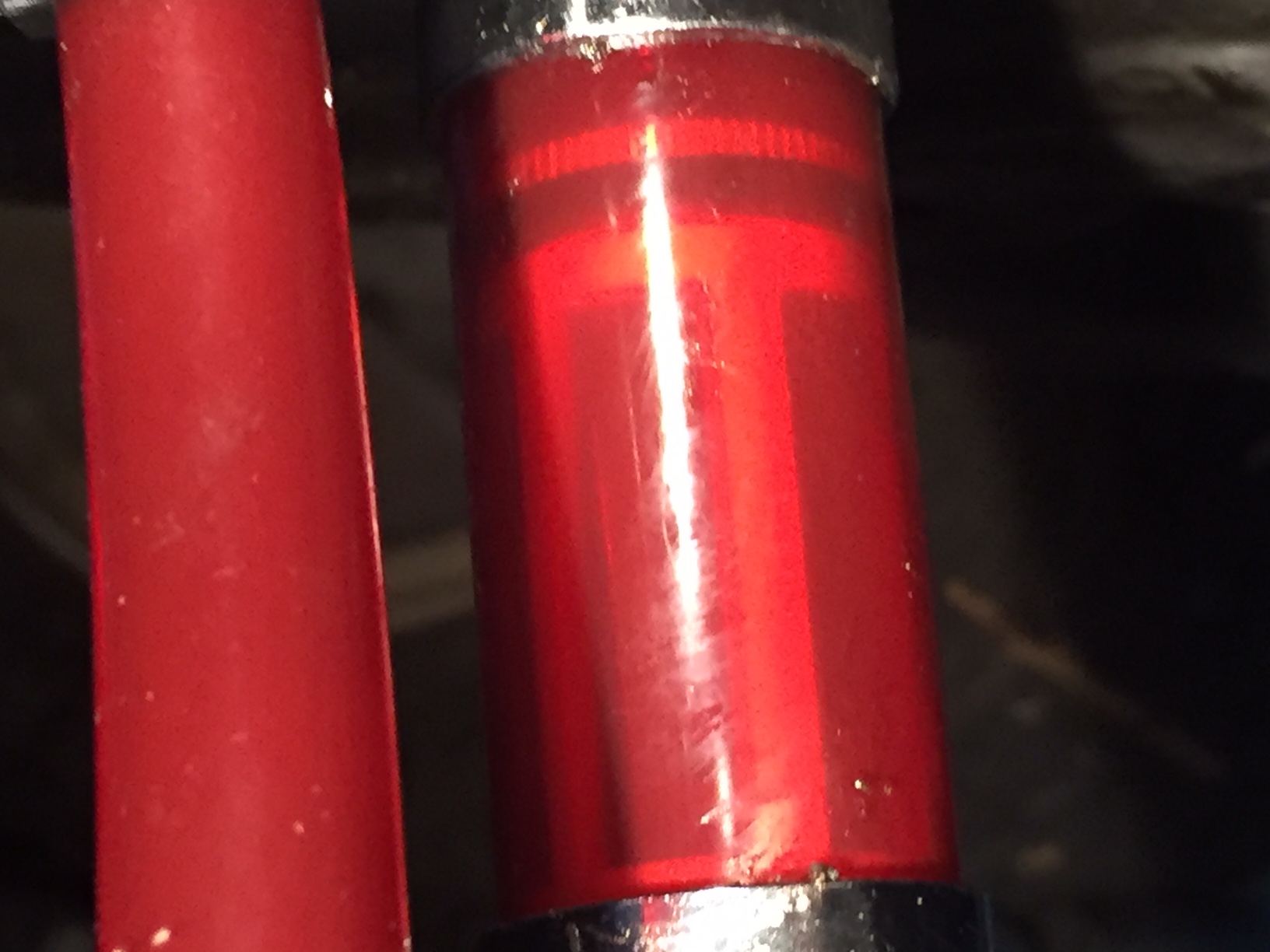

I'm back to running my inline filter in that has a clear material so I can watch it.

What kind of inline filter is that? Would be neat to be able to tell when it's time to change by looking at it like that

We were discussing how to clean these filters in this thread. After seeing that crud I'm convinced the filter MUST be bypassed.
