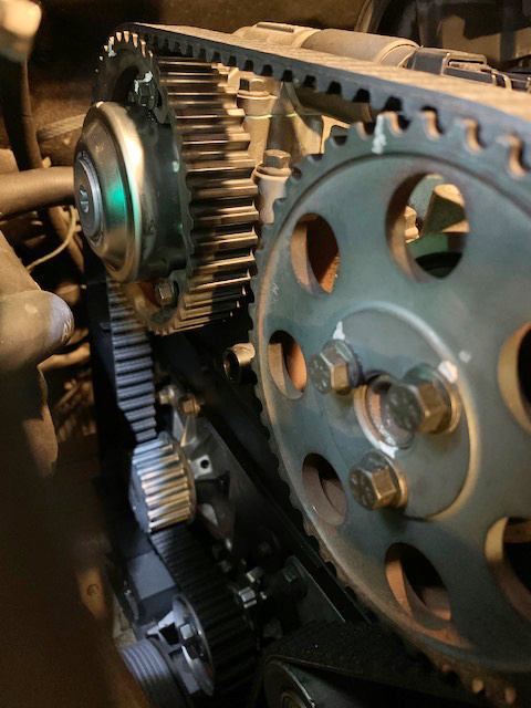

Here is a DIYer view of vvt service.
  • the rotational movement of new vvt along the belt is smooth with zero resistance, the old wobble a little and you can see air bubble in the oil cavities and spaces.
  • the vvt ring that seats over the camshaft and mates with seal moved in and out (clicking) with little more play when comparing with the new one
Both front seals were letting oil o. Old intake seal moved inward with little push -- pulling it out was no effort at all. The exhaust seal leaked where its inner mated with vvt -- it too came off without much effort. It wasn't a flood like leak, but a slow leak of oil.
I'm not hearing resonance at 1200-1400 rpm.
I'm happy to clean it and ship it to anyone interested for their science project.

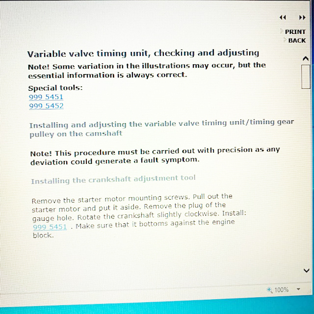

Meanwhile, ours is back on the street today. I think, it is worth reading VIDA for specific model year and comparing hands-on notes for the first timers like me. Pete's help with getting timing marks back by-hand was priceless.
Eerily quiet and motionless after a weeklong theatre:
