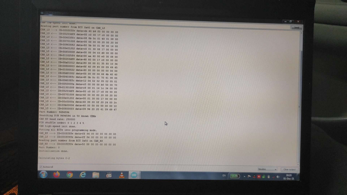

Yesterday I tried to read the PIN from the CEM module with the 1999 S80, but without success. A screenshot has been posted where it stops.
CEM P/N: 9494594.
Am I wrong somewhere or is it impossible to read the PIN via OBD?
CEM P/N: 9494594.

9494594 is a CEM-B. VTL has not figured out how to crack the CEM-B yet ... its a tough nut to crack.urosm wrote: 02 Dec 2021, 04:07 CEM P/N: 9494594.
CEM-B also requires the K-line hardware on the cracker if you are cracking in car through the OBDII port.
If the CAN-HS and CAN-LS is attached to the back side of a CEM-B the K-Line is not needed, providing that VTL has the code ignore the K-Line if communication with a CEM-B has been established.
Use the [PrntScrn] ( Print Screen ) key on your keyboard then look in Pictures\Screenshots\

Yes, P2 -04 needs K-line keep alive messages, even on the bench. I wasn't able to crack one, the pin compare routine has a "defect" that hides the pin mismatch latency.

Have you tried disabling the K-line function and tapping the CAN-HS & CAN-LS on the pins that go to other control modules rather then the pins that go to the OBDII connector? My understanding is, you only need the K-line Stay Alive to keep the OBDII port connected to the CEM. Thereafter you can communicate on the CAN-HS or CAN-LS. The other control modules never disconnect from the CEM. They are always alive.vtl wrote: 02 Dec 2021, 05:12 Yes, P2 -04 needs K-line keep alive messages, even on the bench. I wasn't able to crack one, the pin compare routine has a "defect" that hides the pin mismatch latency.
If I am in error ... enlighten me.
Come to think of it, If I am correct the K-line relay could be pulled and jumped, eliminating the need for a K-line Stay Alive and the extra hardware on the cracker.
