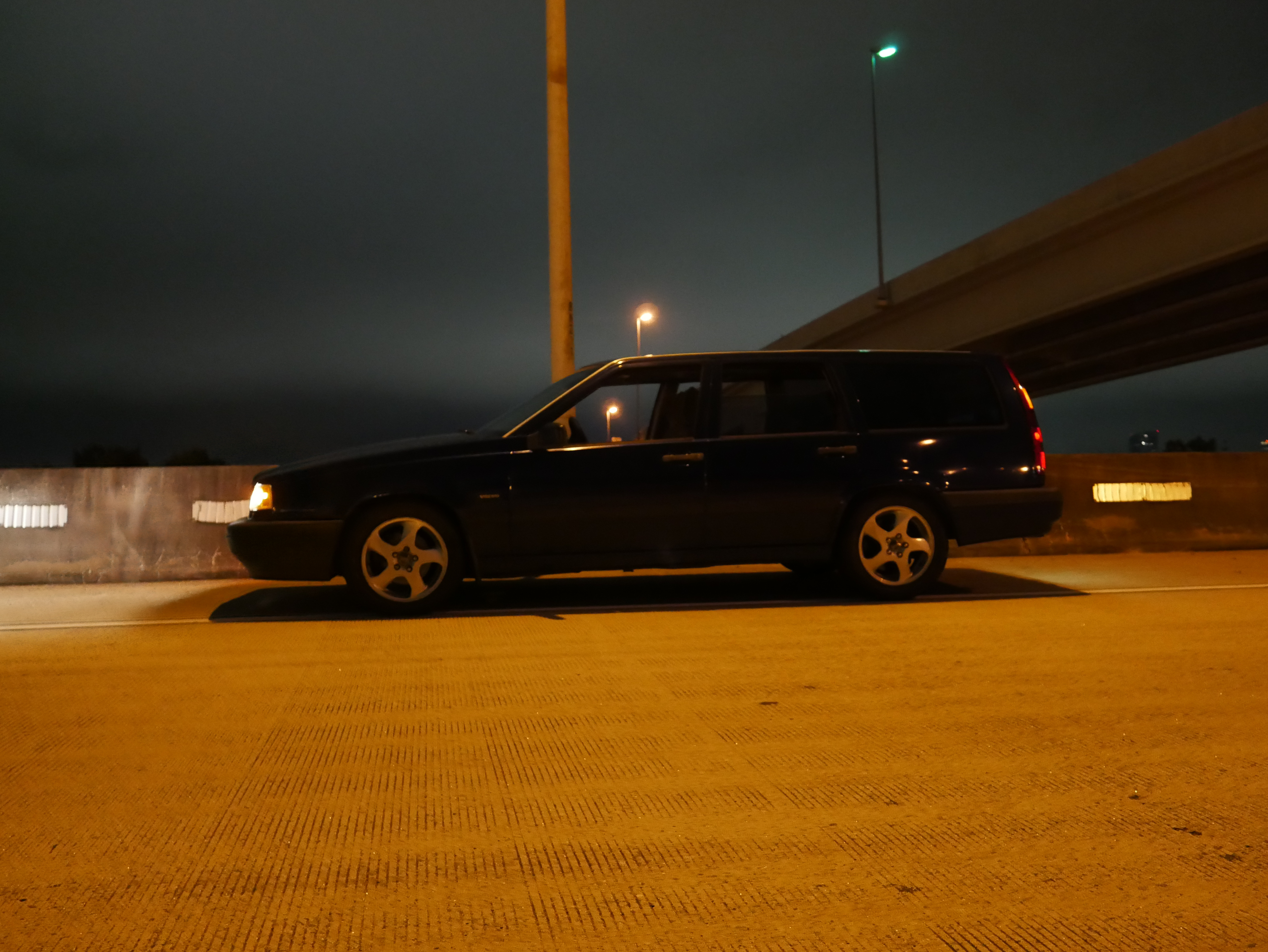

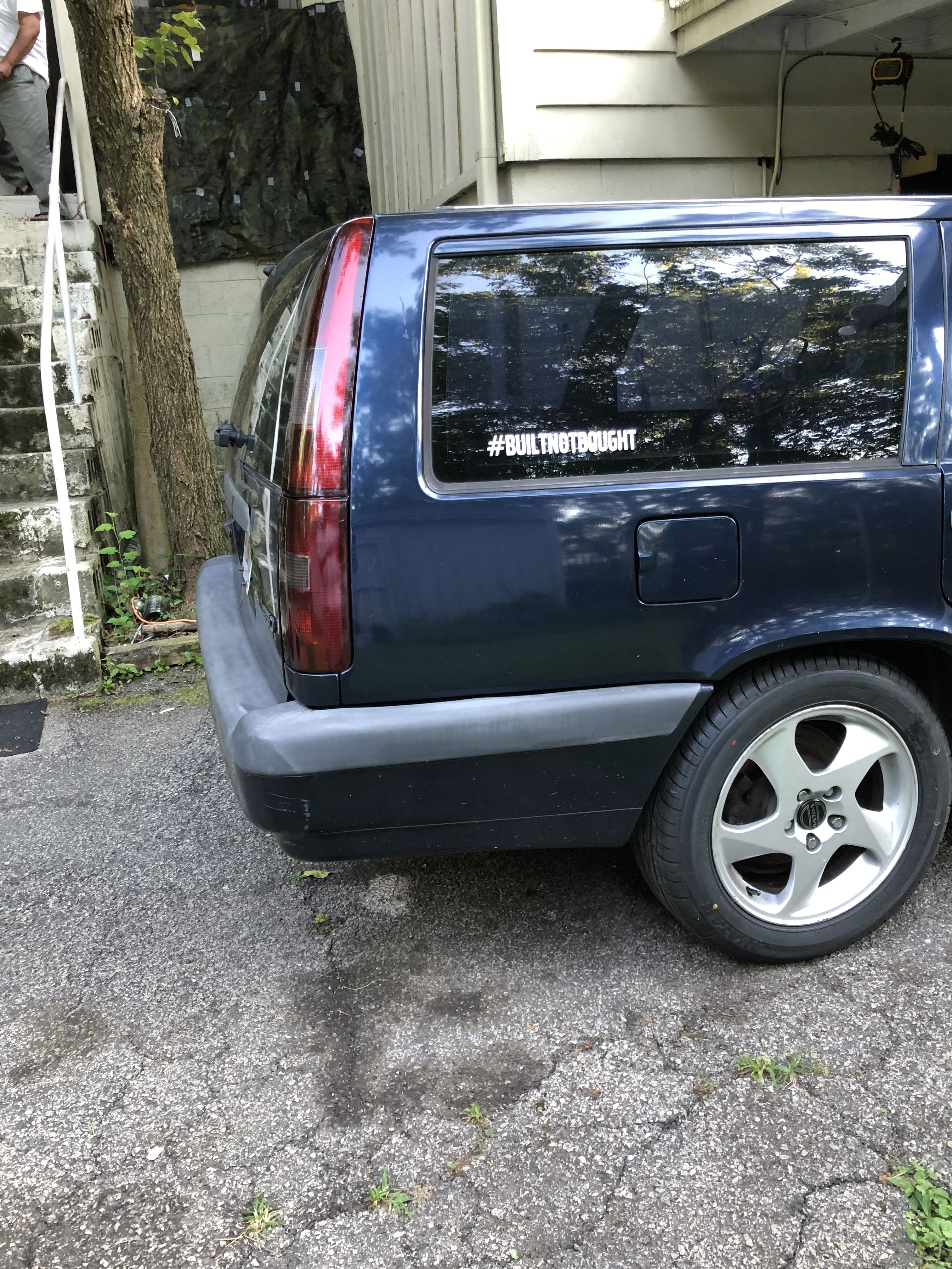

and now for pictures:
I feel like I'm forgetting to say something, but then again I always am. I would love to hear your comments and suggestions!
