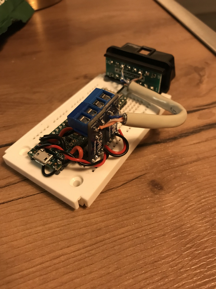

Well I gave it a few more tries but gave up due too the low temperatures around here.
It was actually kind of nice to have the dialogue and type in some numbers to shorten the time. However I think just as vtl said that I might still have a hardware problem.
Is there anything I can improve here? Of course I added the gnd between OBD and Teensy.
If not I will have to get some CF160. Maybe somebody here in Europe who got some laying around? :)
2004 - V50 T5 AWD M66 - Flint Grey
1996 - 850 T-5R M56 - Dark Olive Pearl

Do you still see/hear car glitches, like clicking relays?

No not any more. The cracking process is running fine and the deviation is not so big anymore like I said but it’s still lacking the consistency. Pretty sure about 28 being the first but you all made me insecure about that again :D

Collect the logs the next time? 3 runs, up to and including third byte.
Also what's your VIN voltage on teensy?

Sh4rp wrote: 11 Jan 2022, 15:46 If not I will have to get some CF160. Maybe somebody here in Europe who got some laying around? :)
If you cannot find some Bosch CF160s in Europe Look for NXP TJA1048 which is a third generation, 5V, dual high-speed CAN transceiver in a self contained package. You need only one. Data rates up to 5 Mbit/s. VIO input allows for direct interfacing with 3 V to 5 V microcontrollers.
I am think about getting some an build some plug and play CAN shields for the Teensy 4.0 then sell them. Might get some people that can code but cannot solder involved.
