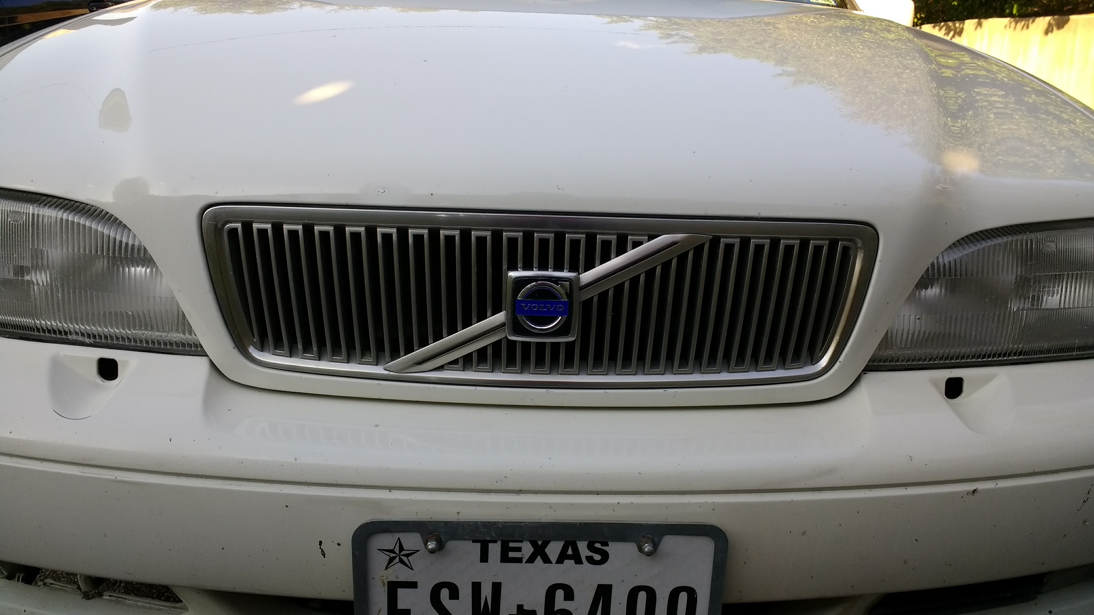

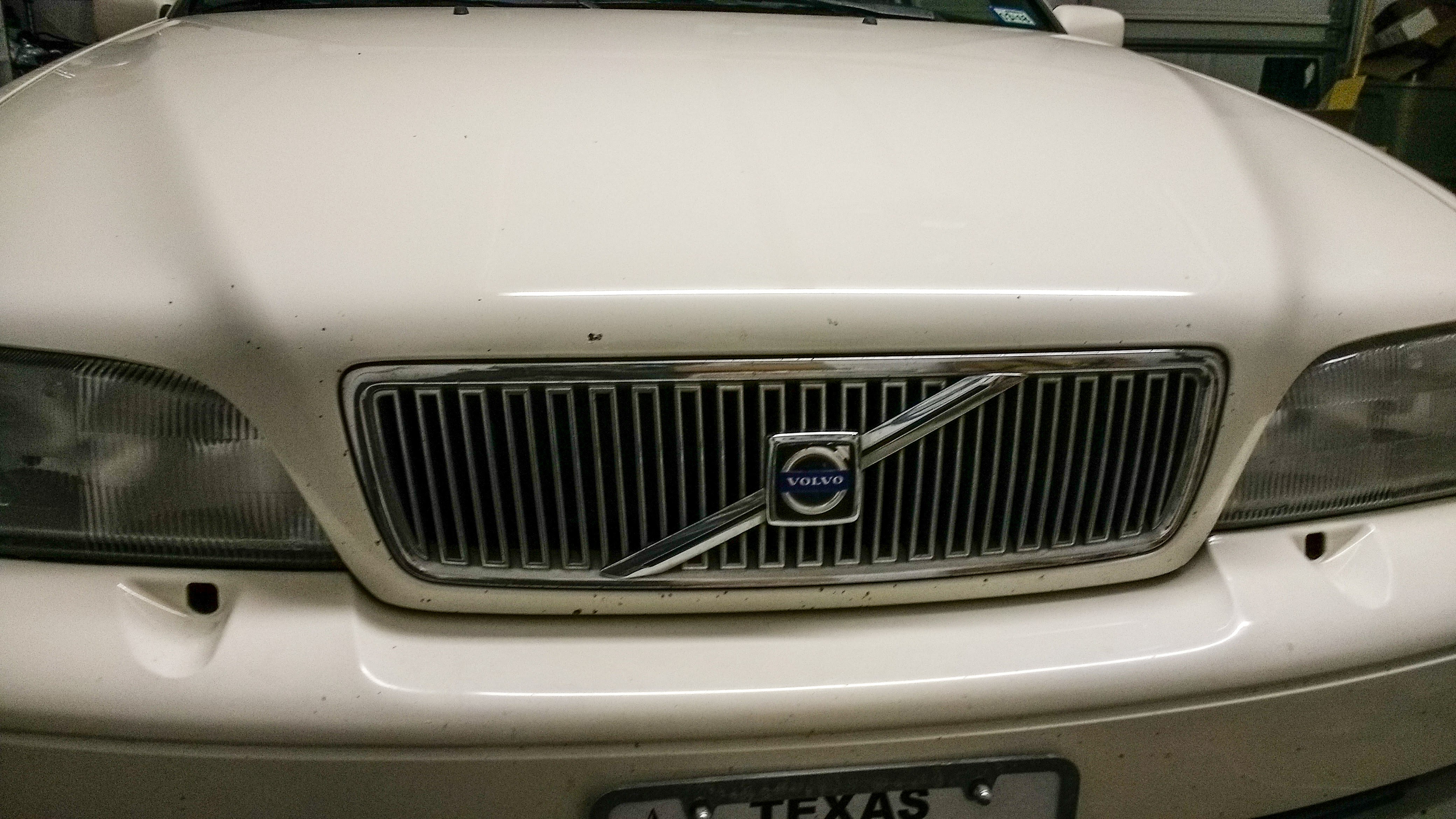

I've put some attention into the rock chips in the front end of my car. Sanded the rust out, applied a thin coat of primer, a thin coat of white, sanded with 2500 grit, and buffed with Meguiar's M105. I have no idea what I'm doing, so I applied too much primer; when I sand the repairs flat with the surrounding paint, I wear through the white paint and expose gray primer, which sits at the same height as the factory clear coat. You can see that in the dark spots around the grille (though one or two of those are bug splatters).
While I had the grille out, I sanded it with 400 grit to smooth it out and take out the reflectivity. I was going for a satin silver look, but I didn't really get a uniform finish around the rim. I'll try a coarser grit later, but for now I'm letting the touch-up paint harden and taking care of a few things on my Mercedes.

Looks pretty good! I like the finish on the grille. That might be something for me to try eventually. I just don't want to potentially ruin my egg crate haha.

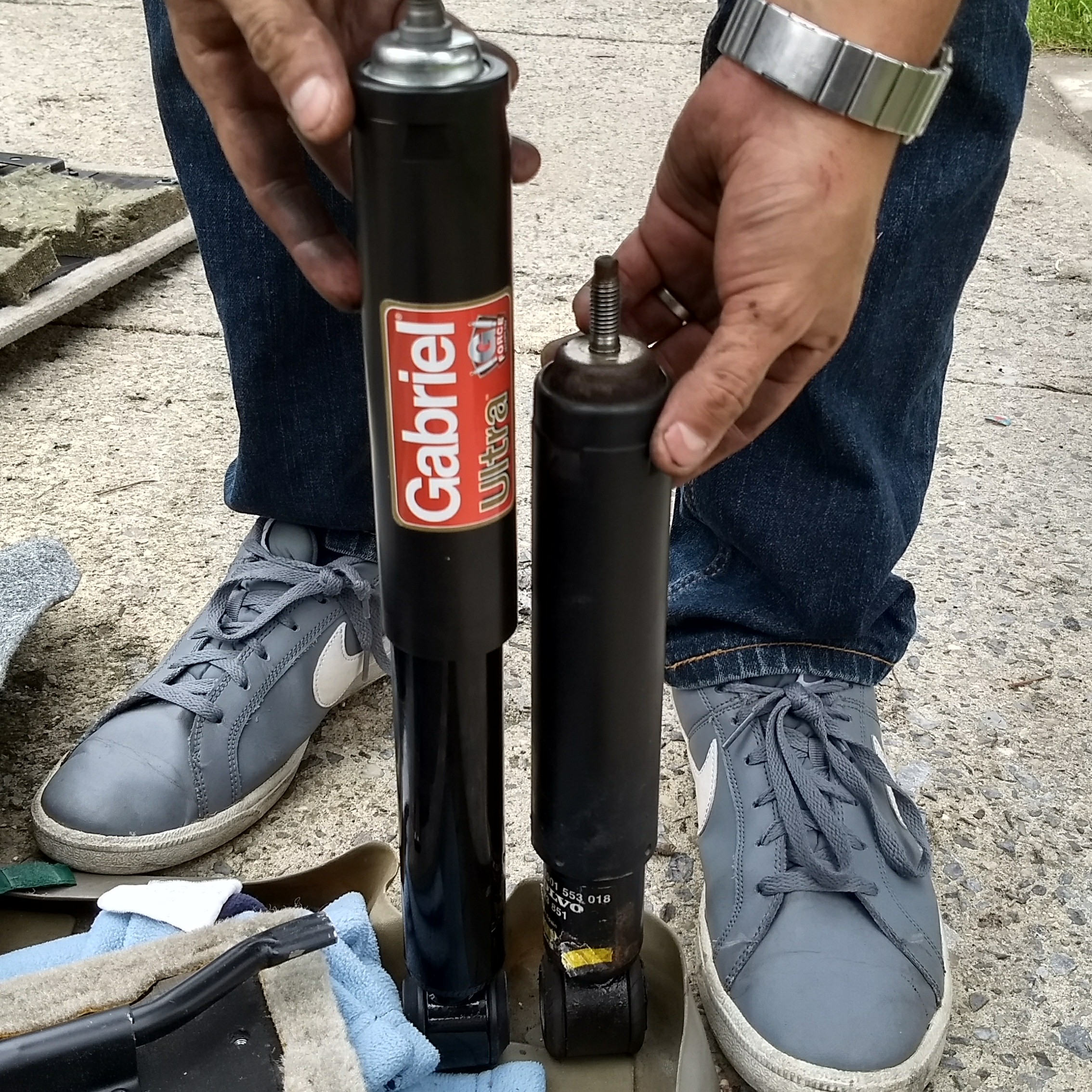

Quite the difference in ride quality!
Only one shock returned to its original length.

I believe it! I remember when I changed out my shocks and struts, made a huge difference from the worn out original shocks and struts that were in there. I went with Monroe on my car because there was a good rebate at the time. I plan to eventually switch to Koni STR.T or Bilstein HD with lowering springs, but I need some Comets first.

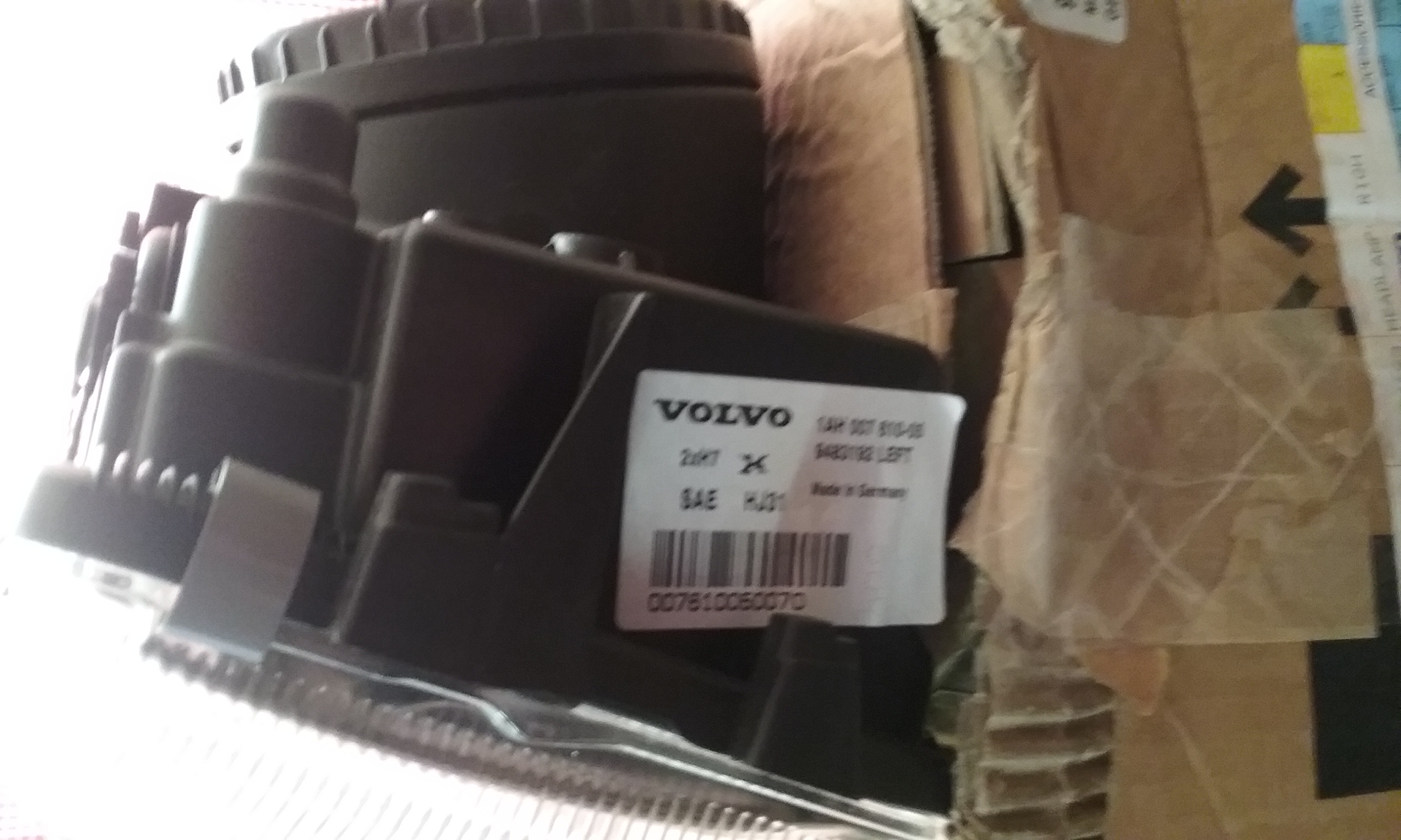

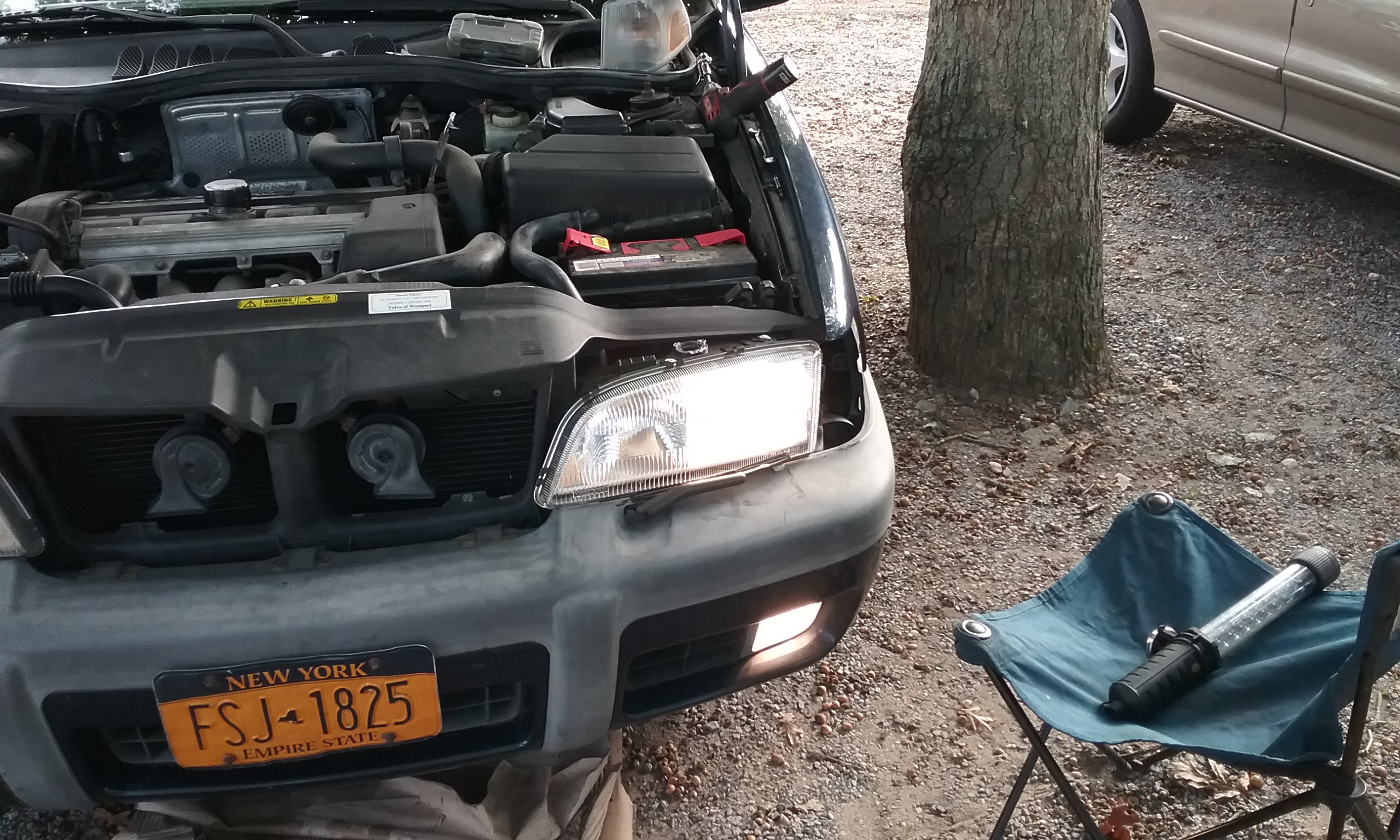

New factory Volvo headlights assemblies, old assemblies had no reflective material left.
