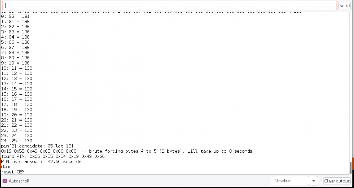

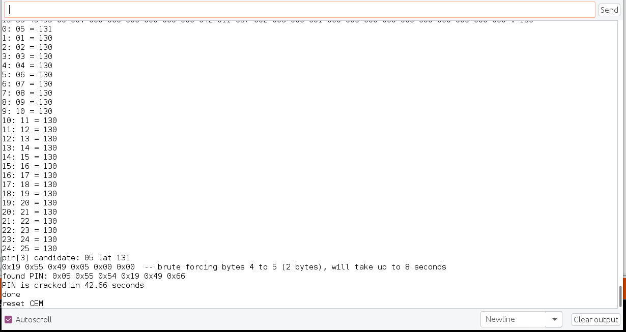

Teensy 4.0 @ 24MHz setting, 1 sample... P1 CEM (Slower than P2 as you guys mentioned).
Screenshot from 2020-11-19 21-16-10.png (32.1 KiB) Viewed 1933 times

Post by vtl »
42 seconds, nice...
