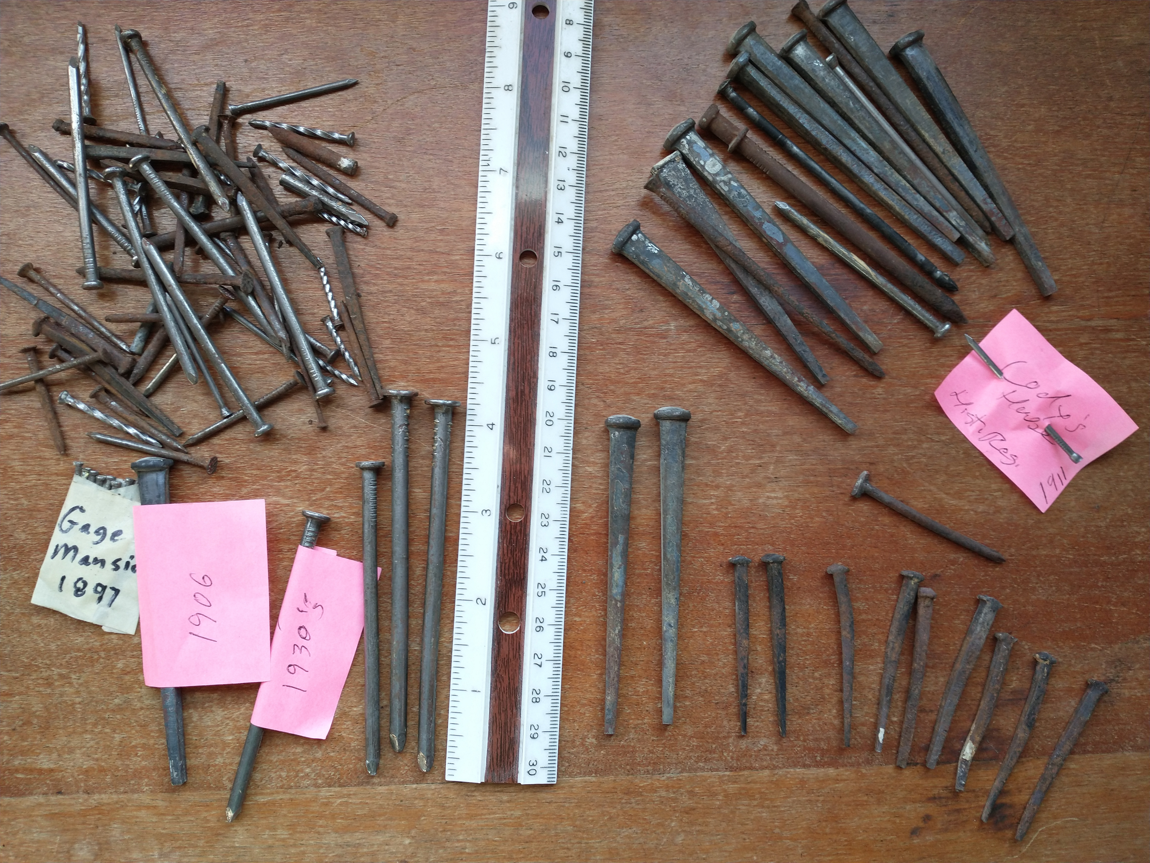

Nail history and collection:
When I first got into the building trade almost 50 years ago now, it was said that a carpenter drove more nails in one day than the average person would drive in a lifetime. And looking at some of these framing nails, you can imagine the " guns " needed to spend everyday pounding those things into rock hard wood. 4+ inches long and 3/16" diameter ! Can you say " tendinitis " ?
The nails at the far right are what are called " Rose head " nails. Each one was made by hand by the local blacksmith. These ones date back to the late 1700's early 1800's. In those days nails were so valuable that when a building was no longer habitual, they would burn it down and collect the nails from the ashes. Then they started making wire nails, but the smith would still need to cut and make the heads. A big savings in labor. After that total mass production of the type we are most familiar with.

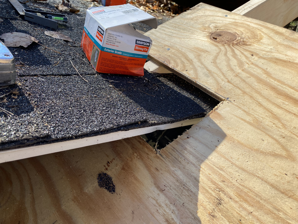

I can report that solo sheathing even a relatively mild 3/12 pitch roof, sucks. Trying to keep your purchase while manipulating 4x8 into alignment. Awful

Are you adding temporary toe boards of 2x4 on the lower rows to give you a grip from sliding off? Temporary nails between sheet edges will also maintain the 1/8 inch edge gaps and help in sliding new sheets into place. Nail to sheet edge is easier to move than sheet edge to sheet edge. Rubber knee pads would help.
I don't recall much trouble with 5/12 pitch unless it was windy. But, my roof was also dry.
But, you knew all this.

Toe boards and that nail trick would have really helped. Shucks. Knee pads I did think of but didn’t execute.
My math was bad too, actual pitch was 4/ 9
I got it done and the Grace on though, so a nice day in November and it will be shingled. Have air gun and hood compressor

Put some flashing under shingles in that little valley?
Looking good.

Flash is good. "Ice & Water Shield" is good. In snow country, people sometimes sheath the whole roof in it before shingling.
4/9...? Like as in 5+/12 ?
I think falling off is your worst case scenario here.
