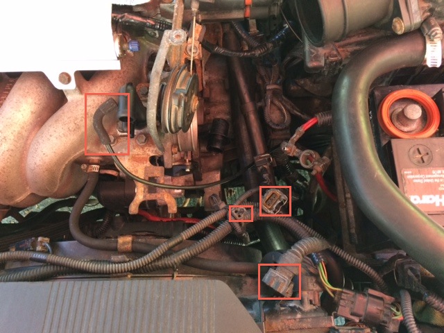

I am reconnecting the fan and all the vacuum lines and have a few that I am struggling with - trying to find where they connect. I will post pics shortly so you can see where I am having problems. I have not found any decent photos that show these lines.

Behind the very bottom connection is another plug, with two prongs. I believe the small connector sort of in the middle of this pic goes to that. One of the three prong connectors goes to the IAC valve, another to the TPS, but not sure which connector goes to what device. Then there is the black vacuum line near the vacuum tree at the top left. I will have to follow that line to see where it possibly originates.

The black vacuum line disappears under the airbox! I will have to remove the airbox to see where else it goes (if that is possible). The two connectors that have three prongs in them originate from the same wiring harness. One is covered with a hard plastic, the other has a coil-like thin plastic covering like those found on the fuel injector lines. Again, I appreciate your help on this!

Lots of pics and info here for vac lines for a non-turbo like yours: https://www.matthewsvolvosite.com/forums ... =1&t=65002.
Your connectors are for cam and crank sensor (and IAC and TPS like you mentioned), you can't really get them mixed up they will only fit on the proper sensor.

You really can reconnect these cars by finding the matching socket and sticking them together...kudos to the Swedish engineers on this aspect.

Thin black plastic line attaches to the air door which regulates temperature coming into the air cleaner. Not uber critical in summer but you should put it right to start.
