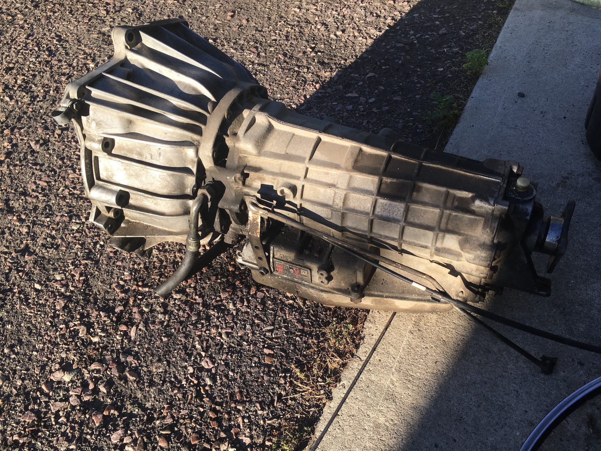

Totally un-Volvo related, but my latest project was to swap a manual transmission for the automatic in my son's '86 BMW E30. Hardest thing I've attempted I think. You're building and installing things you've never seen, so it's harder then just remove and replace jobs. Then there was the wiring.....thank gawd my son figured all that out and did it all himself. It started right up, back up lights came on, and he eased the clutch out with no throttle and it rolled out of the garage. We're still amazed.
We did some shake-downs, he had a new exhaust hanger tab welded on, he took it up the pass in Glacier Park (6500'), I drove it out the freeway a ways, then he drove it 1700 miles to Illinois for school. No issues! HAH!

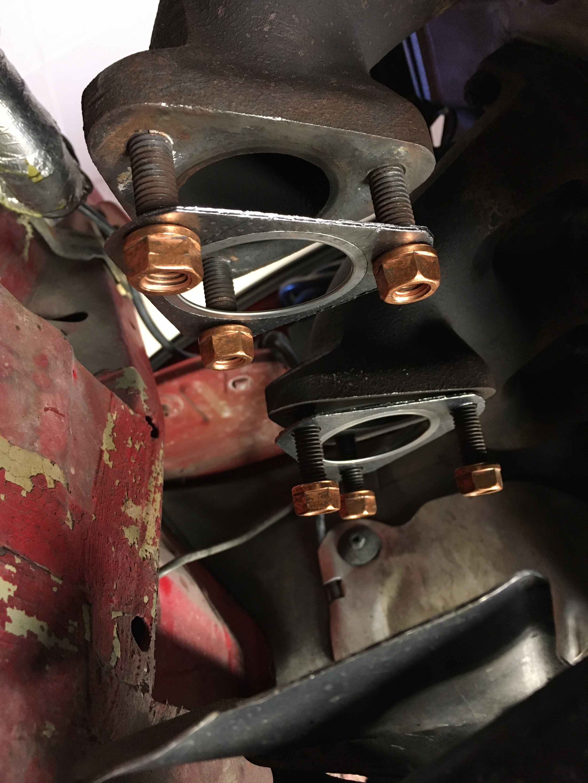

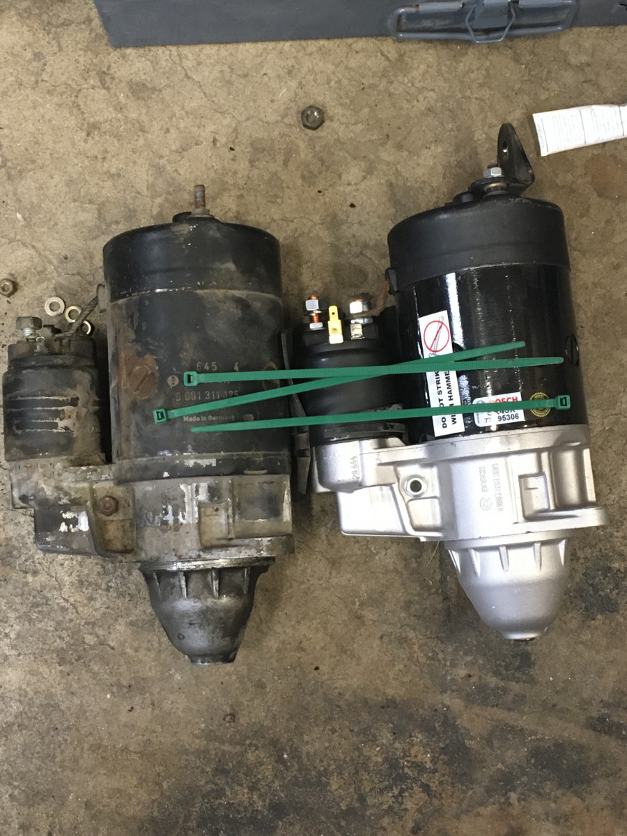

You need a decent salvage transmission (fingers crossed), the shifting assembly and shifter, manual pedal box, the hydraulic system, flywheel and clutch, cross member, driveshaft, exhaust hangers, some wiring and a reverse light harness, all new seals and bushings, and mounts. We put in a new starter while it was apart, as it's very difficult to get to.
Some process pics.... We worked many days till midnight. Many obstacles and minor crises overcome, it was a good exercise for him. We just kept stubborning ahead.

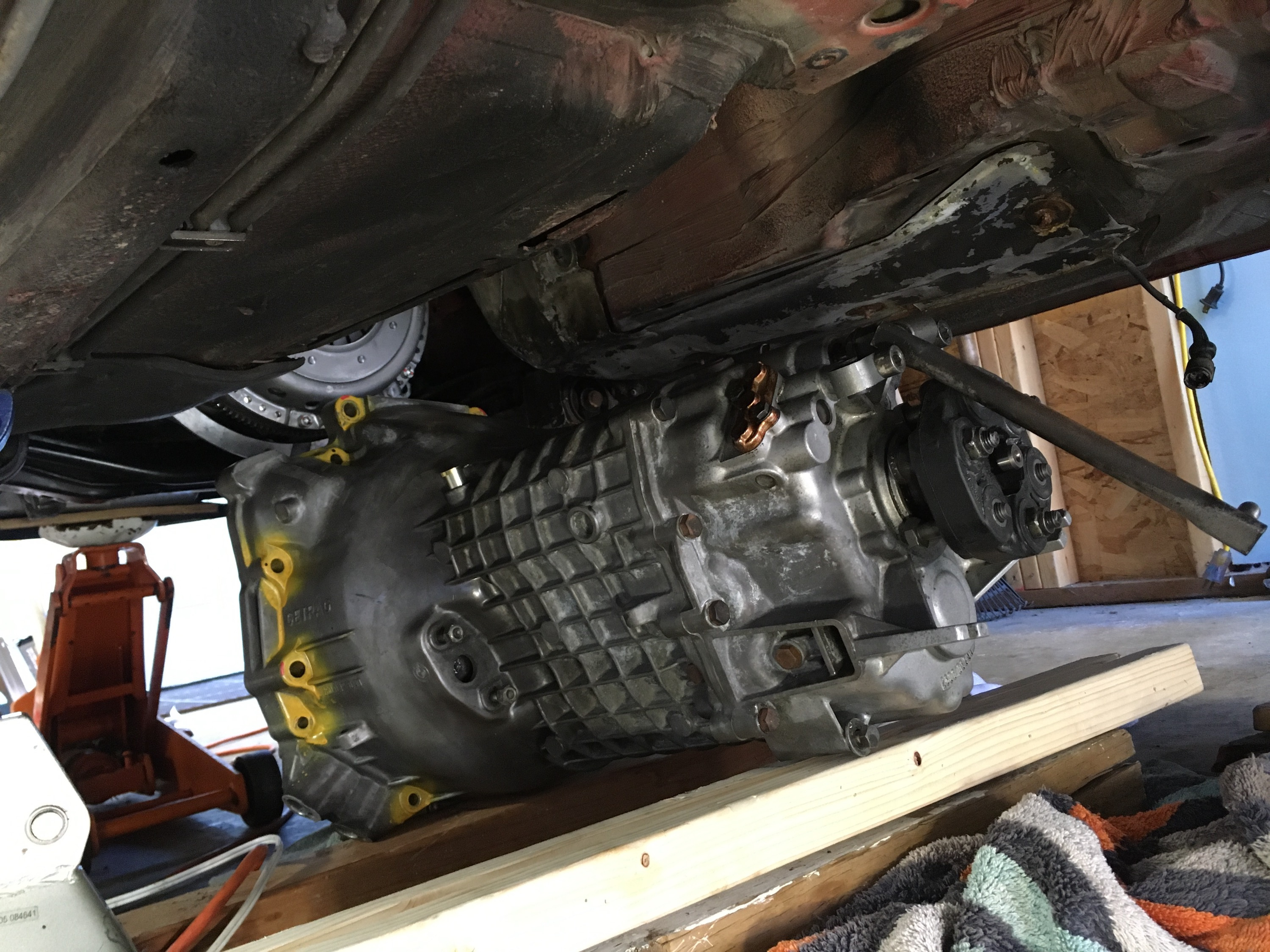

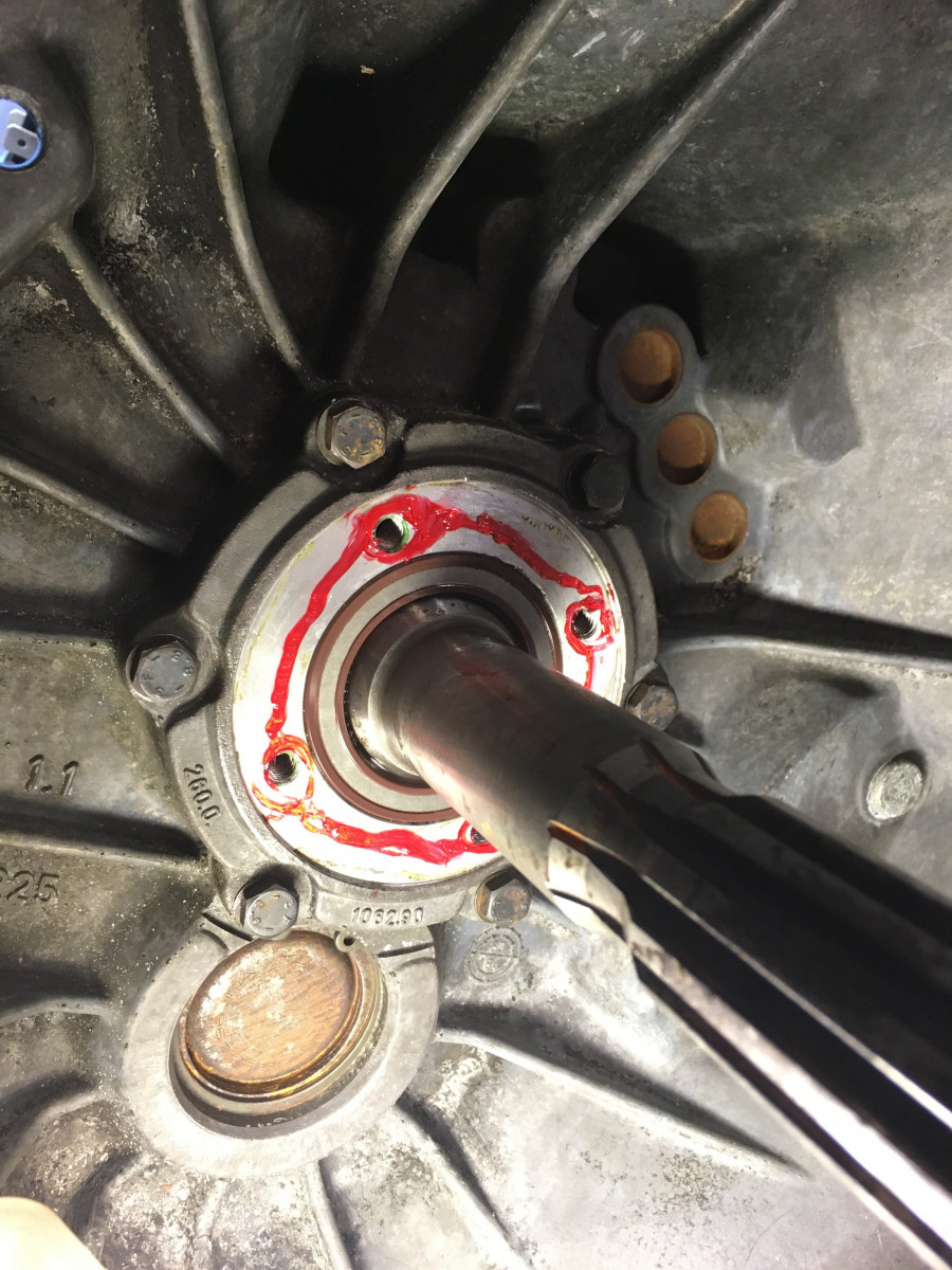

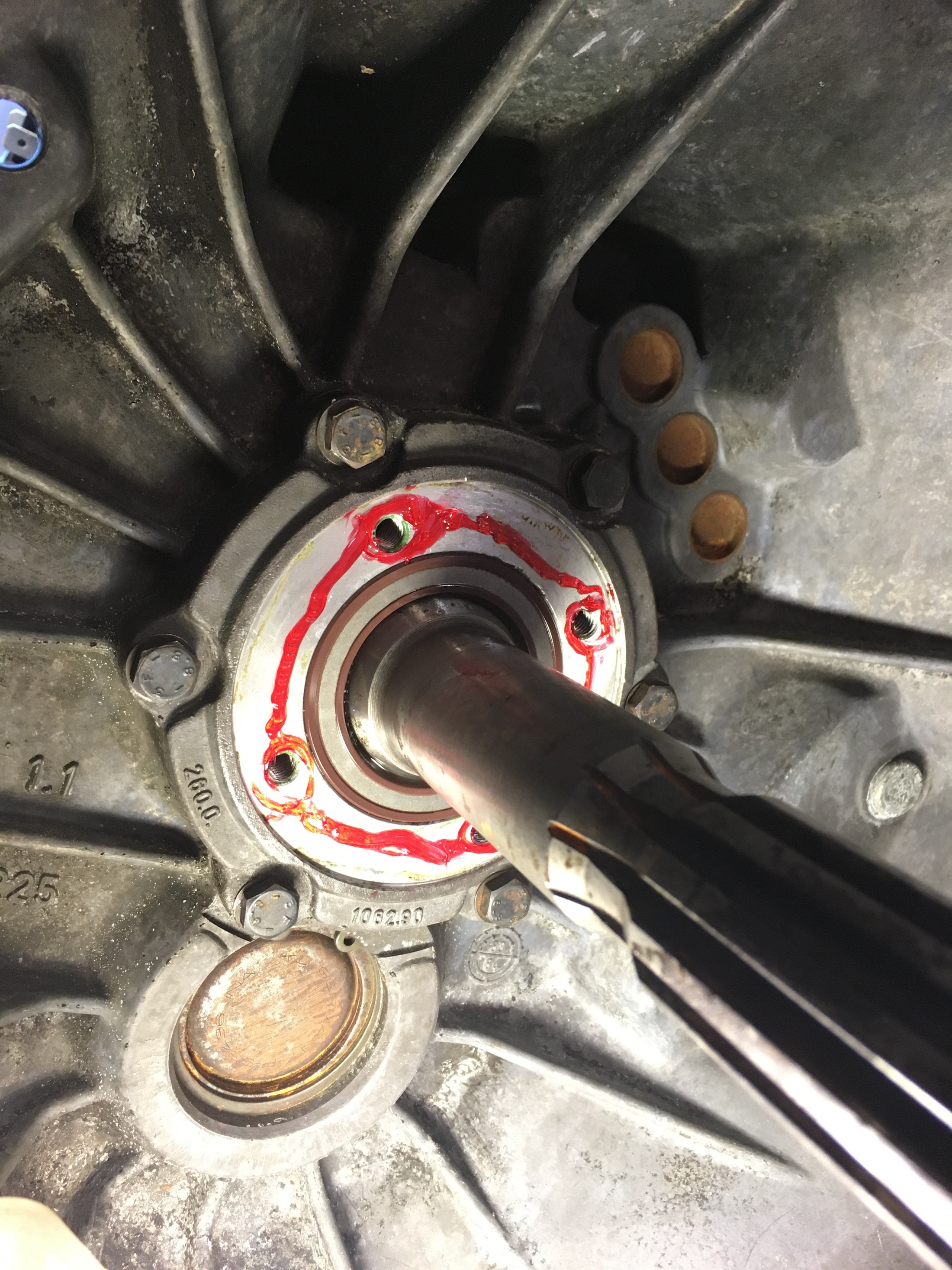

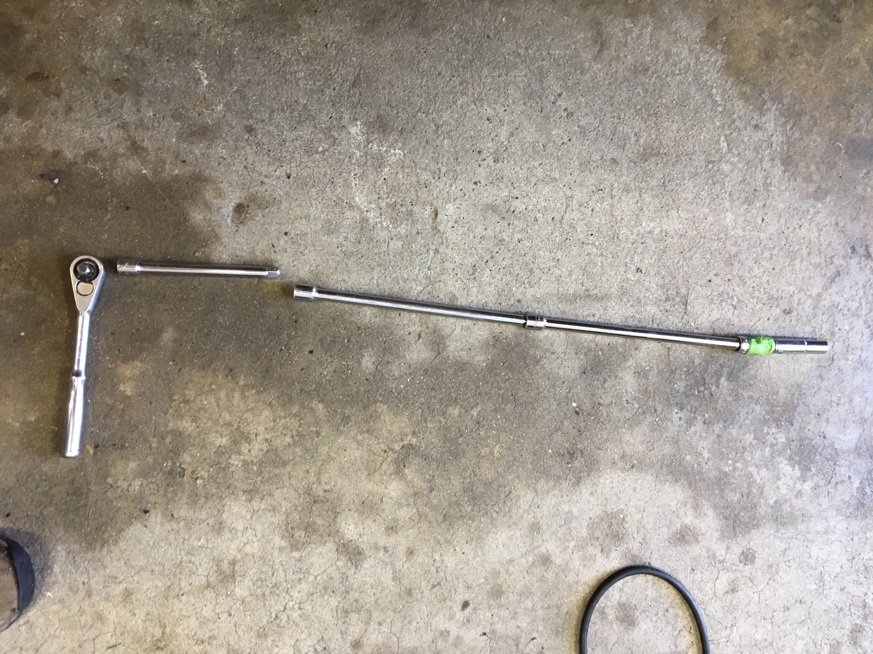

It's a bear to get out. You need to tip it back until the head hits the firewall, then use 3 1/2 ' of extensions and a wobble joint to get on the bellhousing bolts blind, above the transmission, from the back.

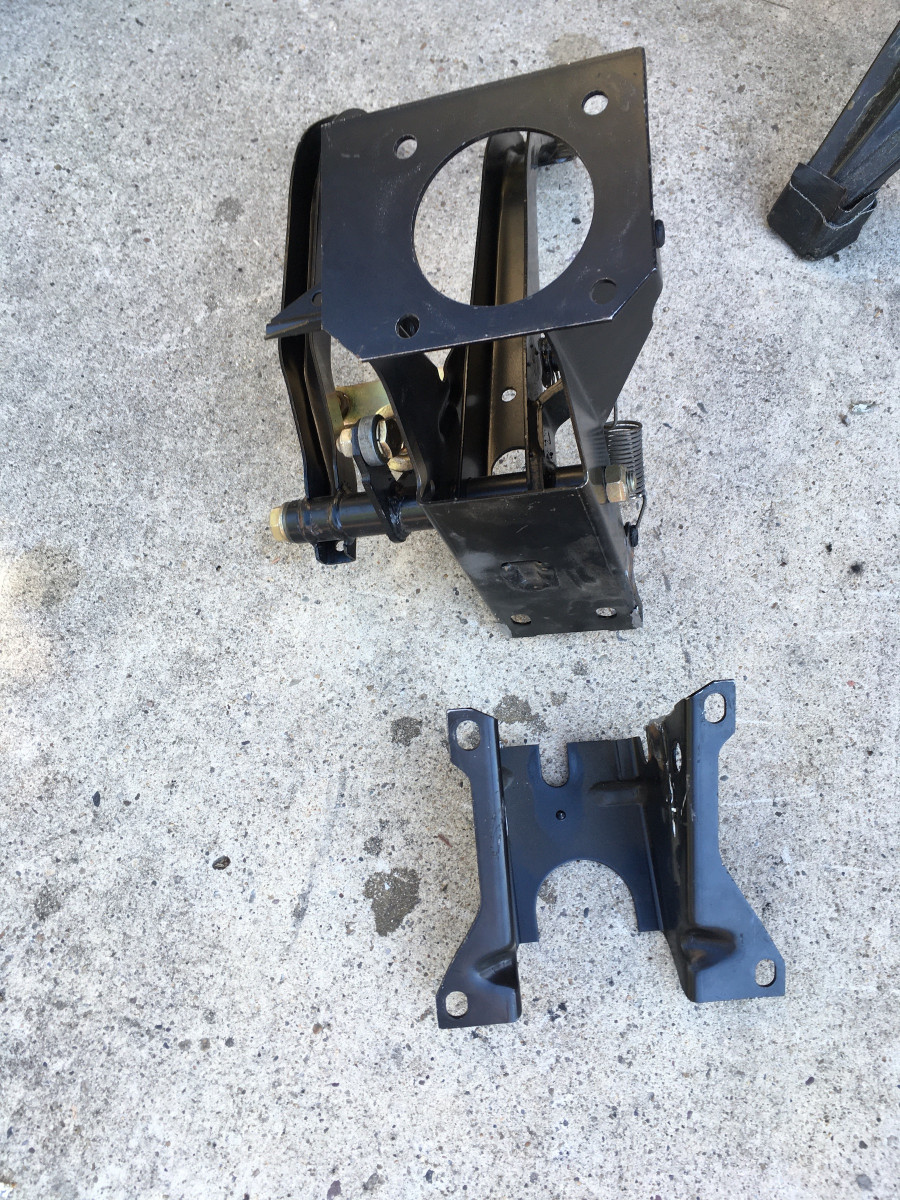

Used parts man scammed me and sent a pedal box from the wrong car. We cut welds and modified to factory.

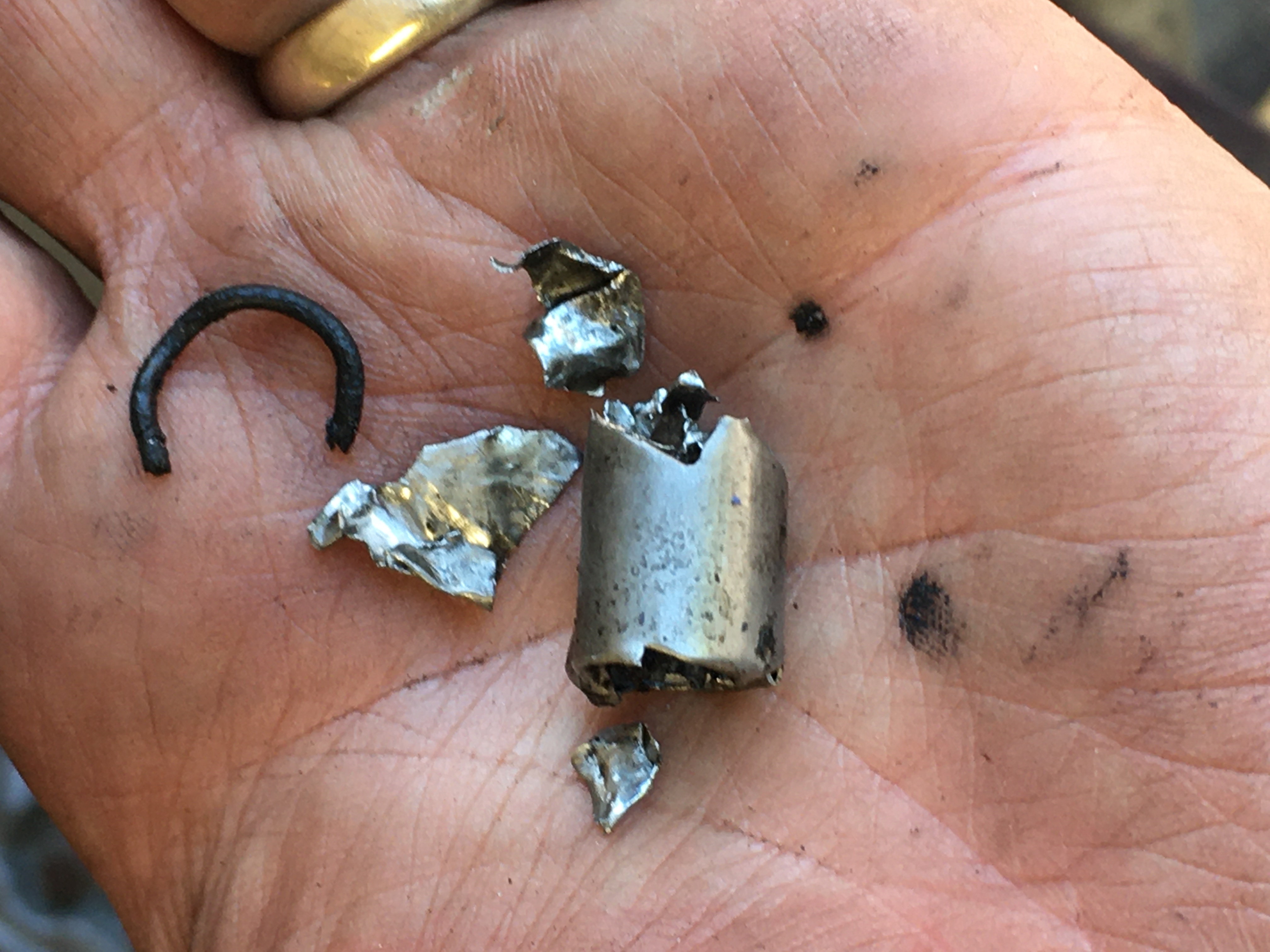

Old melted sensors in the donor car
Always use new bolts!

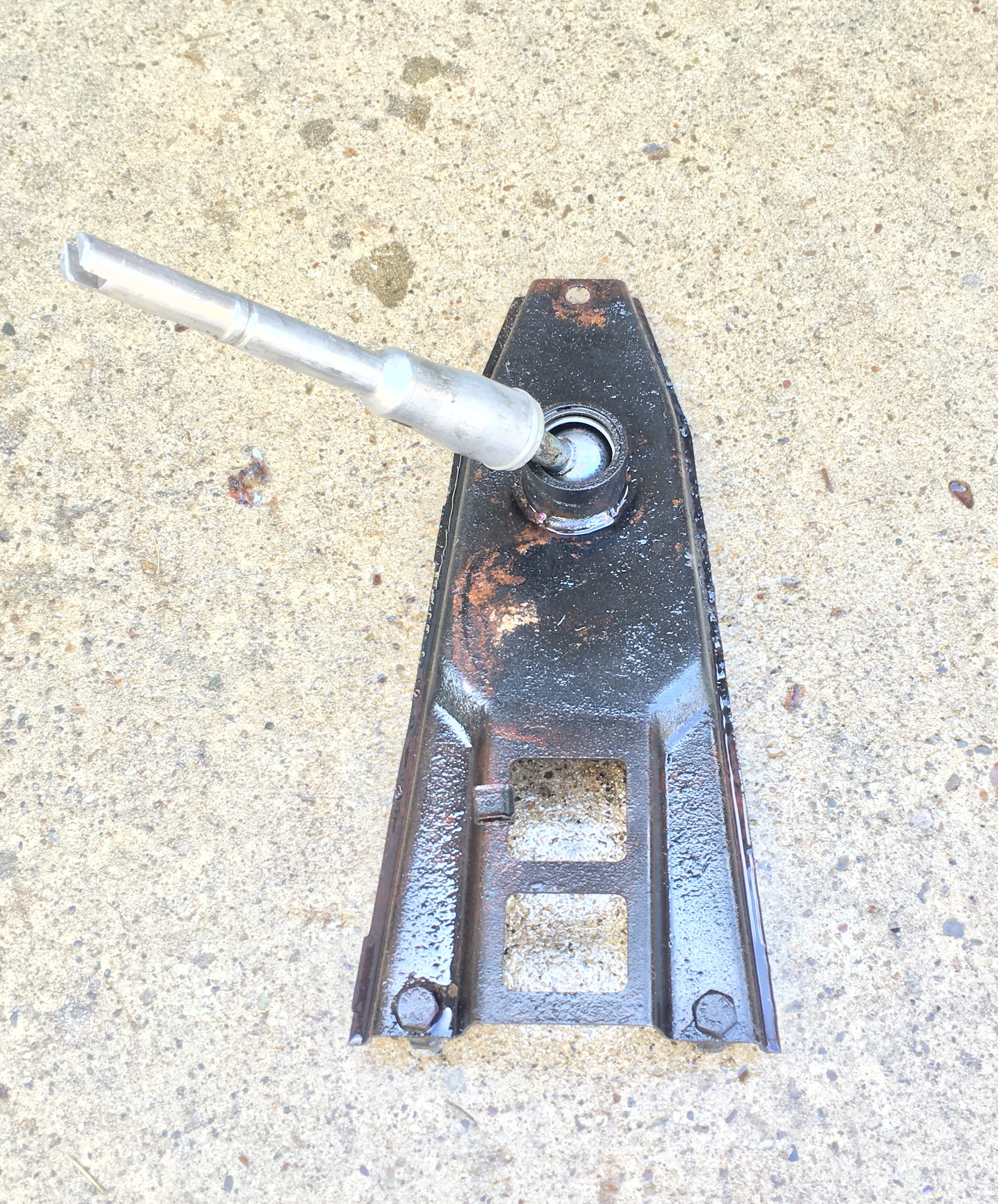

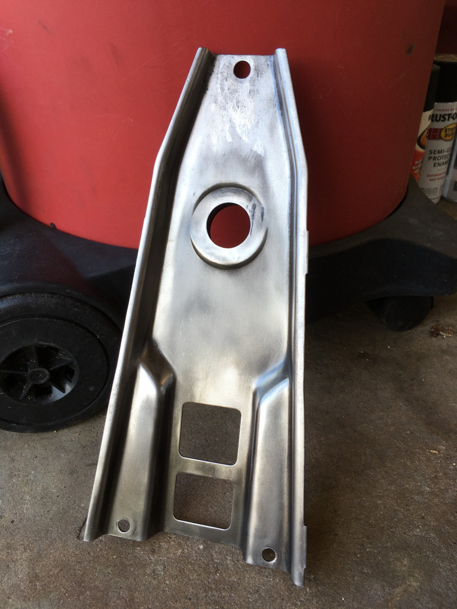

A bit of wire wheel...

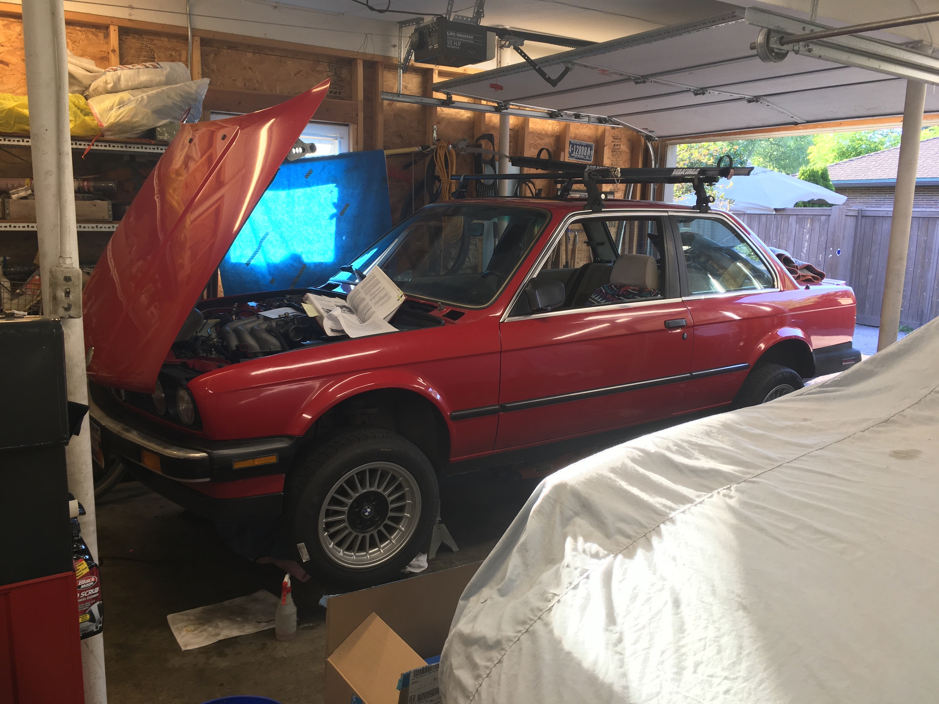

Mocked up the car in the kitchen. Parts gradually disappeared into the garage.

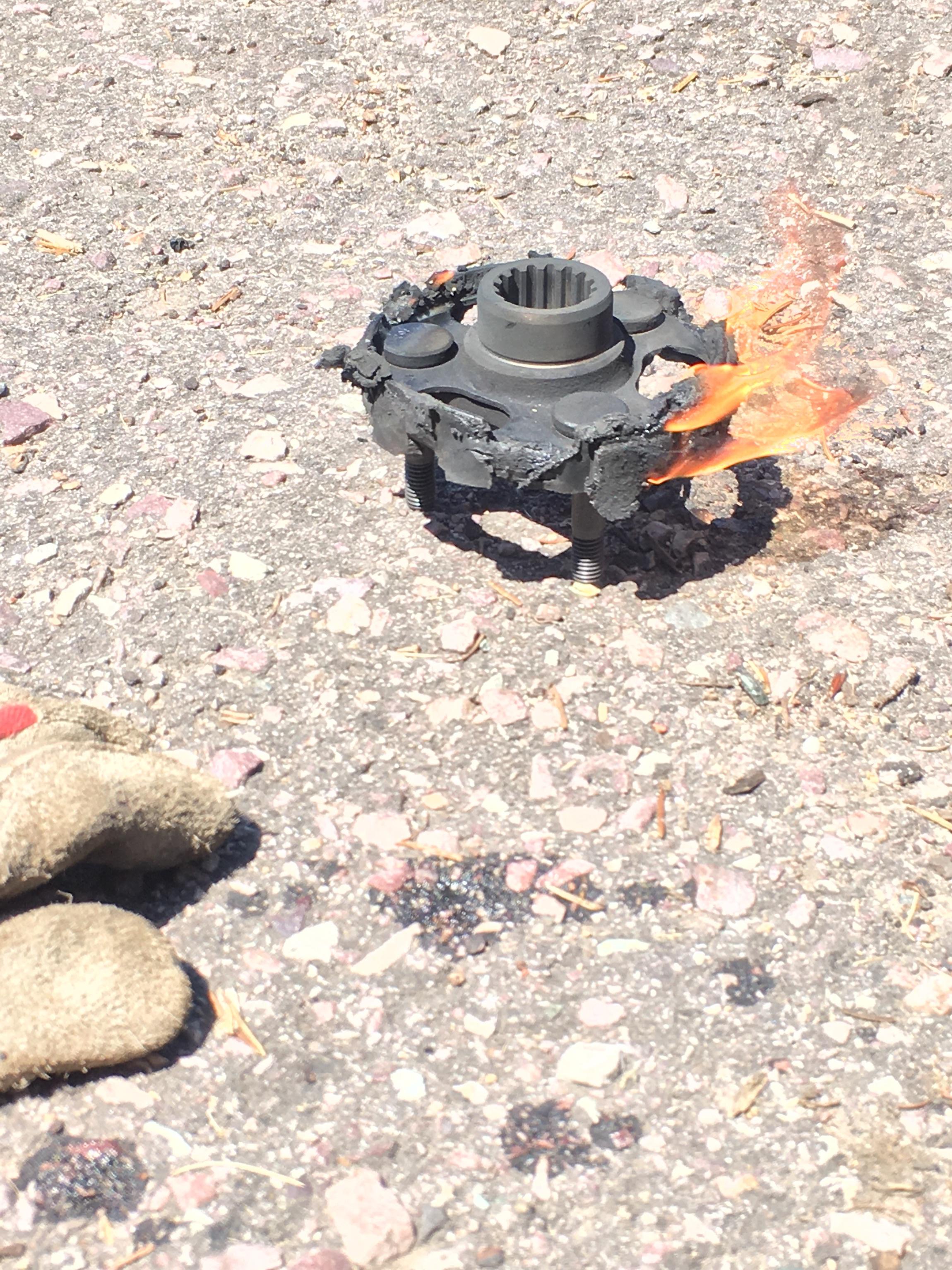

Smoke wrench for old gooey bonded rubber bushing

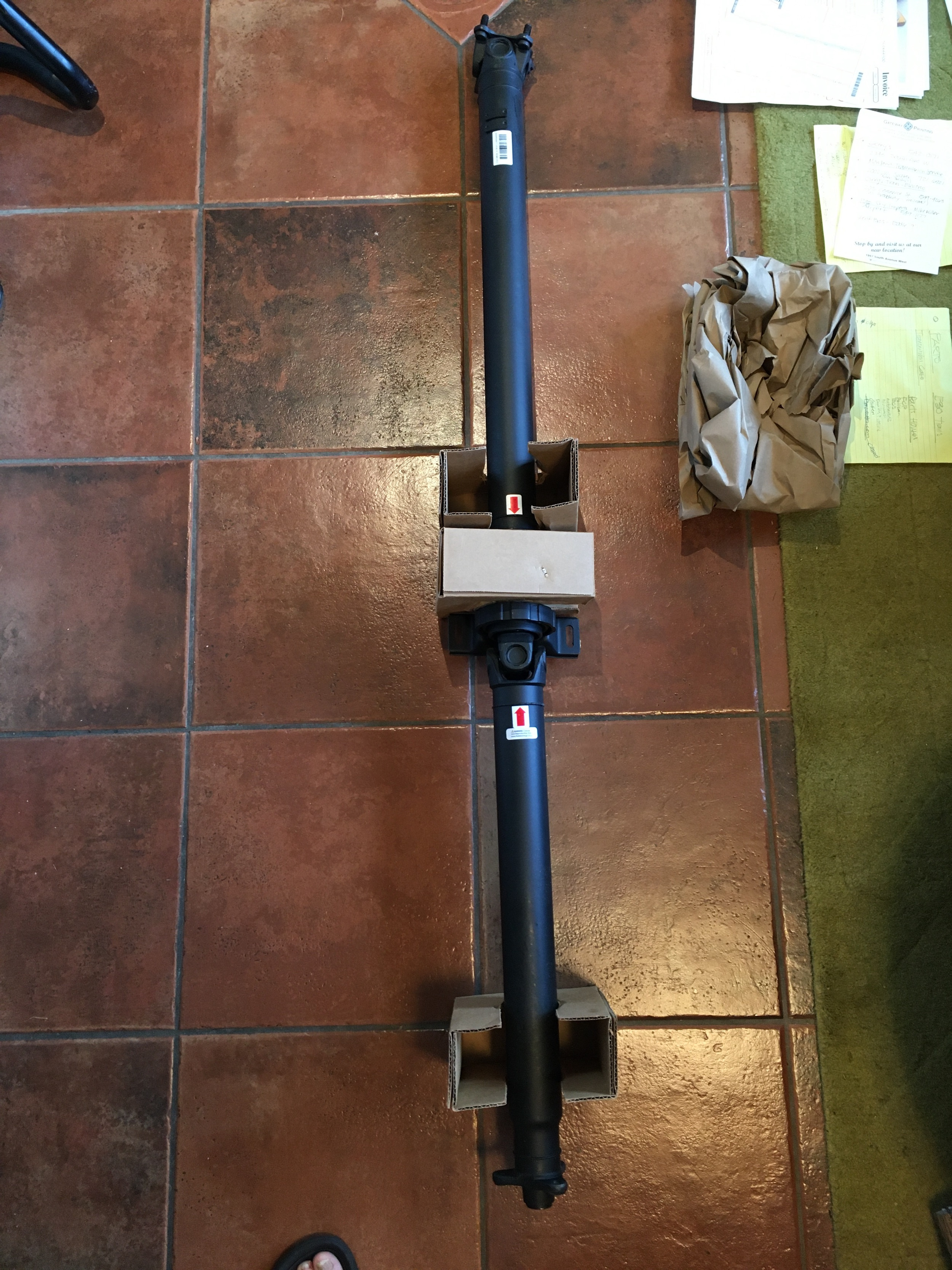

Rebuilt driveshaft - different length by a foot.

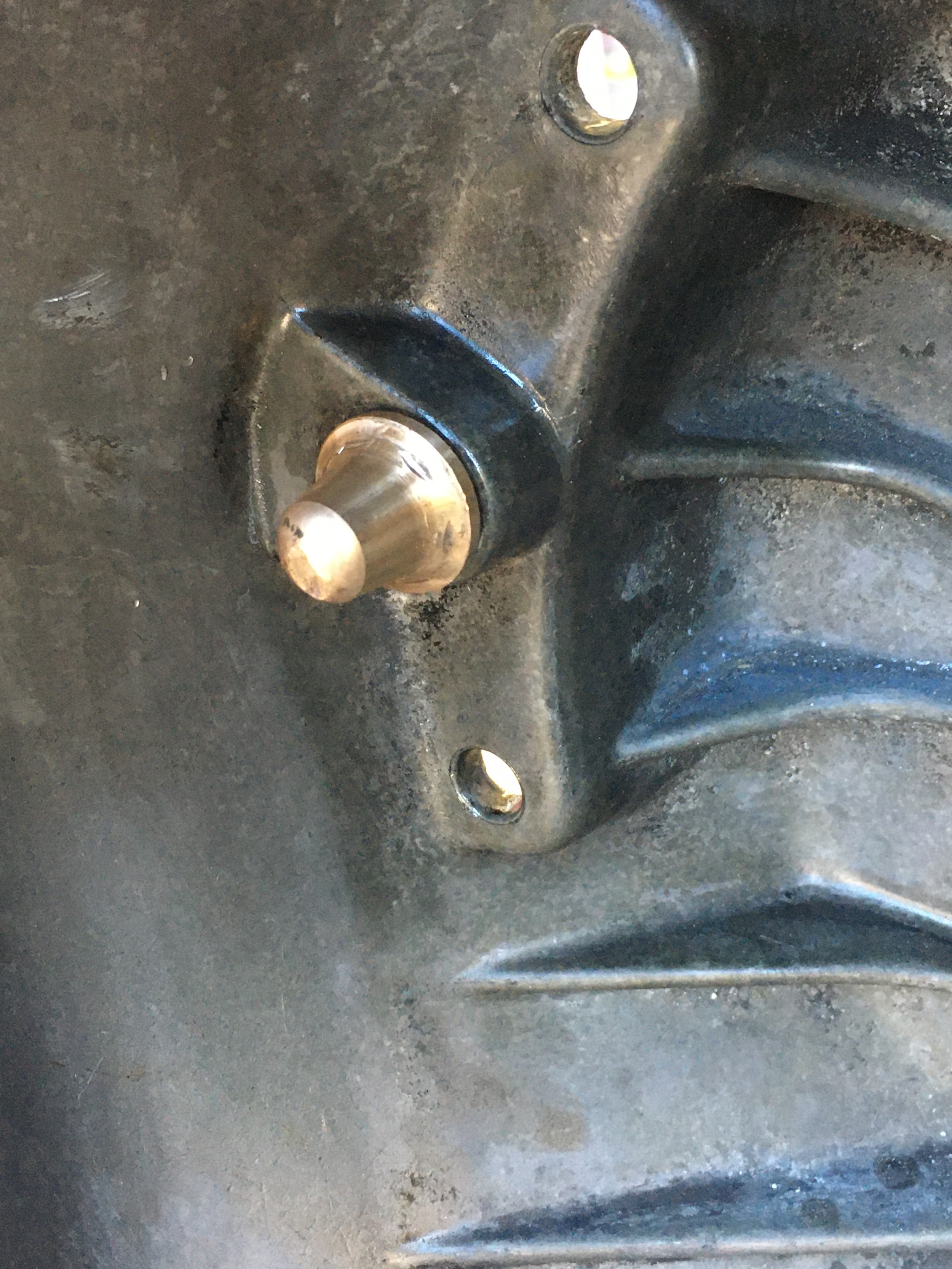

Silicon bronze clutch pin! (instead of plastic)

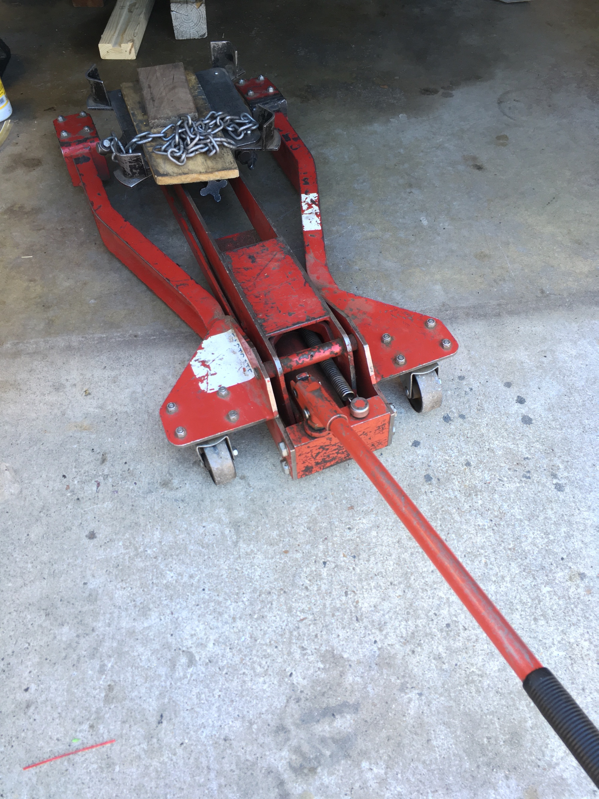

You need this. Brilliant for $25/day.

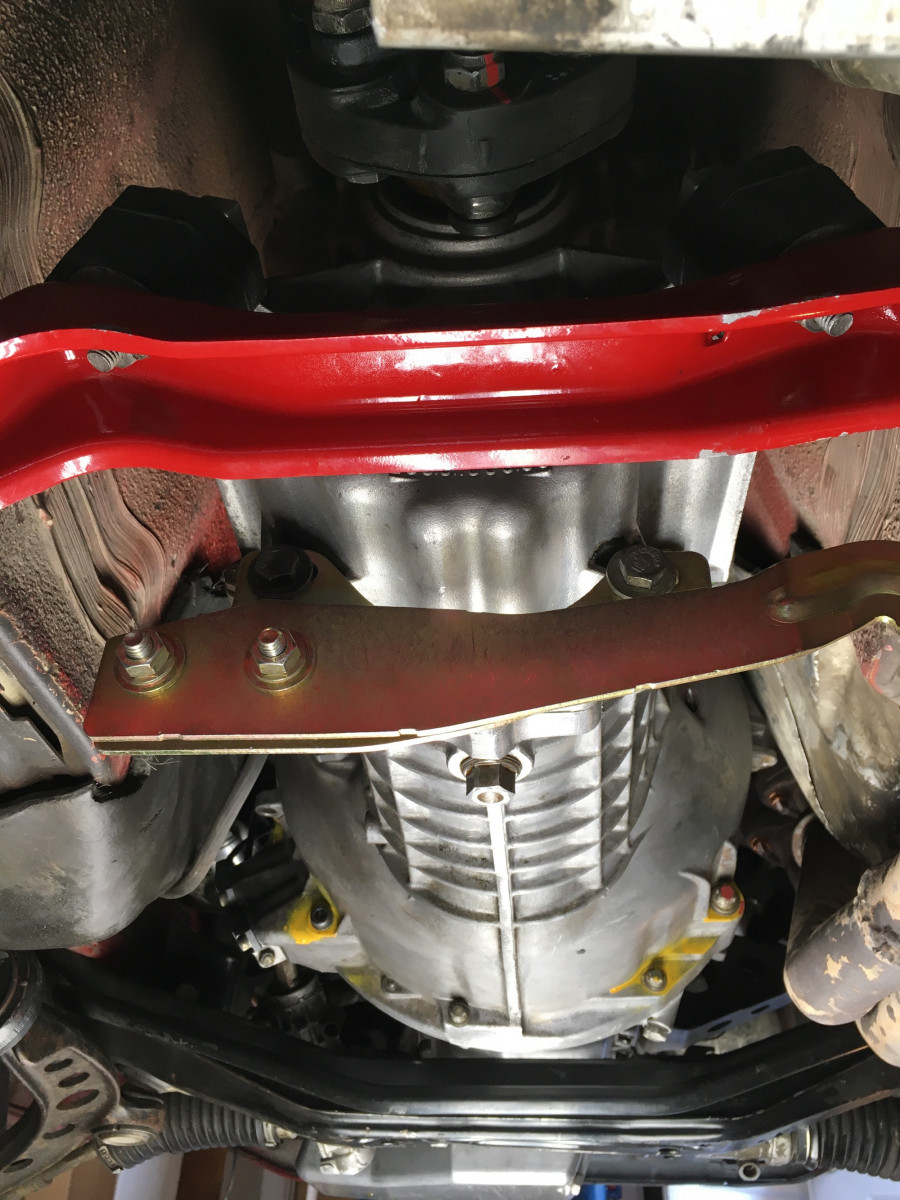

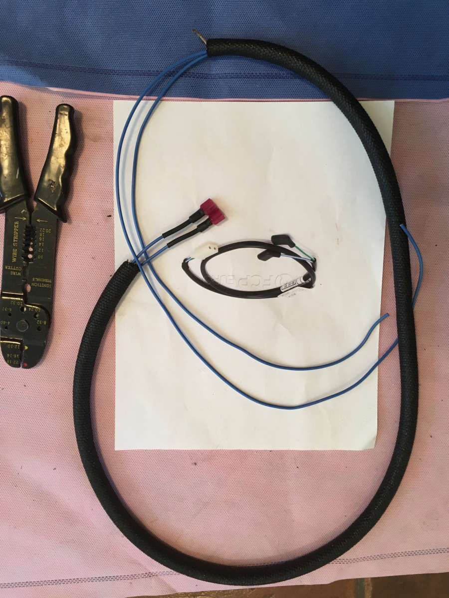

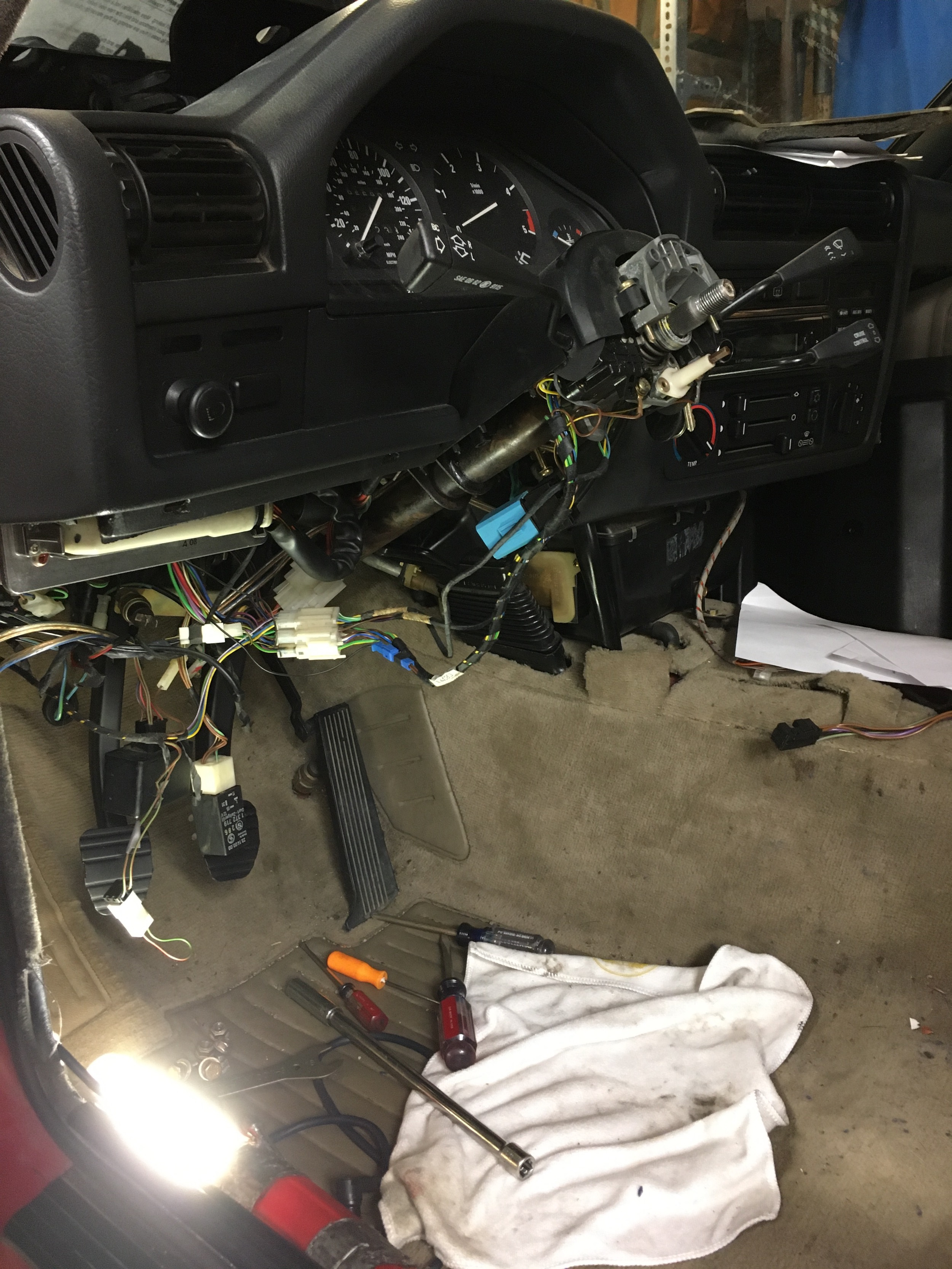

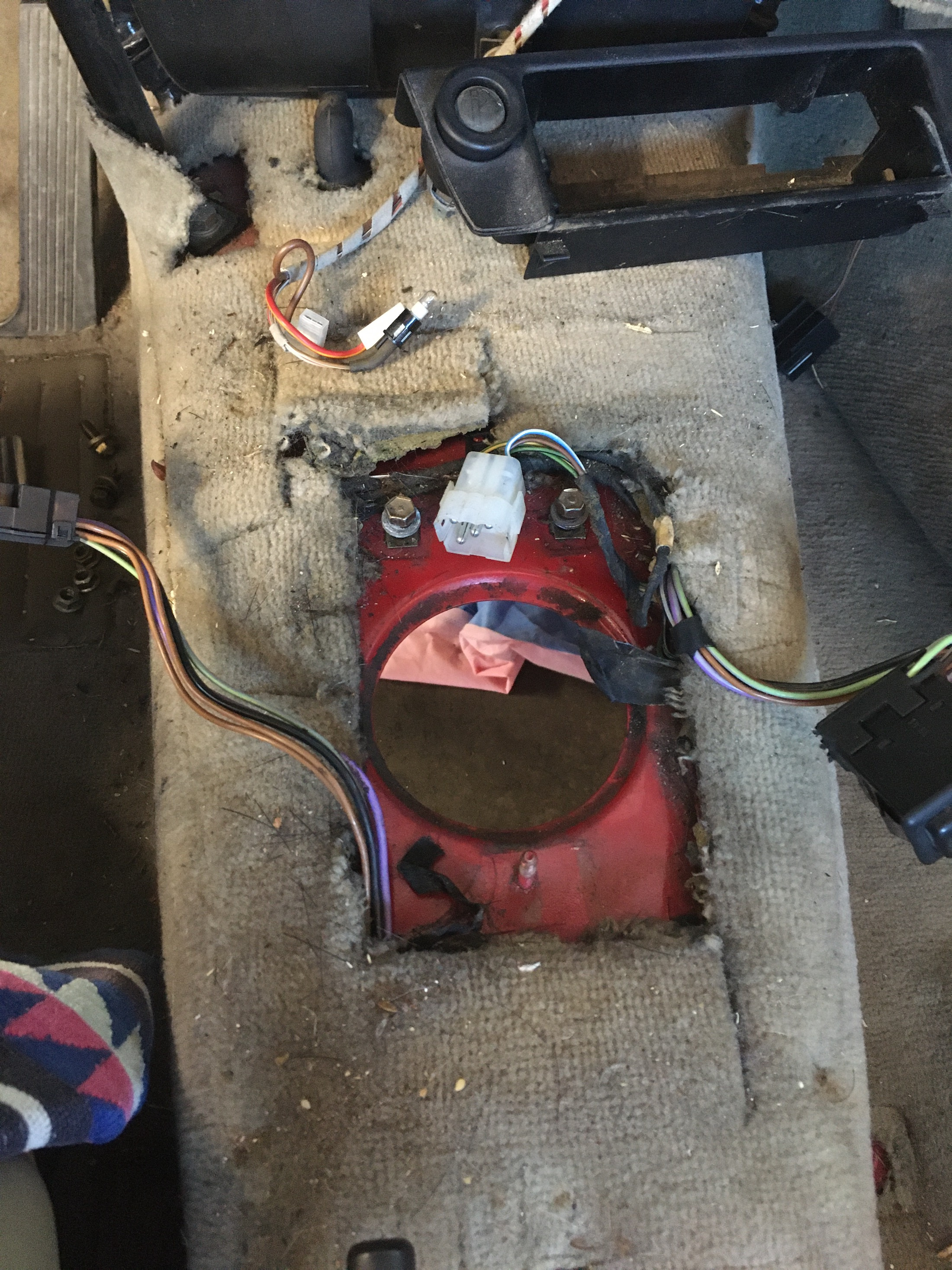

What we learned is that they were all wired for the manual, then they added an automatic harness to those order with auto. he had to find all the connections to the auto harness, disconnect and dead-end them, and connect the other end to the proper place in the harness. We finally found a missing connector inside the drivers kick panel instead of under the dash.

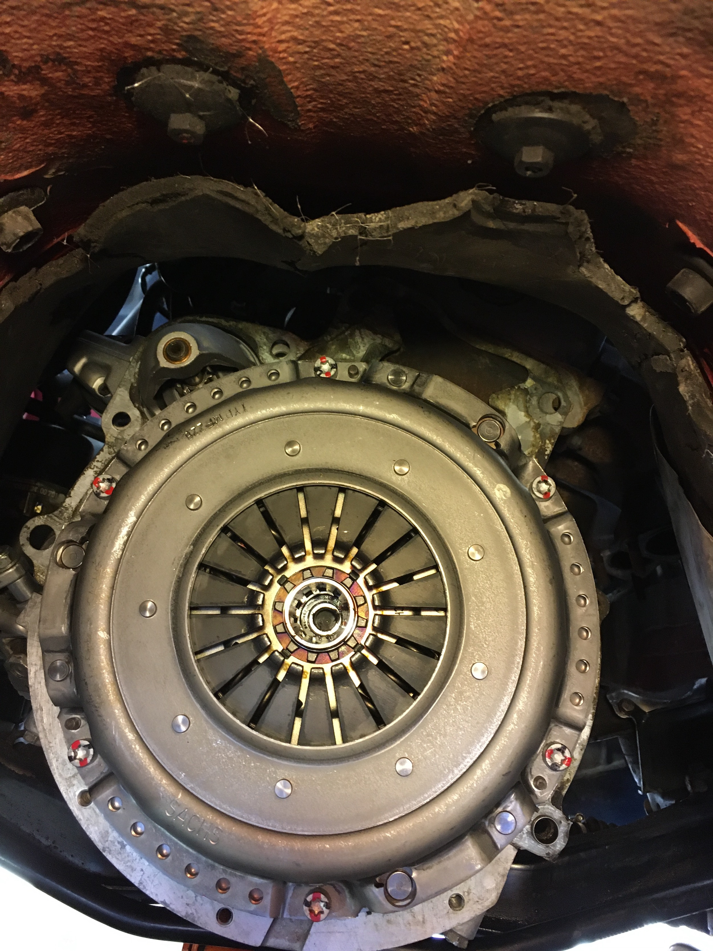

Ready to lift. We spritzed some bright paint on so it would be easier to see the bolt holes in the dark up there - worked pretty well. The bell housing bolts are reverse torx heads, or "fairy heads," or "e-torx." You need a set of those sockets. No room for a hex head bolt in the aluminum casting shapes.

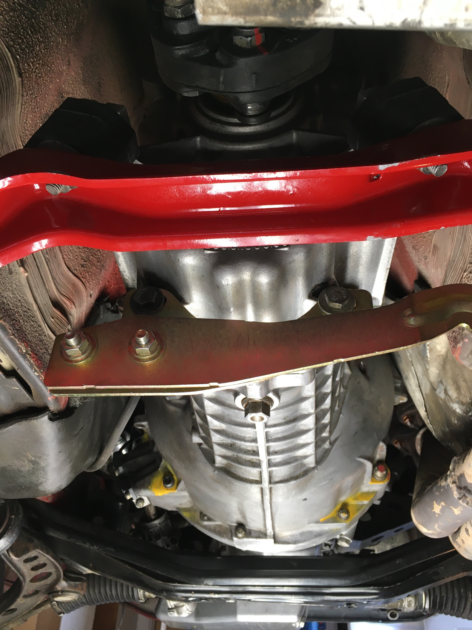

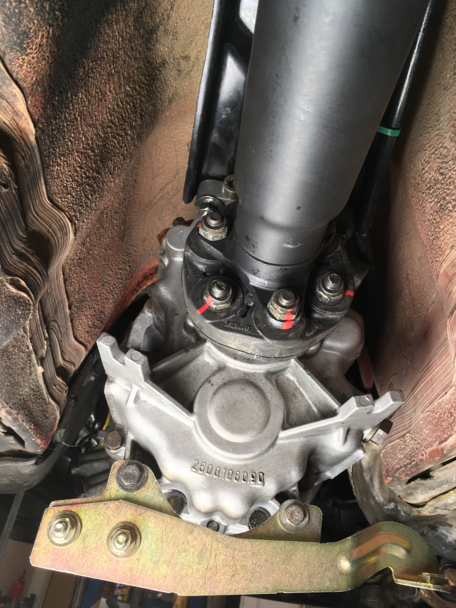

Red and black paint marked which are torqued twice.
Paint marks show if anything has backed off at next check
I love new hardware.......

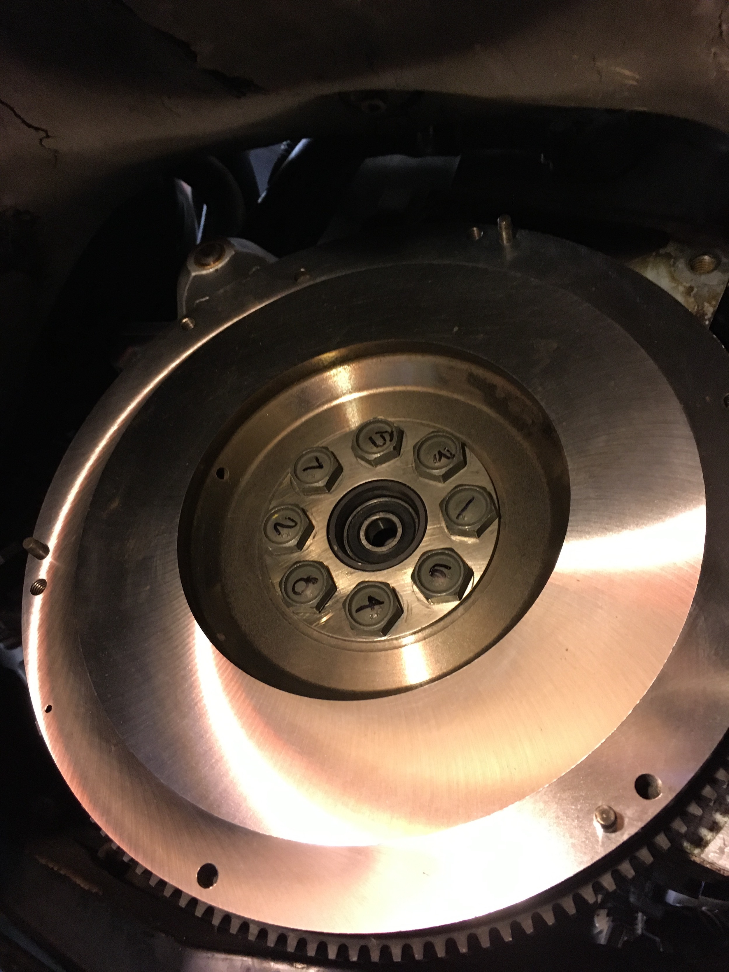

I made a huge mistake when we tipped the engine and partially attached trans backwards to access the top bolts. The new starter is hanging in the sheet metal spacer at the rear of the block, and attached at the front with one bolt to the block. The solenoid housing caught the seam on the bottom of the brake booster drum, bound up, rotated upwards, and bent the shit out of the sheet metal spacer. Spent two hours tapping, pulling, sheet metaling, & lining up bolts in holes before we got it flat and aligned again. I was NOT going to take off that clutch and flywheel again! Arrggh.
Then it went more smoothly. The manual has a way smaller case and easier to access bolts.

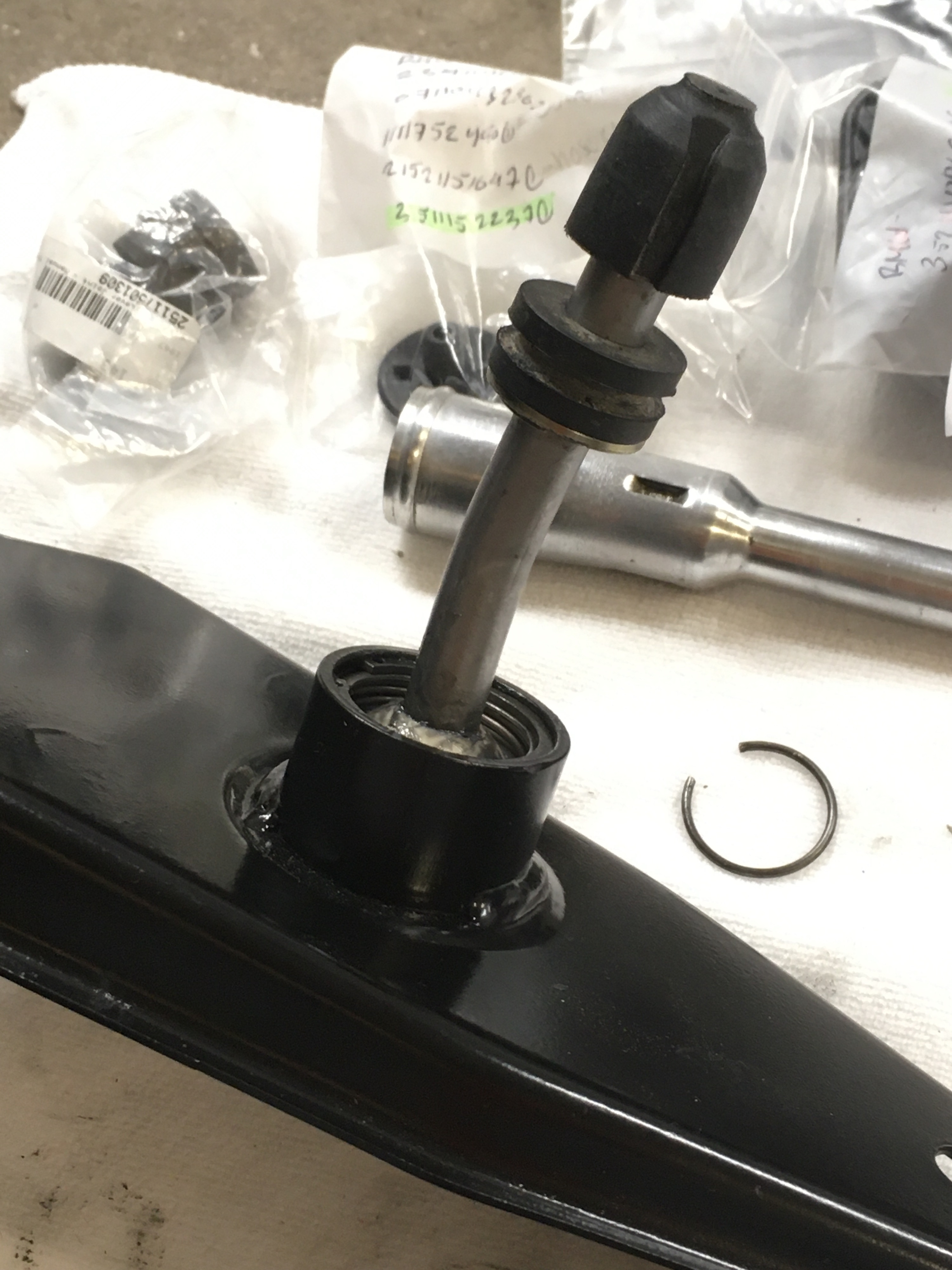

Rebuilt shifter with new parts, shims, cups, bushings, clips, molybdenum disulphide grease.

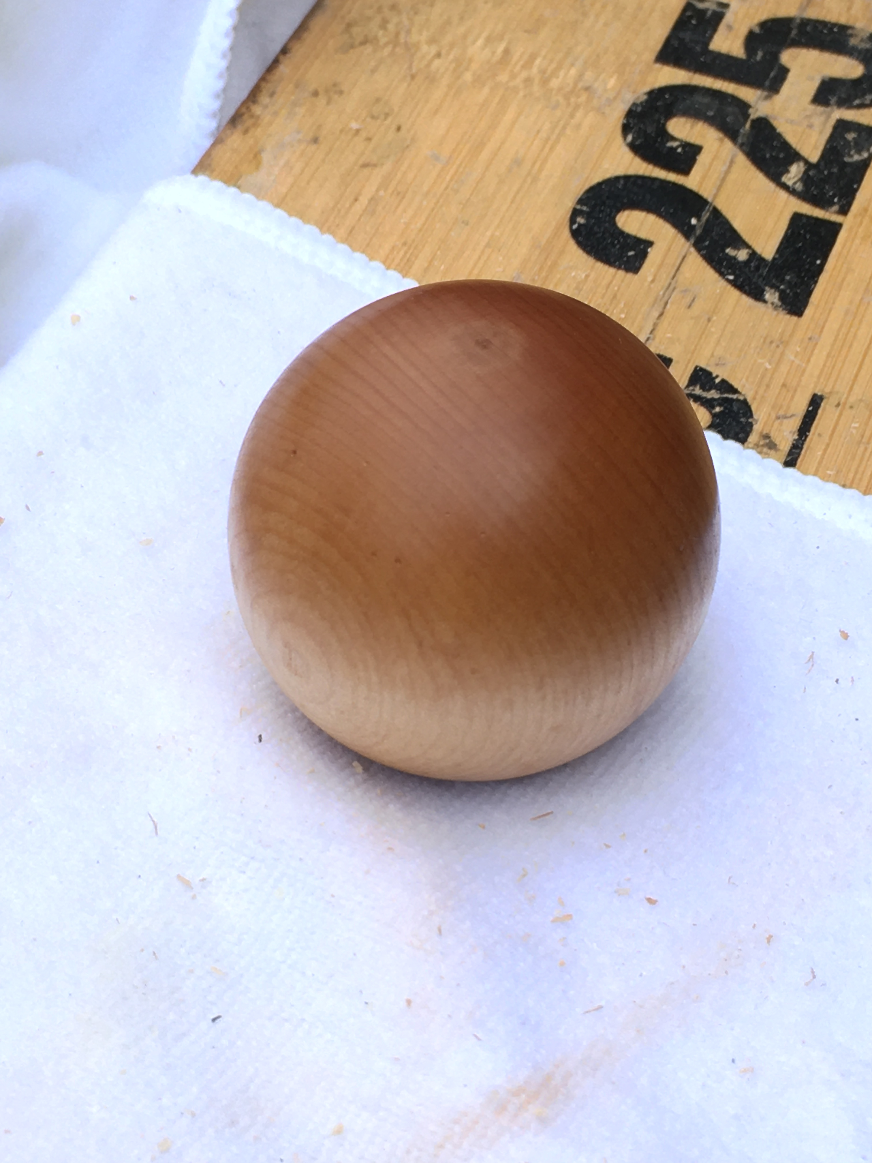

We made a temporary shift knob for $1.85 from a local craft store. Drill a hole, add some Danish oil, Bob's your uncle.

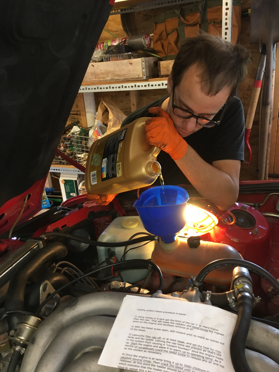

New timing belt and flush the cooling system, put it back together!
The official correct way to bleed the cooling system...

Post by volvolugnut »
