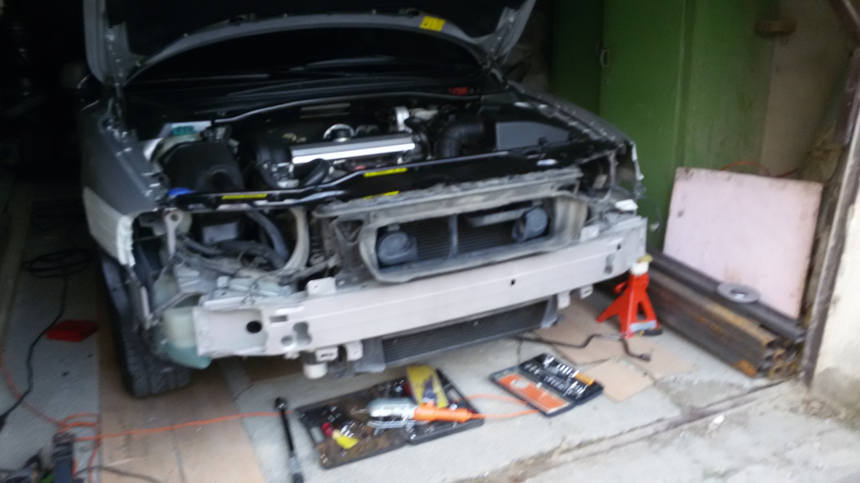

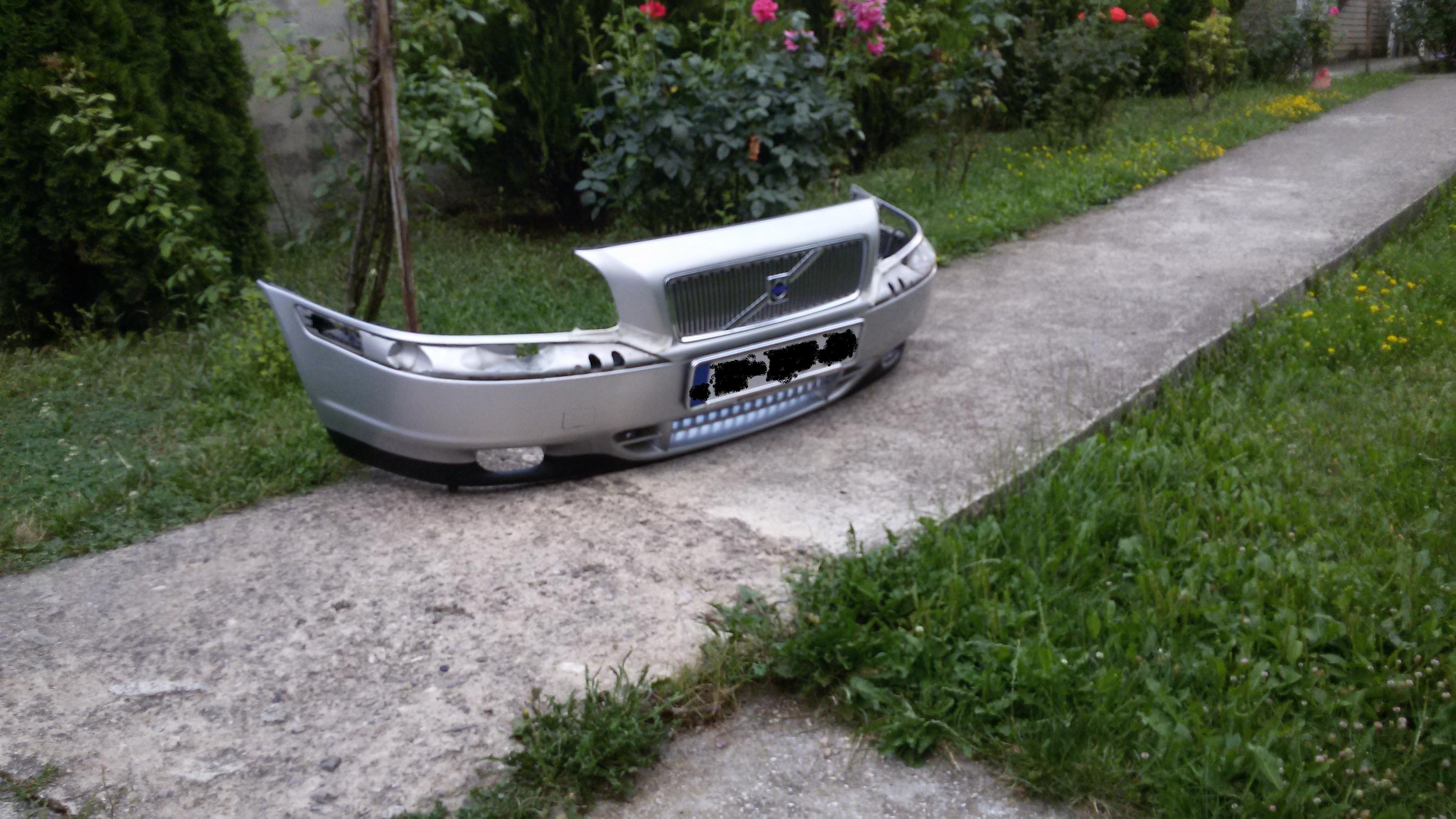

Hi Janey,
I did remove my bumper on my S80 as there was creating some moisture inside my headlights and I took them out open them cleaned them and sealed.
I guess it should be the same on S60 too.
1.Open the hood and remove the plastic clips in front off the grille take a small torx ass it is flat and put some masking tape on it and don`t push too hard on them,then pull them straight out (P.S you should be just fine if you don`t rush),
2.Take the radiator under cover out it has two screws, one in each side just behind the fog lights and two clips that go on bumper, you should push them a bit with a flat screwdriver and pull it away.
3.Remove headlight wipers (8mm) bolt if you have and tubes for headlight washers and side marker light.
4.Remove bumper trim (P.S you could use small shoe spoon so you won`t damage the trim finish) starting from the upper parts near grille just under headlight.
5.Remove four 10 mm screws two near side blinkers and two in front near grille( P.s yes you should have another bolt as you supposed).
6. Remove two plastic trim under the licence plate in the sides of lower grille and under them another two 10 mm screws.
7.If you have fog lights disconnect them and then if you want remove them( three phillips screws on each one) so you don`t brake them if accidentally the bumper fall while you take it off.
8.Take out the pop rivets (could be screws) in the wheel arch plastic just them that are in the bumper height.
9.Put the side mark connectors and cables inside the fender so you don`t snap them while you take the bumper off.
10.If you have fog lights than you should disconnect a connector on driver side for fog lights for a cable that goes through bumper you can see it through side marker hole.
11.Put some masking tape in your fenders in the location where the bumper meats the fenders so you don`t scratch your paint.
12.Put your hand under bumper in sides of it pull it a little bit up and pull straight than repeat it in other side too than pull it straight out.
I hope I could help, and sorry if there are any grammar mistakes.
