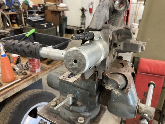

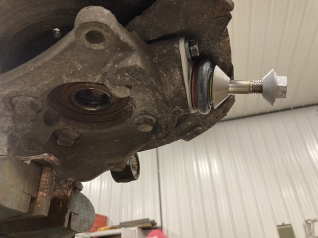

By the way, if anyone needs to borrow my ball joint installer/tool seen in the photos it is freely theirs, just pay shipping to & fro. It is a thing of beauty! For years I avoided its use & just did things the old fashioned way. Another custom of mine relegated to the past.

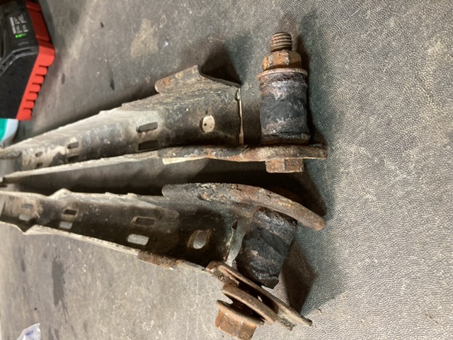

- Alignment of front end (rear stay eccentric bolts seized to bushings)

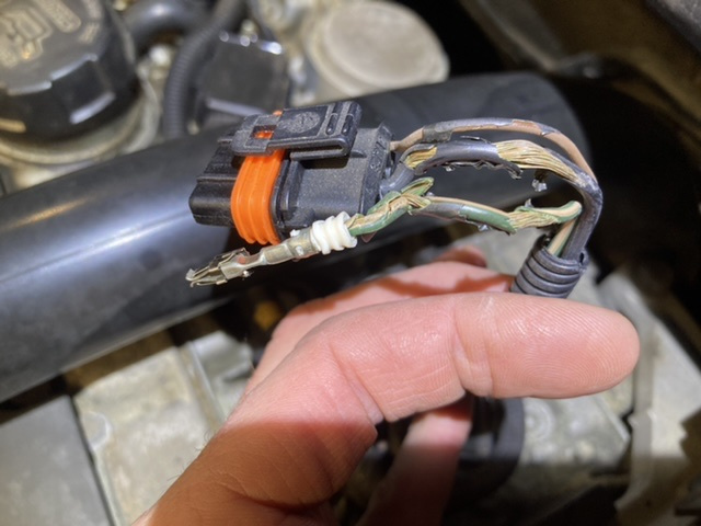

- new Bosch spark plugs (FR7DPP+) (#3 wires’ insulation needed help)

- new rear “stay”/control arms, bushings, eccentric bolts/washers.

- Pete - wrote: 21 Dec 2021, 23:35 - new Bosch spark plugs (FR7DPP+) (#3 wires’ insulation needed help)
You can get a replacement wire harness for $90. I installed one like this a year ago.
