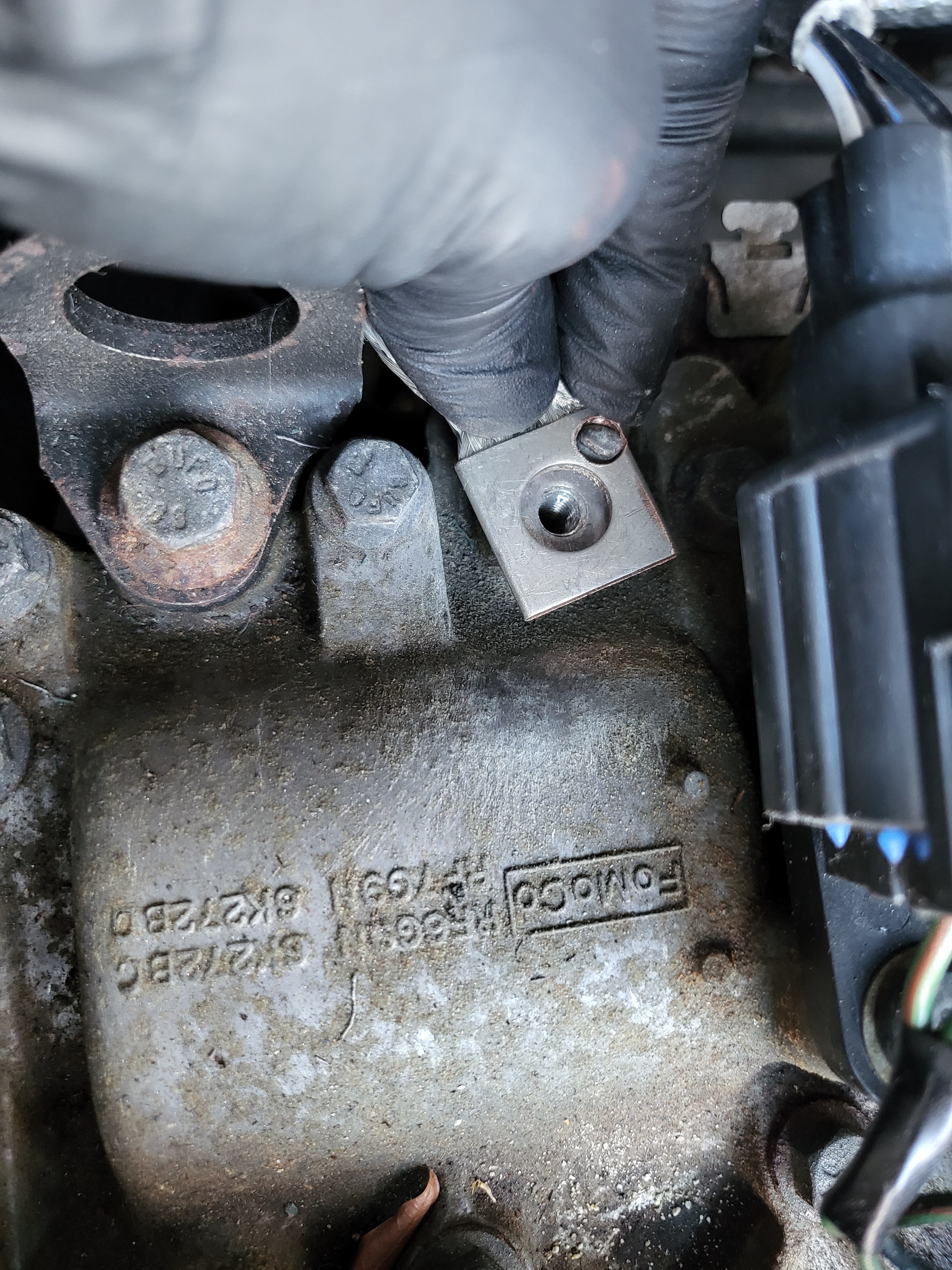

I did score the XC90! He's not perfect but serviceable. Yesterday I changed his plugs with a set from RA. I just can't spend double (?) at FCP yet even if the next set are free. Still kicking myself for accepting FCP's free shipping with my $230 order and not just forking over the $10 to get the parts a little sooner. Ordered on 2/6 and for whatever reason I thought a delivery window of 2/17-23 would make me happy. What was I thinking?
Anywho, while I was crawling around under Norman's hood looking at rusty bolt heads, I reached back and tugged on the ground strap which then disintegrated in my paw. Pictures below. Then it was a trip to Advance at 4:30 on a Friday in Atlanta traffic. Blarg! So after giving parts counter person the deets, they helpfully sent me home with what I knew was wrong but good enough until today's parts yard date. I immediately had to modify it to fit Norman's locating tab and those pictures are below too. There absolutely was a conversation with better half many of you may recognize.
"What are you doing with that drill? Didn't you just buy that part?"
"Yes dear, I'm making it better."
*skeptical womanly stare*

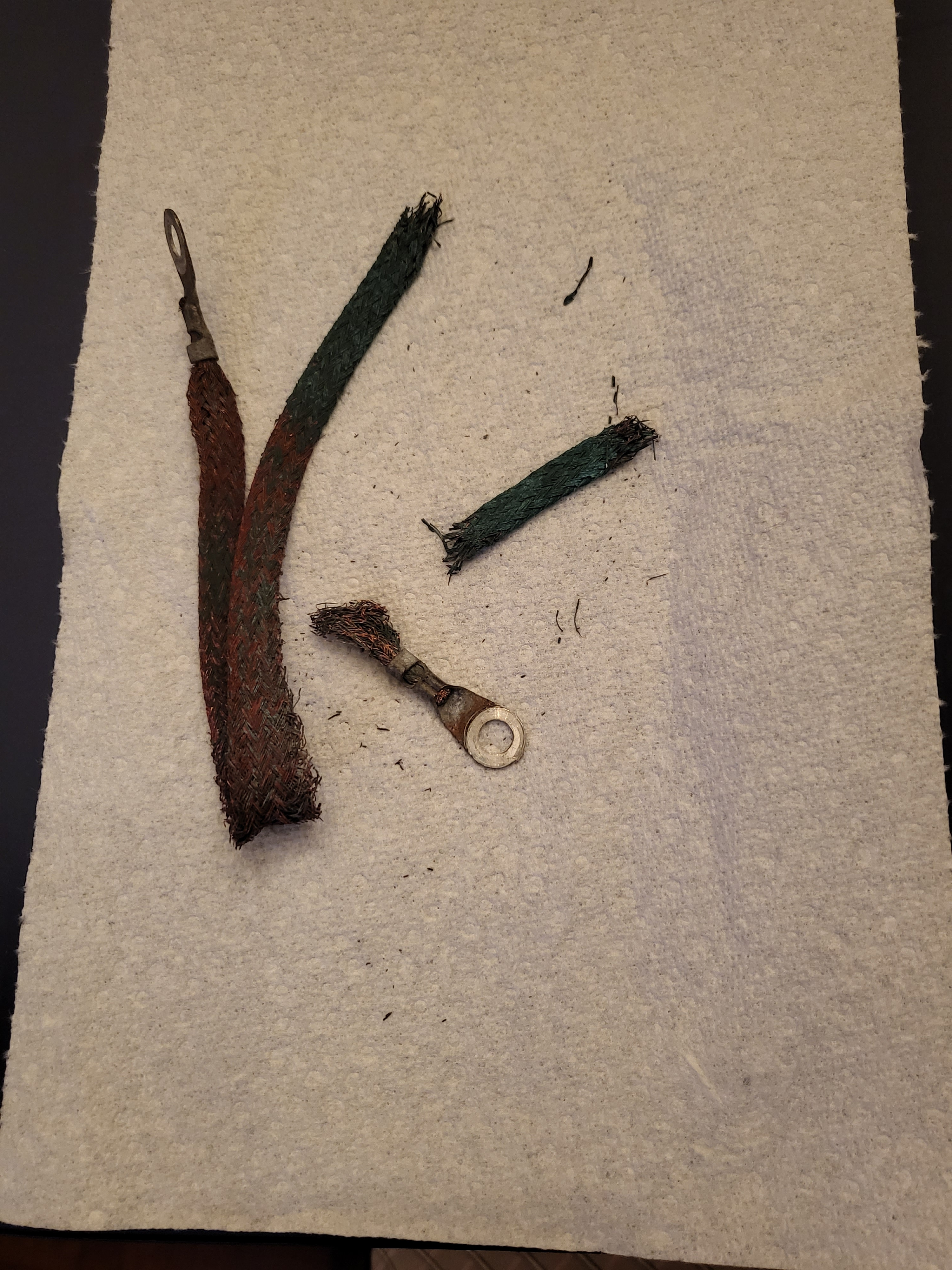

I also went ahead and pulled the gauge cluster again. You see, the sneaky previous owner had pulled some bulbs out so the dic was never illuminated. I replaced all the bulbs with led previously, but the warning triangle wasn't working and I would need this to do the shift adaptation. I pulled the cluster apart and pulled off his carefully cut little piece of electrical tape covering the LEDs. Fortunately with the cluster back in the warning triangle illuminates when you turn the key on. I was worried there would be damage to the led or circuit board.
I felt like I needed to get this job finished up so I was staying out in the garage late. I got so wrapped up in what I was doing that I forgot my own birthday. I got a text from my dad one night around 1 a.m. saying happy birthday. I was just coming in for the night.
Unfortunately while I was working on the subframe job I noticed a few coolant drops on the back of the engine on the right side of the car. I had planned on doing a timing belt and water pump and resealing the top cover in the future and already had all of the parts and the special tools. The previous owner had smeared silicone around the inside of the spark plug welIs and on the outside of the driver's side cam plug in an effort to stop the oil leaks (which didn't work) There was also oil all over the top of the cam cover. I decided to go ahead with that not wanting the water pump to fail completely (knowing my luck). The top cover and cams were very nasty and covered in carbon buildup. I rinsed off the oil residue with brake cleaner and then soaked the parts in oven cleaner for a few hours. I still had carbon to scrape out of the oil passenges and one of the oil holes for a camshaft journal was completely clogged with carbon. I'm guessing this is due to lack of oil changes or the pcv having been bad for awhile. I will probably run an oil "flush" product through the engine based on this and the fact that I changed the oil when I started driving this car and it's already black.
Once I got all of the parts cleaned up I turned to my artistic side and rolled on a nice even coat of anaerobic sealer. For some reason I still had a brand new unopened tube of it and I had a brand new mini foam roller. I guess it was meant to be? New orings for the cover went on and once that was all in place and torqued new cam seals as well. Then I got to work on putting the timing gears and belt on. I watched several videos and read the procedure and followed along with one of the videos just to make sure I got it right. I cranked it around twice by hand and checked the timing marks and all seemed good.
After that I got everything buttoned back up, I noticed that the wires going to the ignition coils were showing bare copper, the wiring was very brittle. I ordered new connectors online and decided to put everything back for now and seal the damaged wires with liquid tape and separate individual bare wires using small zip ties just so they don't come into contact with each other.
I then filled all the fluids I drained and bled the power steering system while the wheels were still off the ground.
I then lowered the car and attempted to start it. It cranked but it sounded a little weird, there was a message in the dic that said "immobilizer see manual" well I don't know anybody named manual so I googled the problem and locked and unlocked the door and flipped the key five times while saying the sacred invocations. The message was gone but the car would still not start. It would crank, then struggle then pop. At that point I decided to check fuel pressure because I had been meaning to anyway and I had replaced the fuel filter during all this as well. It showed a steady 50 psi at the fuel rail. This was last night, it was starting to get late, I hadn't eaten dinner yet, I decided to just put the battery charger on to make sure It wasn't low from me having the door open quite a bit and the car sitting for almost a week. I'm working today, plus I have schoolwork due tonight and tomorrow and also work tomorrow. I will get one day off this week, my daughter is back at daycare and if there is another "close encounter" I may be saying some bad words. Hopefully If I have the timing off, it's not far enough to have bent the valves. I actually have the parts to replace the pcv system so I may go ahead and pull the starter and actually use the crank locking tool (I didn't use it because it seemed pointless) and check the timing again. Maybe the damaged wires blew a fuse, who knows. I know I'll keep trudging along and I'll figure it out, I just wish it wasn't on top of everything else.
