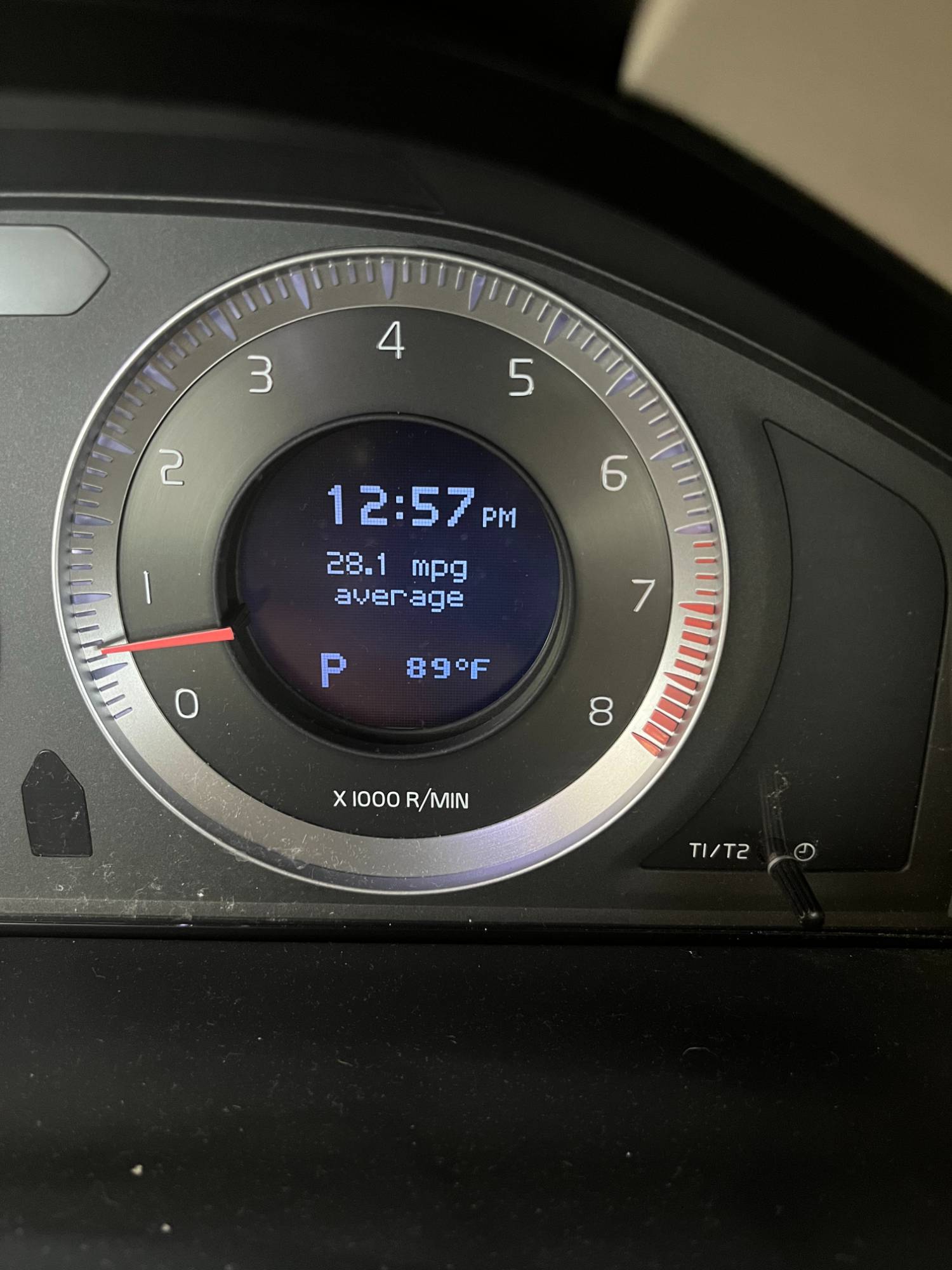

MVS Readers,
I started this thread to show the cost of a ~10 year old P3 Volvo.
The cost that I am tracking is Vehicle cost which I am trying to keep under $10K. I haven't been tracking the cost of Taxes, Registration, Oil changes, Brakes, Tires or Fuel. I did this because these cost vary significantly depending on where you live and I wanted this thread to be useful to people that don't live in my Zip code.
Having said that I am going to share something that my son sent me.
My Son is driving from Northern California to Southern California and he took a picture of the dashboard that I thought you might like to see.
The picture was taken about 190 Miles from my house and it is mostly highway.
Not a bad result for a 12 year old car with 150,000 miles
The EPA highway rating is 27 MPG so lets just say that the S80 can still meet that rating

28 mpg in a big luxury Tank….excellent.

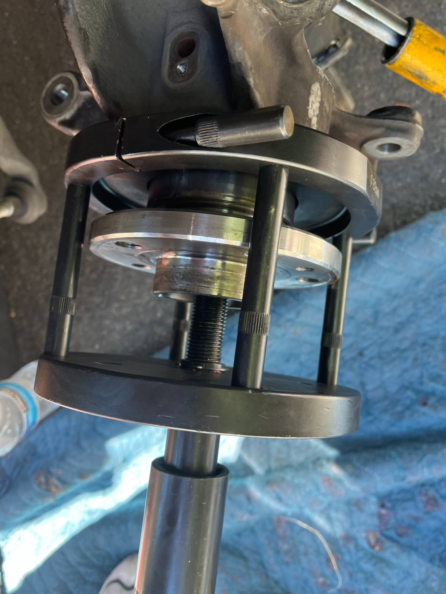

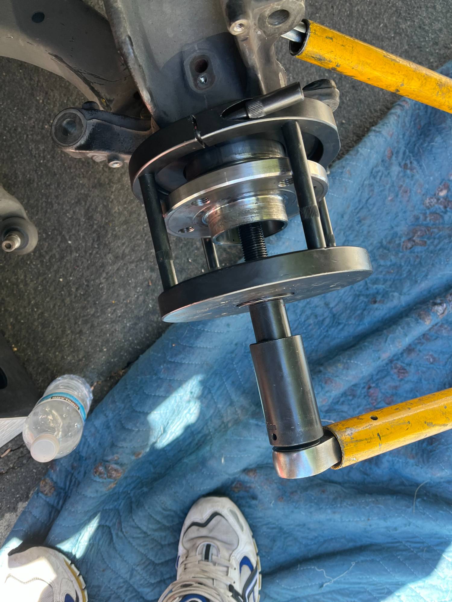

MVS Readers,
I haven't posted for a couple weeks.
I am still fighting the vibration at the front end of my S80.
Here is what I've done.
1. replaced the front right wheel bearing
2. replaced the front left wheel bearing
3. had the wheel balance checked at my trusted tire store (and discussed possible alignment issues with the technicians)
Here is where the story gets convoluted. After replacing the wheel bearing things seem improved but still not as good as it was two years ago. Replacing the bearing is time consuming and I was anticipating a better outcome.
So I went to the tire store to get the balance checked and it wasn't perfect but it didn't take much bring it into specification (this is the same store that balanced these tires originally and I use them for all of my cars). After the minor balance change the vibration seemed about the same.
Note: the front tires are worn strangely, if you run you hand around the tire clockwise it is reasonably smooth however counterclockwise has ridges that catch your hand. The technician at the tire store told me that a small balance problem and/or an alignment problem won't cause that to happen. He indicated that I need Struts/Shocks.
The ride is really nice on the S80 so I have resisted changing the Struts. But I trust the Technician at the Tire store and so you can guess what I recently ordered.
The tool that I bought on EBay to remove the wheel bearing worked well with the exception that I had to install some spacers to press the new bearing in (I used the pins that came in the kit but they were too long so I had to lay them flat instead of inserting in the holes)
For removal the tool worked as expected.
Some pictures.
Note: the old Jack handles and the 1/2 craftsman ratchet that I very rarely use (it is 30 years old)
Here is the new bearing installed
Take care
Paul
PS the front brake rotors we getting rather worn out so I decide to replace them while I was in there. Amazon will lower the price of their inventory if it doesn't sell so I got two extremely high quality rotors for an amazing price. List price is $155 for the pair and I paid $29. EBC Brakes RK1500 RK.
