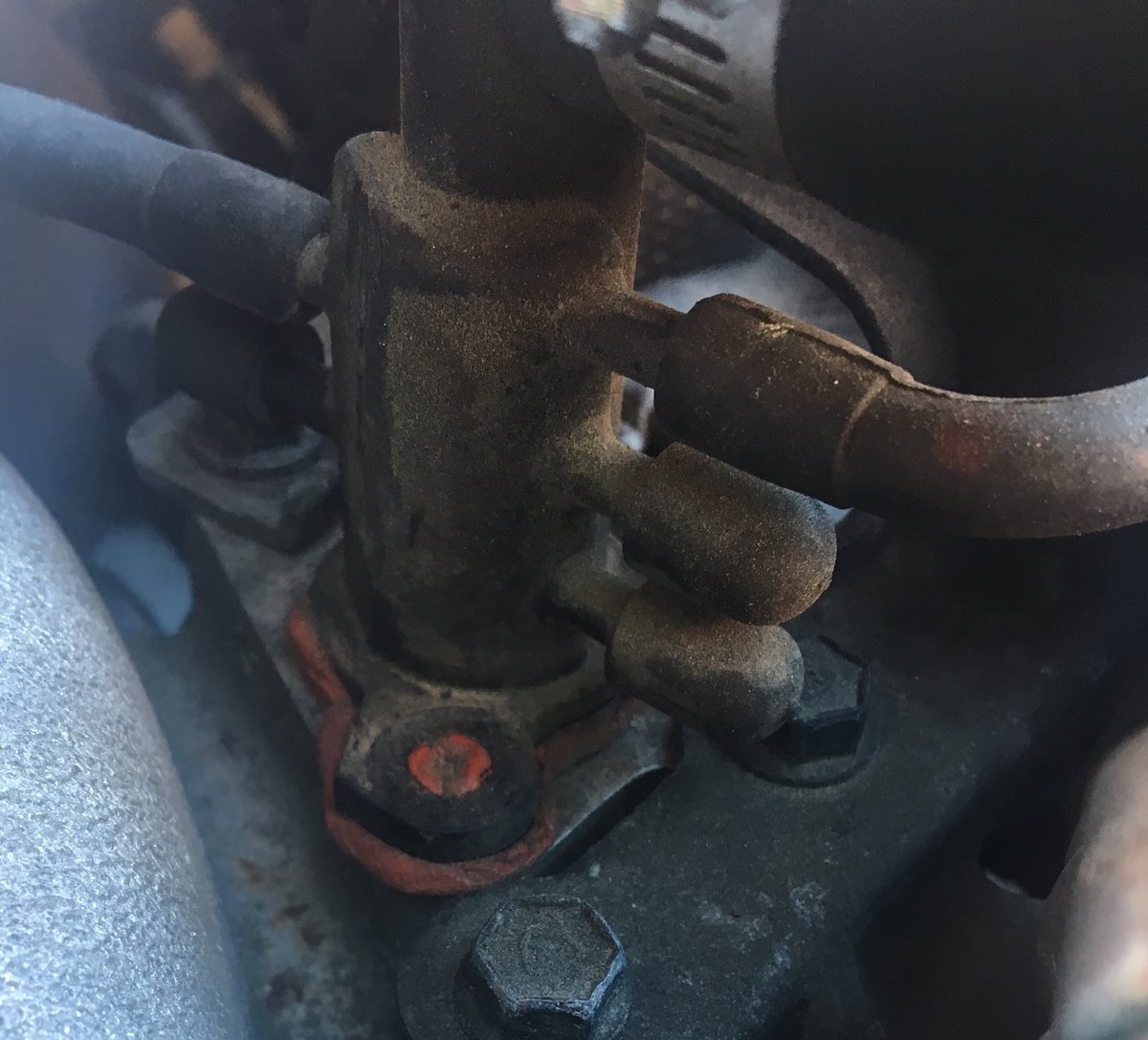

I may have found the boost leak on the R today... turns out the PTC is not totally seated in the intake elbow. I’m gonna have to see if I can get one at the junkyard tomorrow.
It seems odd to me that it would be an issue being that it’s before the turbo, but I guess it makes sense.

That grommet at the base of the PTC is still available from Volvo for a couple bucks, worth it for a car like yours that gets serious work and a tune. I posted the part number in that recent PTC thread here.

I'll take a look, I wasn't sure if they still made that part separately. Thanks!erikv11 wrote: 27 Apr 2019, 22:23 That grommet at the base of the PTC is still available from Volvo for a couple bucks, worth it for a car like yours that gets serious work and a tune. I posted the part number in that recent PTC thread here.
It would definitely make sense, being that it's post-MAF. The car has definitely been using a lot of gas too, so I have a feeling this has been a problem.tardcart wrote: 28 Apr 2019, 05:34 Gromet would cause MASS meter problems due to enter non meter air.
