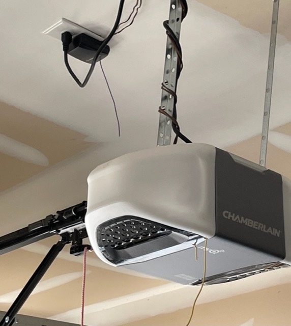

Picked up a sun visor w/ the garage Homelink I/F. It works great after I got schooled on the technology shift in garage door openers in the early 2010’s. My garage door opener is the new kind w/ Security + 2.0. The ones in the my car age range are the old style and will not program or looks like it programs but won’t communicate. I had to get a Homelink compatibility bridge. I plugged the bridge into the outlet above the door opener, programmed the Volvo visor button to the bridge remote, then pushed the learn button on the garage door opener, pushed the visor button and presto, the visor button works. Pick-a-part visor $12, bridge $35. Lol

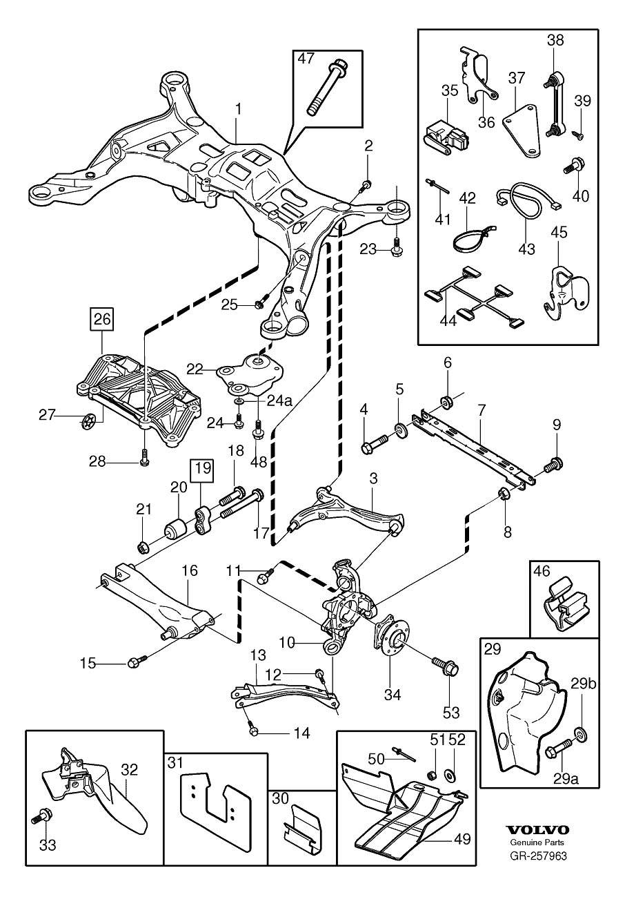

So, I had a knock in the right hand rear suspension on my 04 V70 R going over potholes. I took the wheel off and checked the bushings and it looks like the brushing at the wheel knuckle was torn or just missing some rubber. The dealership wanted 90$ plus labor to replace it. I went to home Depot yesterday and bought some locktite construction adhesive and filled it in. Let it dry for 24 hours. I just got back from a test drive and the knock is gone. In the diagram it would be #10. MDK
