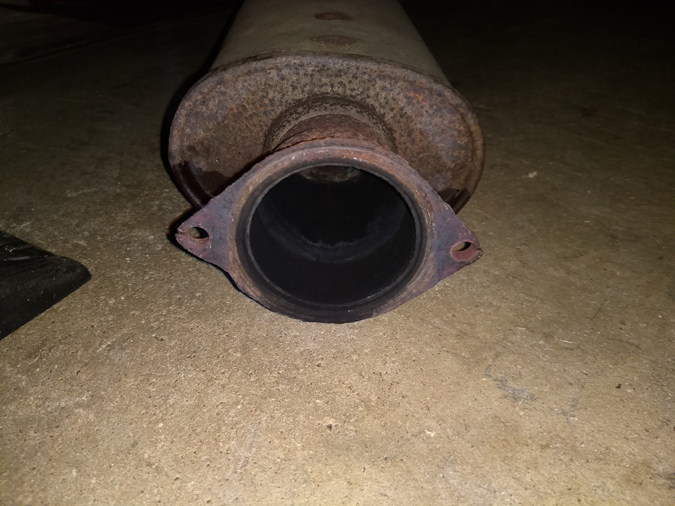

fought with front flex hoses, got the flare nut off easily but the hose doesn't want to let go of the bracket, so I removed bracket with the hose and beat it out in the vice, that'll teach it.
Next is the exhaust gasket after the cat, at least its cheap.

jonesg wrote: 09 Jun 2022, 17:45 Next is the exhaust gasket after the cat, at least its cheap.
If you bolts are rusted beyond having threads, you need Dremel to cut two slots by the bolts, then knock the bolt/remnants out. Use new bolts, apparently.

vtl wrote: 09 Jun 2022, 18:16
Yeh It looks like it will need destructive effort to remove the old bolts.

jonesg wrote: 09 Jun 2022, 21:57 Yeh It looks like it will need destructive effort to remove the old bolts.
Actually, had to cut catback.
