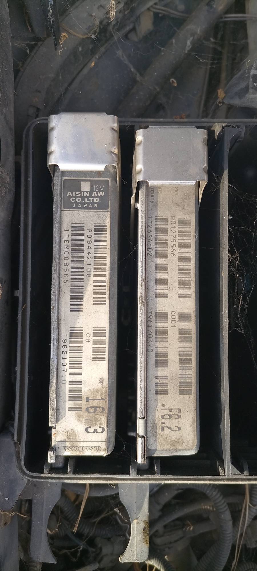

Doesn't matter as long as it's correct for your car.
Usually the "T" number is matching with production year of a car.
This picture is from a parts car...'96 2.5 20v:

Misha, thanks for that note on the date code. I was looking in parts the other day and had a 1998 and a 1999 TCU and was wondering how to tell them apart, now I know!
