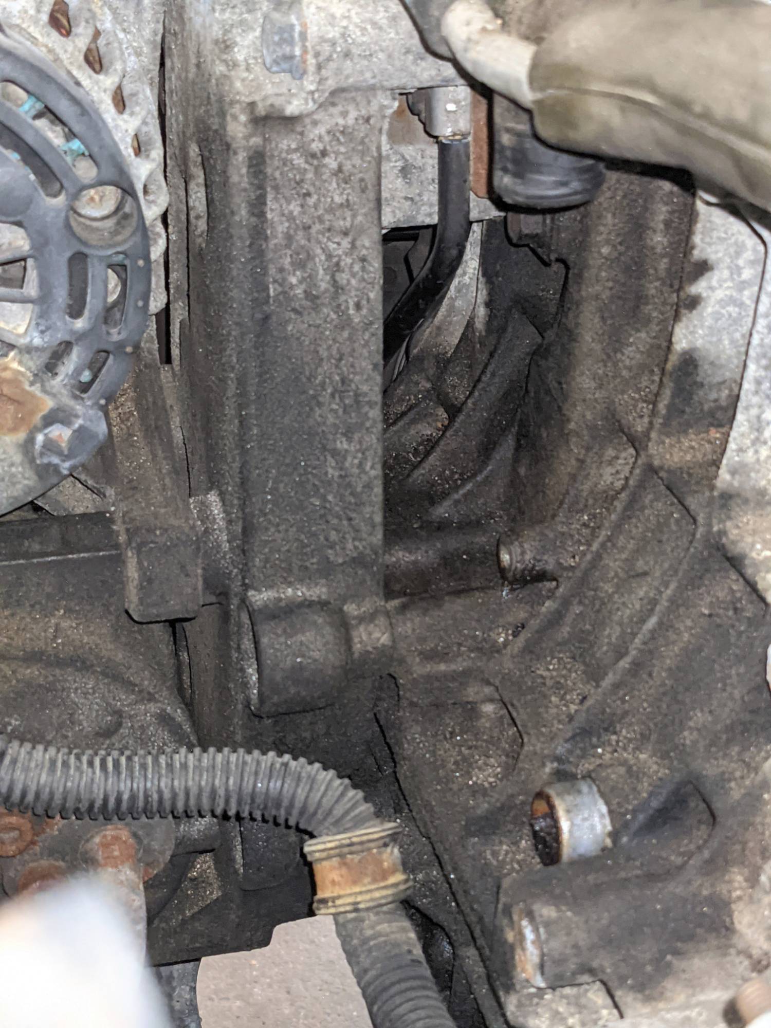

I'm assuming the PCV system is off for a service in that pic?

Yes, the PCV was off for that engine picture. I was surprised to see so much oil caked under cylinder 1, the alternator bracket, and the A/C compressor. The PCV was barely clogged so it only contributed a little. Behind the belts is clean. When I removed the VVT solenoid, I saw evidence of oil leaking from it, caked on the cam pulley.

I finally got to check the intake manifold bolts and they were all torqued to spec. There is wet black fluid down the front of the block beneath cylinder 1 while all other areas around the manifold look clean. This matches what I saw when I did the PCV job, finding black staining below cylinder 1 and, oddly, behind the alternator bracket. Old pictures from 8/21 attached.
It is suspicious that cylinder 1 is reporting the misfire and there's oil leaking all around cylinder 1. What could be causing this leak?
I never did track down what caused that staining so perhaps it's still leaking. Maybe I did something wrong with the PCV install causing a leak. I still hear the chirping of air escaping which I assume is from the fuel injector o-rings not being lubricated upon reinstall.
