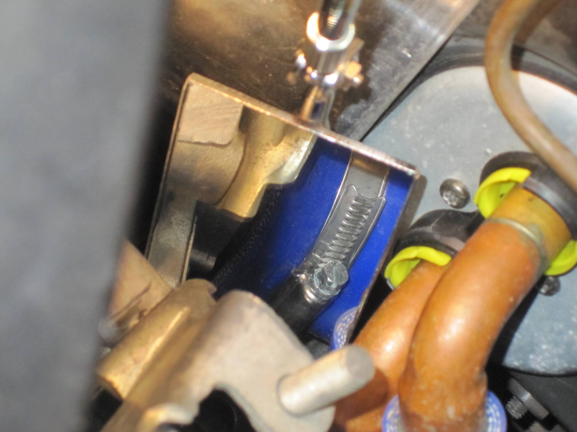

Today, I removed the air/turbo inlet tube, aka: "snorkel" (#9186200), cleaned it with carb cleaner, and noticed the lip that fastens at the turbo was very thin with a slight deformity which was made by the hose clamp over the years. However, the deformity did not look like it would cause a leak. I sealed the snorkel with rubber gloves at each end, taped the nipples closed, and introduced smoke through the PTC. The leak was readily apparent where I noted the deformity. I tried to use a hose clamp on the rubber glove, but it still leaked. I think this was the source of the P0455.
I thought it would be an easy fix to simply replace it, called around and found it's no longer available, now out of production. I called a Volvo-Saab dismantler that I frequently use, but they're closed today. Due to time issues, I decided to order a new silicone part from IPDUSA, $286.99 plus tax, which will be delivered next week.
Once I put everything back together, under the hood, I'm thinking of smoke testing at the charcoal canister to see if the lines that go back to the gas tank, including the tank and filler neck are leak free. I don't think the smoke test I did in the engine compartment tested that part of the system.

Glad you found the source of the leak. Yea, those plastic snorkels do deform/crack over time. I installed one of those IPD silicone turbo inlet hoses last year. Do make sure it's clamped on tight to the turbo, or else it will come off over time, and cause your call to stall. Ask me how I know. : )
Shout out to abscate, who said I had a loose induction hose creating the stall in this thread: viewtopic.php?t=101157
I just tightened it up, smoke tested, and now no leaks. The hose looks a little weird clamped on the turbo, because the hose is a bit wider than my stock turbo. So the hose kind of "bows out" between the clamp and the turbo.
I'll be curious to see how yours works out. Post some photos if you can.
Hopefully it stays on now.

One more tip, now that I think of it. I had a bit of a time getting the IPD hose around my MAF. A heat gun softened it up nicely, so as to help me get the hose on.
Also, you'll have to dremel off part of your PTC to fit it into the IPD hose, but you perhaps already knew that.
