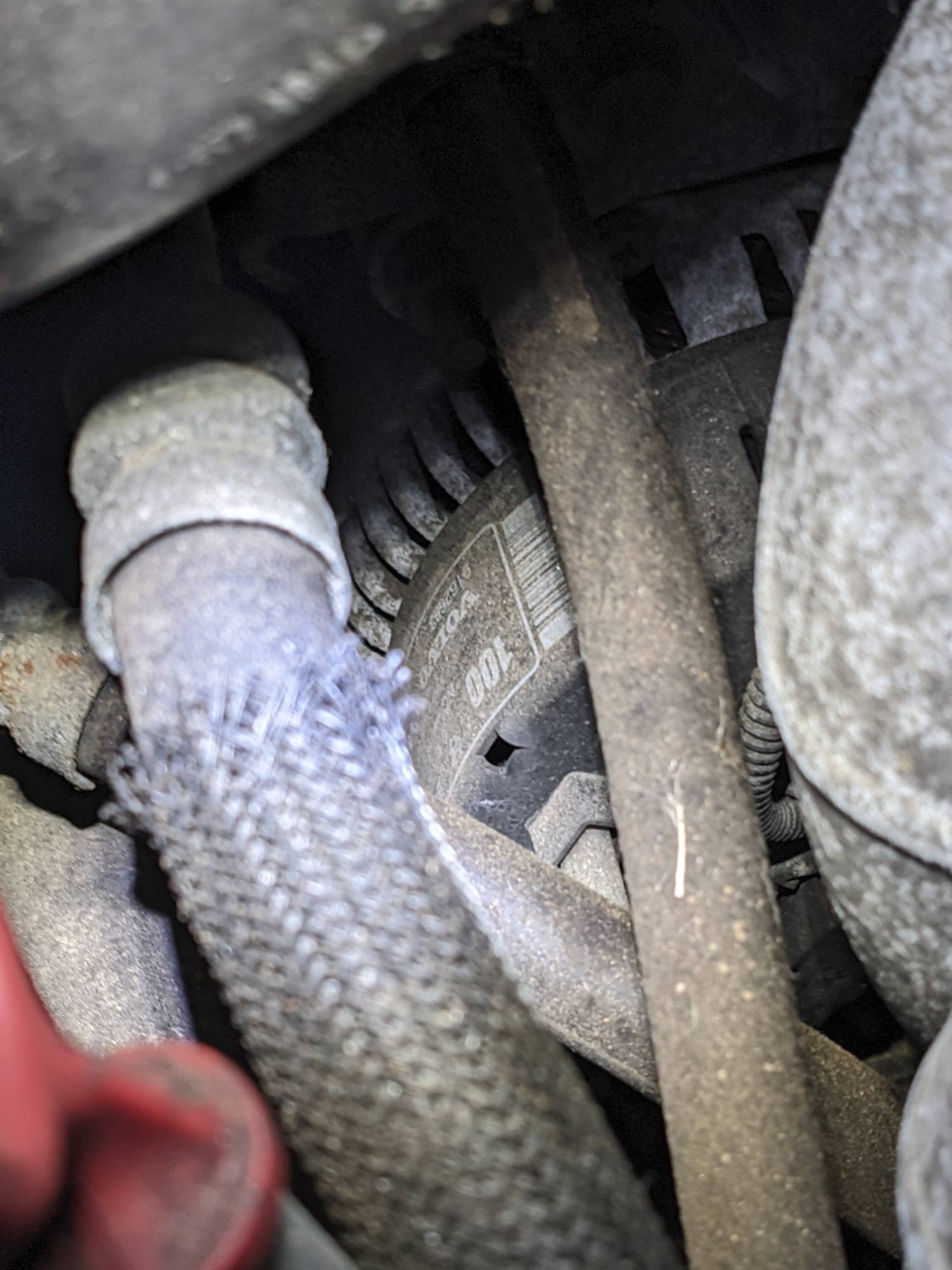

Yes, this 1998 appears to have a 100 amp alternator, part # 9162683. I'm kind of surprised this one is dead at 178k miles. I believe my V70 had its original at 275k, though I suspected it was weak. I wonder if I'm misdiagnosing it. I spent a few hours of my Cyber Monday shopping learning about voltage drop tests and more, then went back to ordering parts to save money.
rrres wrote: 04 Dec 2022, 20:14 Do you have an alternator rebuilder shop in your area? They might have a replacement in stock or they can rebuild your existing.
This is a good idea. It appears that there are a few alternator and electronics rebuilding shops near me. I'll call and get a quote to rebuild. I wonder which work I should trust more, Bosch rebuild or some local shop? How do rebuilders get the voltage regulators which consumers can't get?

1998 100A alternator
