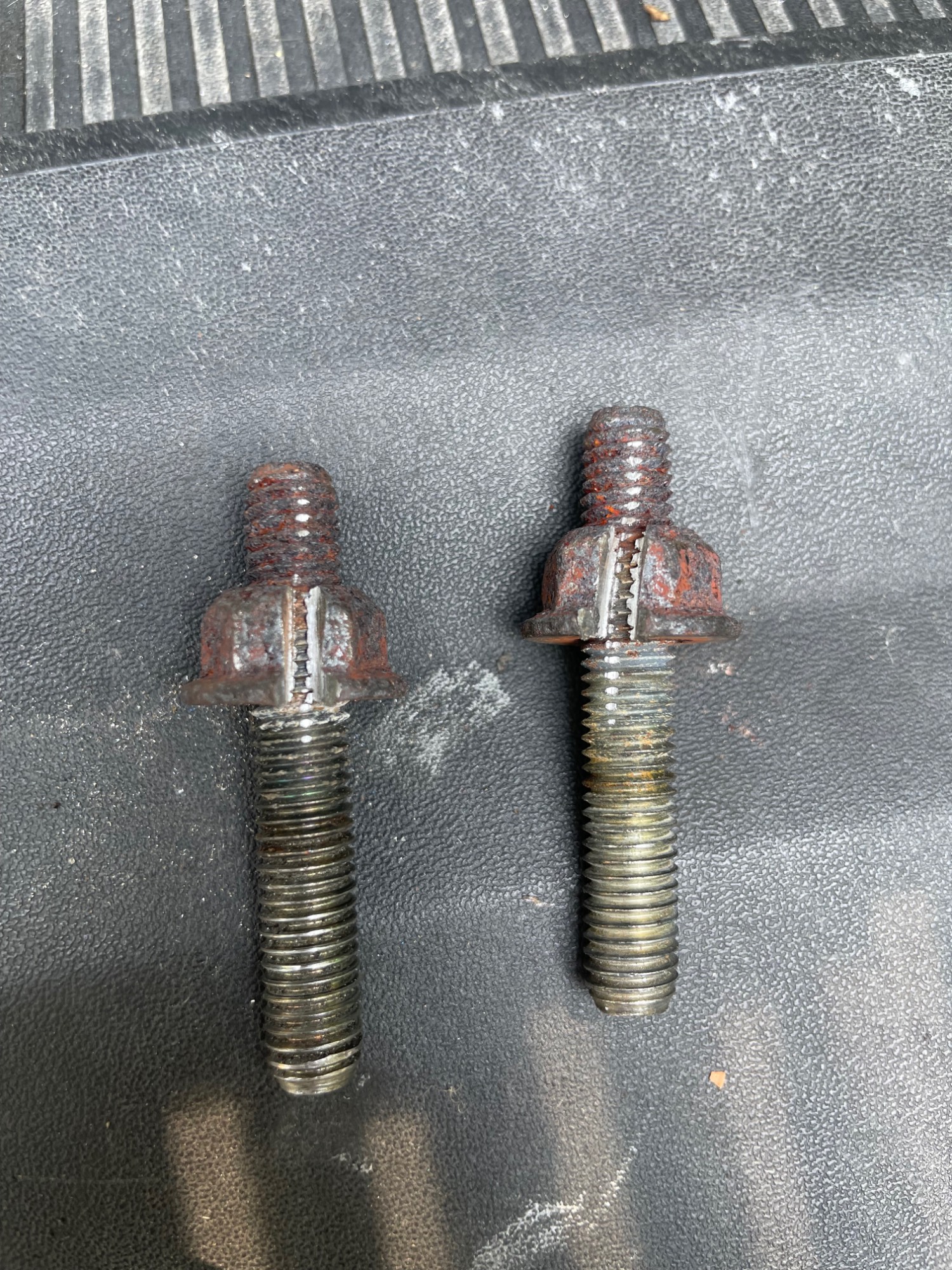

I’m into my fifth valve job on the p80 chassis, all from crusty Northeast cars and never had a broken exhaust stud. I suspect good choice of steel from Bulten is the difference here. I generally Dremel and split any nut that stays on the stud , and use all new nuts always, and replace any marginal studs
Dremel the slot, bang it once with chisel, and it’s off. 40 seconds with Dremel.
